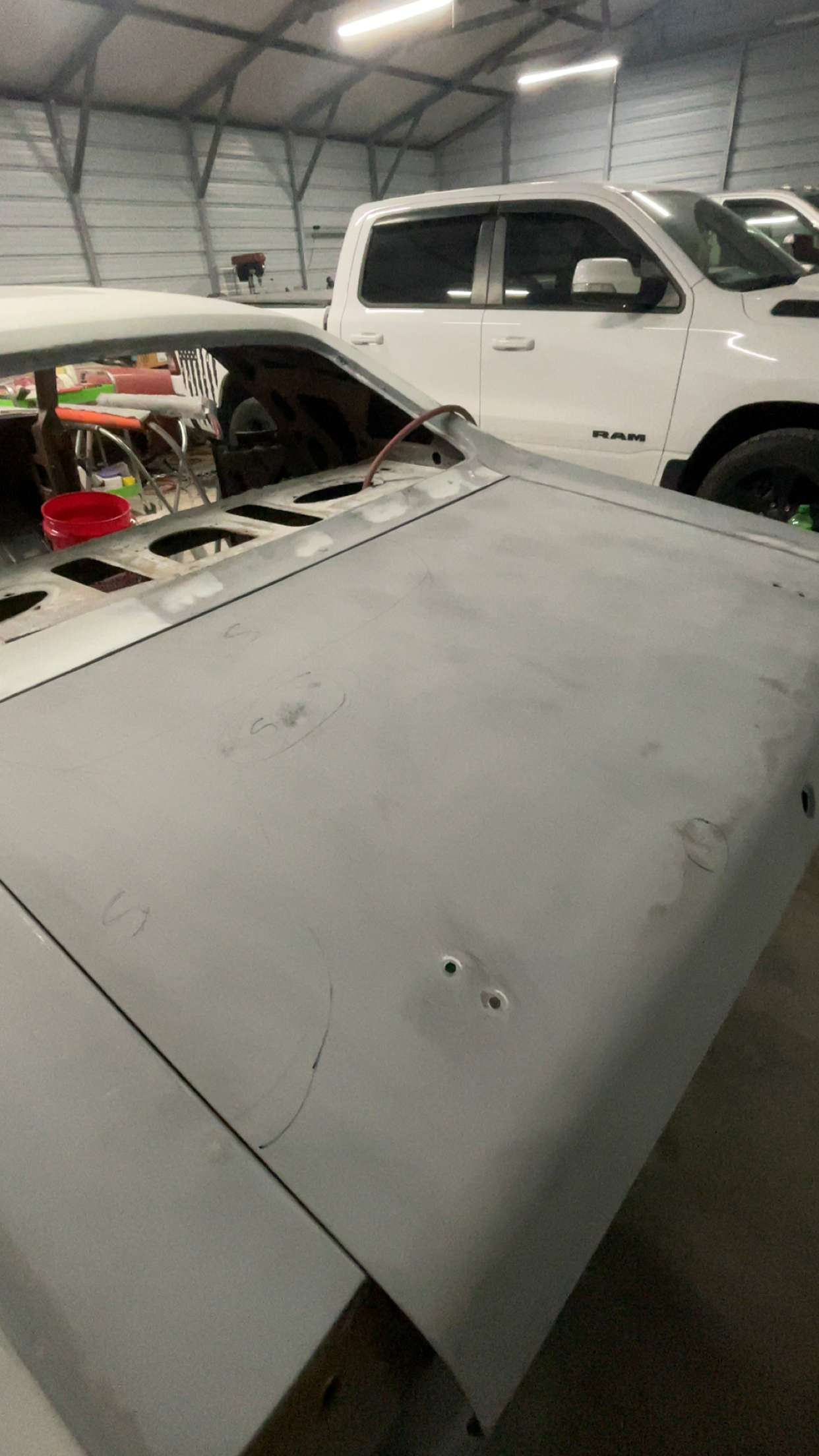

For a 1970? the cut outs are under all of deck lids for the reinforcing brackets. 1969 wings have a different spacing than 1970.
Sorry, yes its a 70. Orig trunk lid was so rusted. I need to know the measurements from the side edge & the front of the lid to the the first hole.
Thanks, Bill

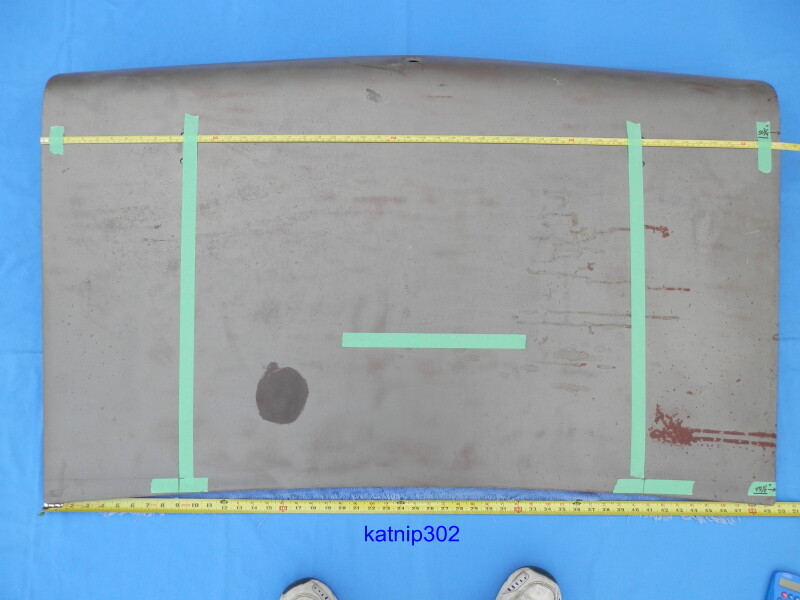

I can measure mine when I get back to work on Monday. I have a 1970 Eliminator (not a clone).
Thanks !

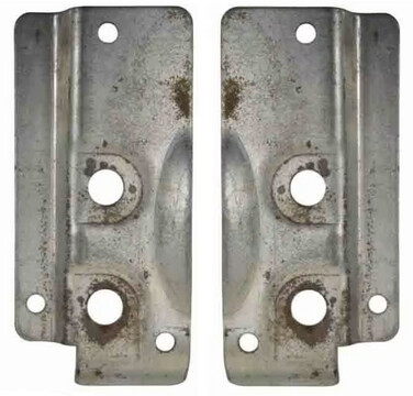

Buy the reinforcement brackets. And put them in place. Then drill up through the bolt holes.
Hi PolarBear: You mention reinforcement brackets in your post. Could you specify what you mean, and where you got them ? Are these the 1970 mounting plates:
( images from WCCC and Dead Nuts On ).
If these are the brackets you are referring to, then they only work with the 1970 trunk lid ( with the cut outs on the underside ).
Bottom pic is for a Mustang I believe. Totally different bracket
The top ones. They fit perfectly in my 70. You can get a set at wccc or npd. My cougar is at the shop getting wet sanded or i would take a photo for you.

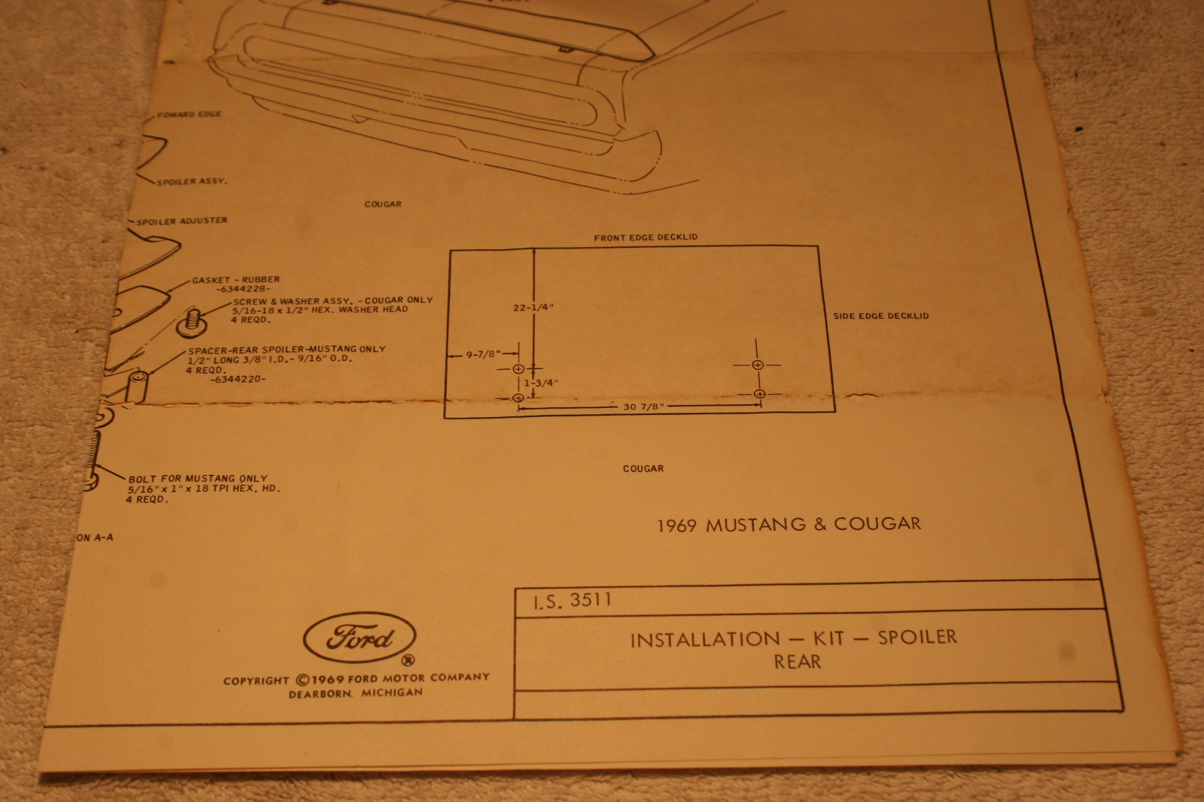

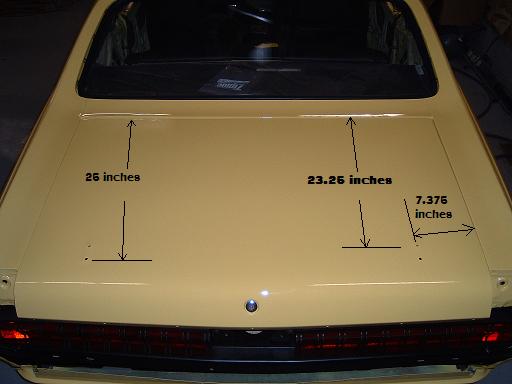

Sorry, I just saw this post! Here is some info I have from my files…
1969 Rear Spoiler
1970 Rear Spoiler
