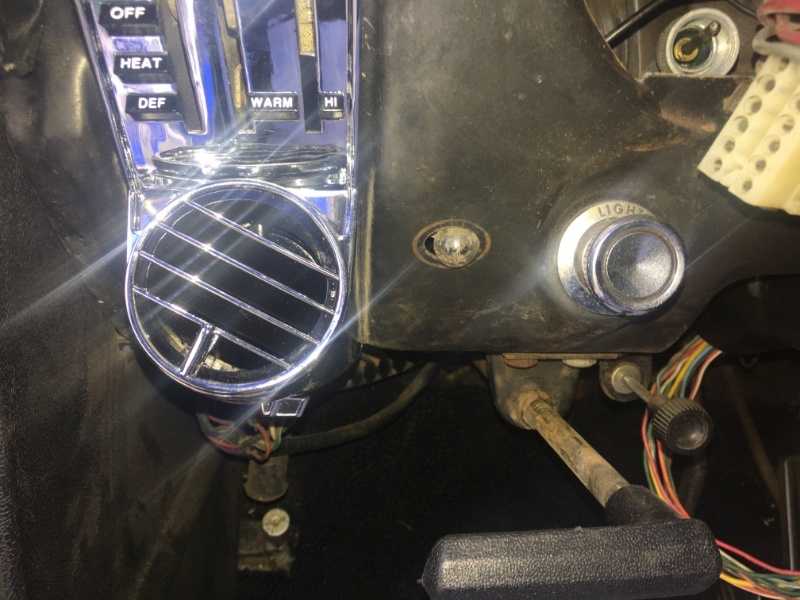

I have a 67 base model Cougar, with factory A/C. There is a hole in my lower dash between the e-brake handle and the left of the rest of the dashboard.
My usual sources of information have no info on what this light looks like, or Ford part numbers for bezel, or anything else. It is clear a plastic bezel has to push through the metal dash lower panel, then the bulb socket clips into it.
Does anyone have information about the particular indicator light. I am told it is rare.

I will be looking to install one of these, and need to know where to locate the hole and where wiring goes.

Thanks Richard. The wiring should be easy enough to figure. I will have to fabricate somewhat of a harness. Missing the half of the fuse holder and yellow bullet that goes to the switch. I will just need to find out hole location like ‘ls4wires’ mentions above. Or I may rather than drill a hole in my dash just make a bracket to place it under the dash by the brake handle. I believe I’ve seen the Mustang use that setup?

When I removed the light it was near the left knee very low on the dash, exact location I don’t recall, someone must have a picture to post

I need to find a picture of the e-brake light, or better yet a source for the lens or bezel.
