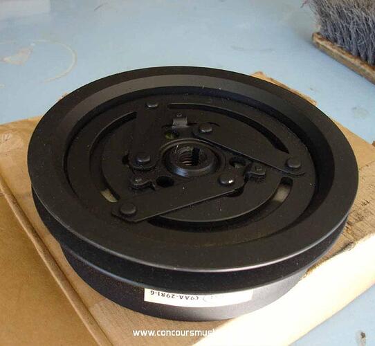

The Ac compressor pulley/clutch finish would depend on what type of AC pump you were using
Here is how one version was painted - notice the shadow from the bands on the inner surfaces
Hope this helps
I did not know that the ac pulley was black in 69. I like that as I have struggled to keep mine looking nice.
Will depend on the type of pump and clutch your car originally came with
