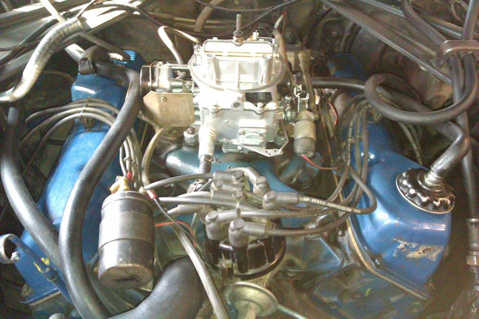

Hi all,
Can anyone tell me what decal is supposed to be on the drivers side valve cover at the front? There was one there at one point in time and I can’t find a picture that has on in that location.
I really appreciate your help.
Second question, Is it better to leave the original decals, even if they are a little worn? Or is it better to replace them?
Thanks
Jennifer
That would be the engine code decal. I would send you a picture of mine but it’s hidden behind the air conditioning compressor. Here’s a link with some examples:
http://www2.cougarpartscatalog.com/encode.html

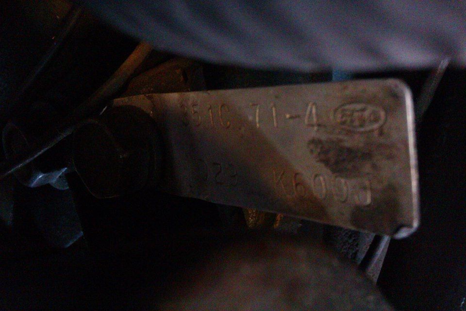

Also, the engine code would be on the “Engine Tag”. Jennifer, I clicked on your picture to enlarge it and it looks like there might be an “Engine Tag” underneath of the coil. Here’s a link to a pic of an engine tag, the engine code is on the lower right corner of the tag http://www.martiauto.com/itemselection.cfm?item=TAGE-64&selecteditems=yes. If it turns out that is the engine tag under the coil, post the info on the tag and someone will decode it for you. :slight_smile: John

Here is a pic of the engine tag, I hope you can read it. You are right, it was under the coil. if I need to get a better shot of it I can take the coil off.

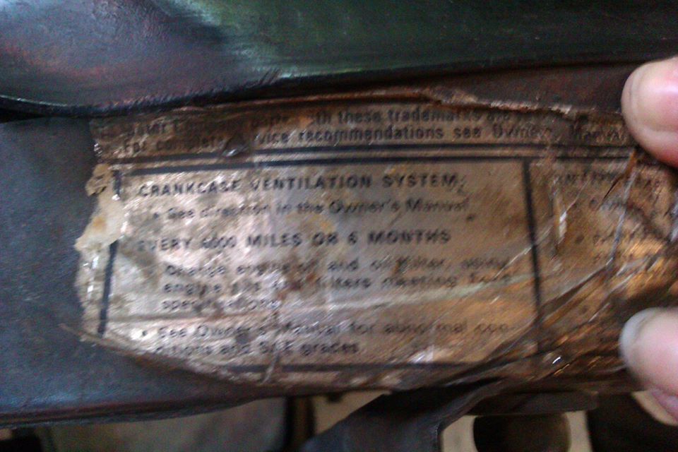

This sticker (or what is left of it) is on the radiator shroud. Everything I have been able to find out about the sticker puts it in lots of other places from the valve cover to the air cleaner. In the NPD book I’m thinking it is the service specs decal (D-43) but in the NPD book they have it on the LH shock tower.
So is it in the right place for my car? How do I find out? I have the tag book but it also is not specific.
Jennifer
I’m no 71 expert but on 351C engines, I’ve always seen that sticker on the outboard front side of the drivers valve cover. There is a flat spot there that is perfect for the sticker.

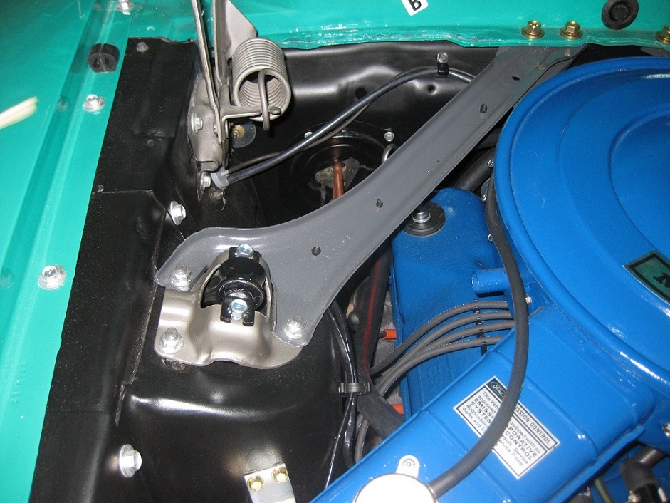

Hey Jen, here’s a shot of the decal on the drivers side valve cover on my 73. Not sure if its correct but that’s what is there. I don’t have the decal you show on the radiator shroud or either shock tower and nothing under the coil. Sorry its all I found :smoke:

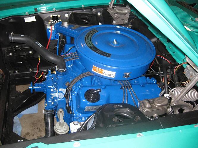

And here’s a pic of the sticker on my 70 351C 4V. So now you have a pic of a 70 and a 73 and I don’t know if either is correct for a 71.
Geesh Jeff, if I had know you were gonna step back back and show that clean engine compartment I would have cleaned up a bit :poke: Jen, on the passenger side valve cover, front facing the radiator I have a decal similar to the one on the WCCC site :smoke:
