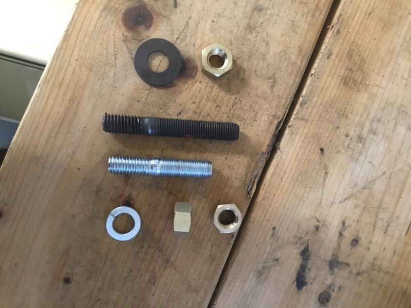

It turns out the donut gaskets were intact. One of the bolts (passenger side lower) worked it’s way free and fell out. The top bolt was also loose- but I was lucky/cursed to recover it and the washer/nut.
I ordered 600-1155 from NAPA, next day in store, confirmed fit… 3 bolts, 3 fine nuts, 3 coarse nuts & 3 lock washers. Here is the difference in what was in the car and what I got. (New =silver bolt and below)
The new nuts are both fine and coarse threads…the coarse end of the bolt goes into the manifold, the fine matches up with the fine nut. I see no use for the coarse nut.
The black original bolt is 3” long, the silver replacement is 2.25 inches long. Summit recommends the exact same kit ( https://www.summitracing.com/parts/RNB-03099/applications/year/1969/make/mercury/model/cougar/engine-size/5-8l-351/engine-vin-code/h )
The difference in length is not letting me put the accompanying lock washer on. The flange barely lets the nut begin to thread.
I have a thought that by using the coarse nut is to be used to “lengthen” the exposed bolt, sacrificing depth into the manifold…but that seems wrong.
