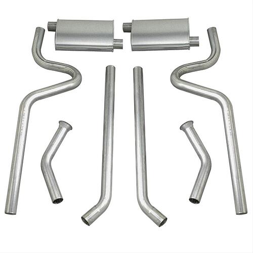

It’s hard to beat this setup:
Included: Free Shipping!
Get the H pipe from Don and then you can do it all at home with a hack saw and wrenches.
You can just tell by the pics there is no way the summit kit will not fit without mods.

If anyone else is interested I’ve decided to go with the kit Royce linked with the exception of different mufflers. Then get the header pipe like don linked.
The kit includes offset inlet and outlet mufflers and I believe that might cause a fitment issue. It looks like all the stock dual exhaust is an offset inlet with center outlet. I can get thrush or summit mufflers cheap enough too so I think it’s worth swapping them out for something with better fitment. I can sell the others for a few bucks to offset the extra cost. Should be about to be in it 350ish or so which is cheaper then any local exhaust shop I’vee called.

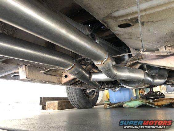

I wanted to update this incase anyone else comes along with the same questions. I finally got around to installing the exhaust parts I have acquired. I did run into some challenges that I am still working on, the biggest being the tailpipes. The driver side fits fine, not so much on the passenger side however. The pipe is bent wrong and there is no real way to get it on the car straight and have it hit the muffler reasonably. I called summit and they sent out a replacement no charge but I fear its bent in the same manner and Ill have the same issue with it so Ill have to figure out how to bend it to fit my needs. I did not expect it to just bolt on without fitment so Im not disappointed, actually surprised summit replaced that pipe without question or return of the old part.
I did find the summit kit did have the correct offset mufflers needed unlike what was mentioned in the reviews. You would not need to buy different mufflers for the correct offset unless you wanted something different(I wanted something a little better) Overall its actually really nice minus the tailpipe issue and this kit could be used to make your own exhaust with headers pretty easy as well, Ill see what I can come up with to get it on the car. For now I just stuck some turn downs on it for the time being. All the tubes are long enough to fit a cougar so its not just a mustang kit.
The H-pipe came from NPD, it fits ok but was not overly happy with how it sat in the car, its not straight. I was able to adjust it some and tweek the pipes to make it better but I dont know if I would be satisfied if I was planning to keep it that way permanently. Not sure if the one WCCC sells is better or the same manufacture, could also be because its oversized 2.25" compared to stock. Shipping from WCCC to me on just the h-pipe was not cheap so I chose the NPD option since I got it on free shipping. Just something to be aware off if your planning to go stockish exhaust. Ill have headers at some point so this h-pipe is only a temporary setup.
ignore the not so clean belly of the car. I have not taken on any referb work down there yet
