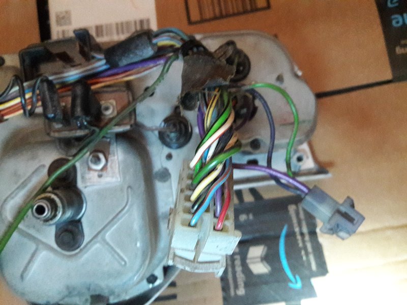

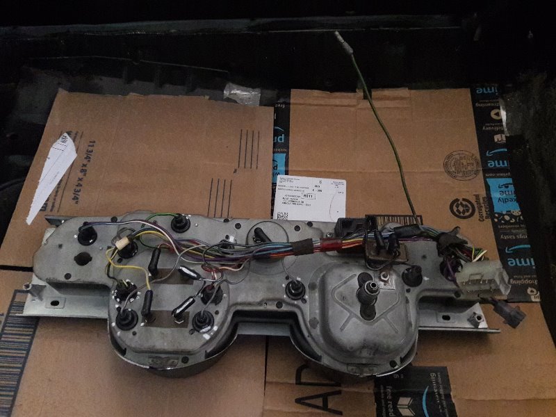

Okay, here we go… I have a 1968 Standard Mercury Cougar. I pulled the dash out for painting and to replace the bulbs. What I found in the harness is an odd single GREEN wire. It was not attached to anything when I pulled the cluster. Okay, so what is it for? Was it meant for use for some kind of extra option that my car didn’t get? Maybe it’s for a seat belt light that my car did not come with. If anybody knows, I appreciate your help.

Am I right that this wire has a male bullet on it? That’s unusual, as that means it is for something that this wire is receiving a signal (remember, only female connectors are energized when hot!). So something on the dash cluster would be providing a signal to the underdash harness…most unusual. Can you find its position on the dash cluster connector? That will help folks like me to track it down in the schematics.
Yes, it does have a male bullet on the end. I will check on the cluster connector and get back with you.
It looks like is 3rd on the left from the top/bottom. Depending on how you look at it. There is a green/black on the 2nd position and white/yellow on the 4th position. Something else to consider is that the wiring harness or even the the dash cluster itself may be from a 67 Cougar. A good portion of the interior is from a 67. Door panels, seats, center console, etc. There is no telling at this point. Unable to submit photo for some reason but you have the info that you need. Thanks.
That green wire is suppose to be connected to a a female plug bolted to the back of the speedometer housing as a ground
Now we’re getting somewhere! As you can see in my photo there is no female ground on the back of my speedometer. Would you happen to have a photo of where it is supposed to be? Maybe I can fabricate something to use.
You are missing the copper female plug that should be bolted under the nut holding the voltage reg on, you could cut the plug off and crimp on a ring terminal and do it that way.
The female ‘connector’ is attached to the cluster on the same stud as the IVR.

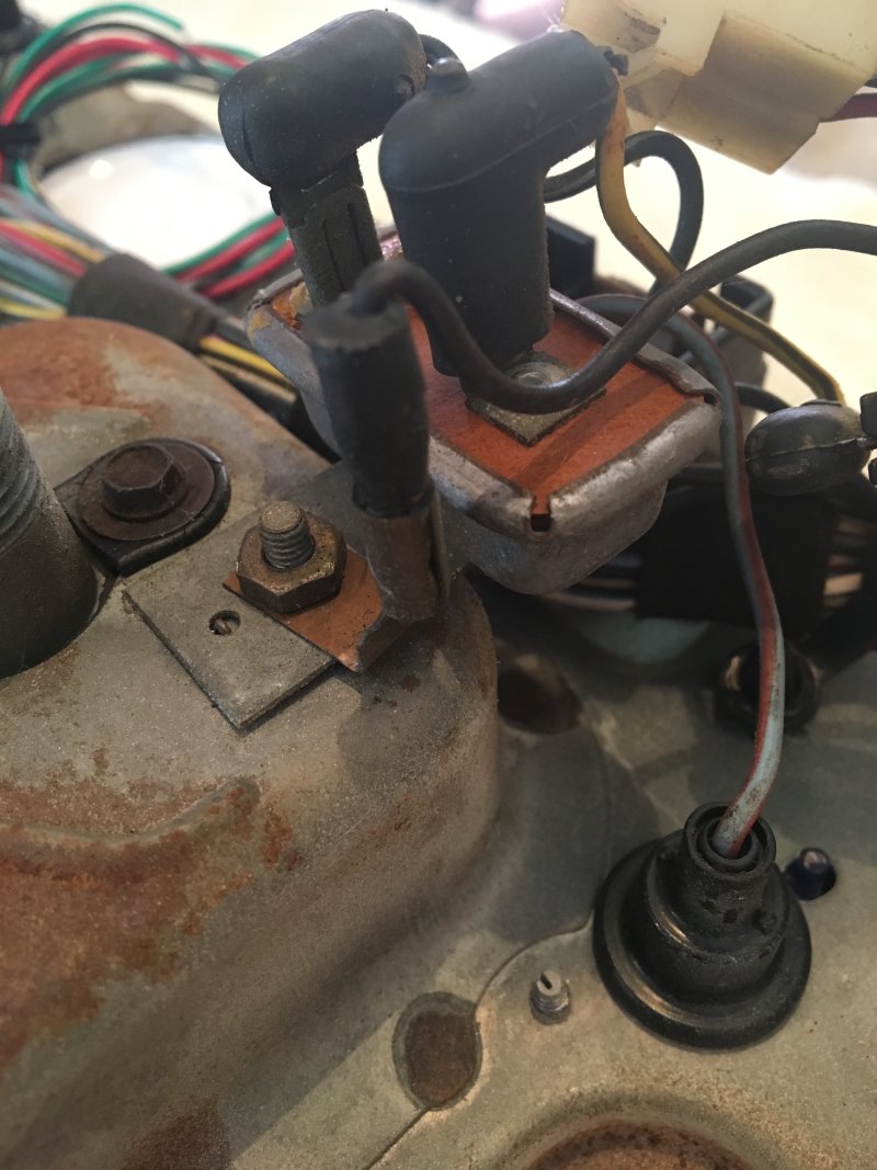

Here is a picture of the wire and copper connector.
If you need that piece PM me and I can mail one to you.
After looking closer at your picture you can see where the copper plug has been broken off and a piece is still under the nut,
You are absolutely correct! Part of the original piece remains. Thanks guys for so much help! TheRktmn is going to set me up with the piece that I need. Problem solved!

That’s what I got as well. What threw me off was the color of the wire, as it should be black and not green. Going back to the original picture of the back of the dash cluster, there is no connection to the grounding lug of the IVR. I have one or two of those lugs as well if Rktmn can’t find his.

Here is a picture of the plug on the back of my 68 dash.
Thanks! Mine looks like that now. What are the chances of the IVR going bad? I still have no dash lights. I replaced the fuse, headlight switch and all the dash bulbs. I’m puzzled. :wall:
