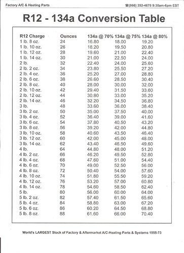

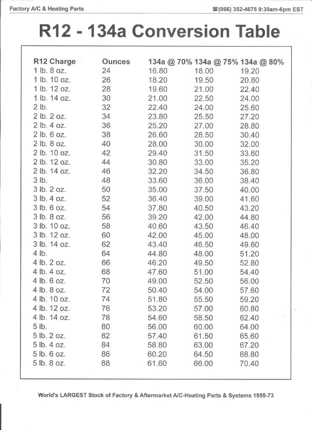

With that said, the following table shows the amount of R134a to replace a given amount of R12.

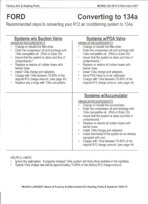

The second page gives instructions about the compatible oil and such.
My 1968 with Tecumseh compressor and stock 1968 system has been cooling well with 27 to 28 ounces, or 0.78 kg, of R134a. My mechanic friend and I didn’t want to overfill and stopped when we got a nice, cold output.
The placard on the compressor for 1967 - 1970 says 1 3/4 pounds of R12 refrigerant. That’s what I use and it seems to be plenty. I think I would convert 1 3/4 to R134 using the table to avoid overcharging / locking up the compressor.

Not knowing exactly what system you bought, it’s hard to say. Most aftermarket compressors come pre-filled with oil, in fact I have never seen one that did not. However, that is just for the compressor, and the compressor manufacturer doesn’t know what sort of system the rest of the car will have. In your case I would call the manufacturer of your system and ask them for the total oil recommendation. You would then drain your compressor of the factory fill since you don’t know how much the manufacturer added, and add in the specified system amount. “Most” systems take between 4-6 oz of oil, and when you change out a major component like a dryer or condenser it’s recommended that you add an oz of oil back in. Also make sure it’s r134 compatible oil. If your system is entirely new and all traces of the r12 mineral oil are gone, you can use a PAG oil.
