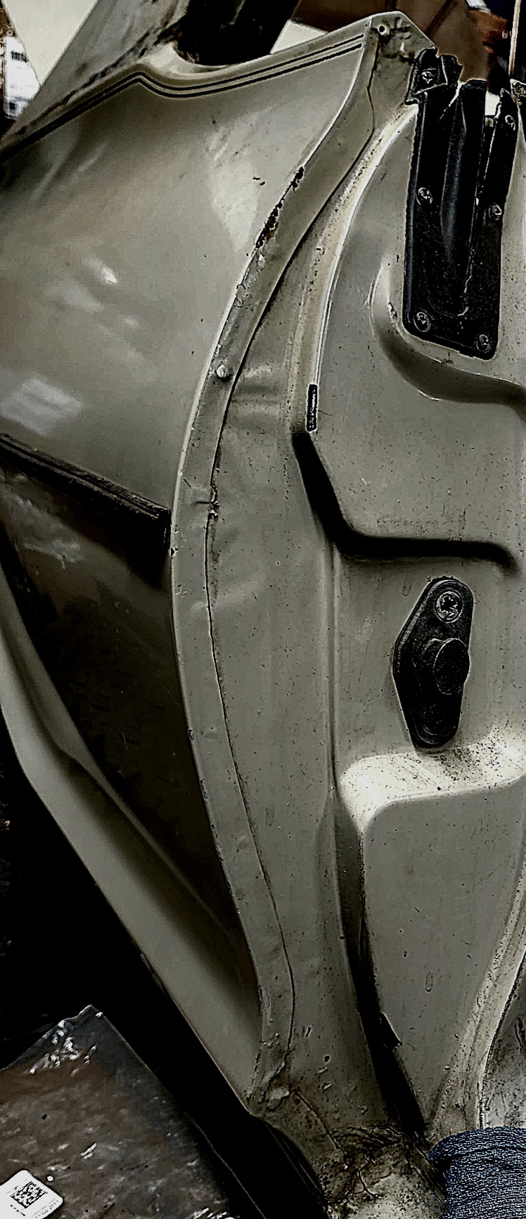

Does anyone have pictures of the factory spot welds along the bottom of the rocker panel and inside the door jam where the rear quarter panel welds to the door jam? My cougar is 1969.

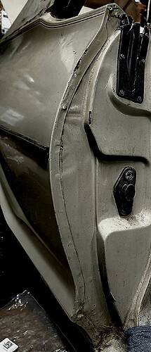

1967 passenger door jam.
I played with the contrast and definition controls a bit to emphasize the spot welds. Rocker will have to wait until I can get out there again.
Thanks, that’s about what I thought they should look like. My car is supposed to be original sheet metal ,and appears to be other than the welds along the bottom of rockers.. I have done a lot of paint and metal work over the years and can usually find what has been done to a car. I haven’t figured out what has been done to the one I have yet. Mine is a 1969. I thought I had posted that in the first post
