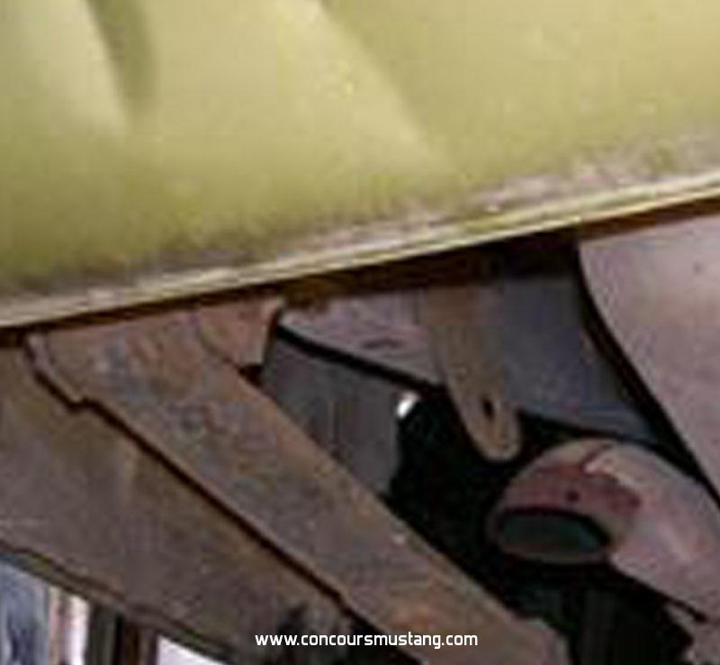

Here is the way they are mounted on 1967 - 73 Cougar:

Royce is the hardware specific to these brackets ?
I think it is only used in this location on the car if that is what you mean. If you look at the article from Markus he shows two types of hardware, one from San Jose and one from Dearborn.

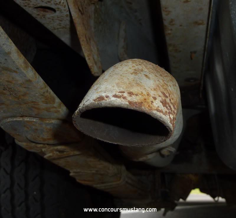

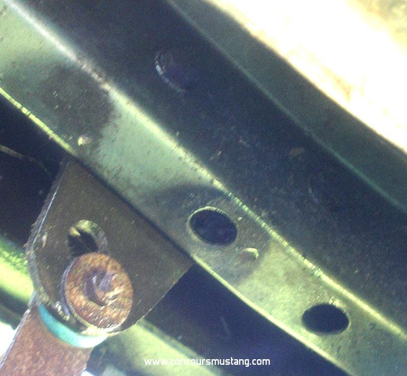

Yes and as Royce mentioned it differs between plants and what exhaust system you had. Single or dual Not correct for Cougar :unamused:
I don’t think there is any single / dual difference on a Cougar Jeff.
So your reporting that they all 67-70 (for example) all used the single (for Mustang) exhaust style with only the two mounting bolts? Thanks for setting me right :slight_smile:
Guess I should have gone through the pictures before responding :wall:
I can not say what 67/68 got. But my 70 Convertible 351 4V has the same brackets as my 70 Hard top with a 351W 2V. I have not looked at the 70 CJ car recently but think they are also the same.

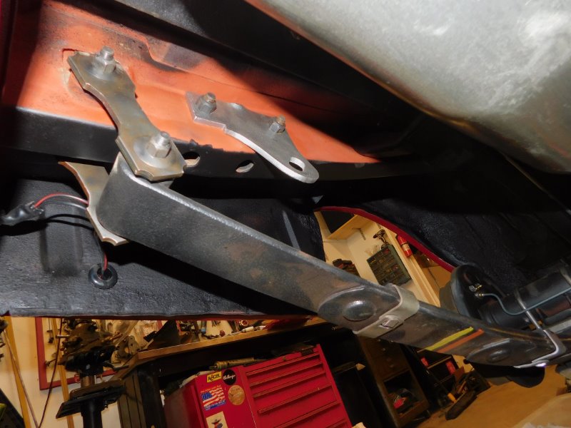

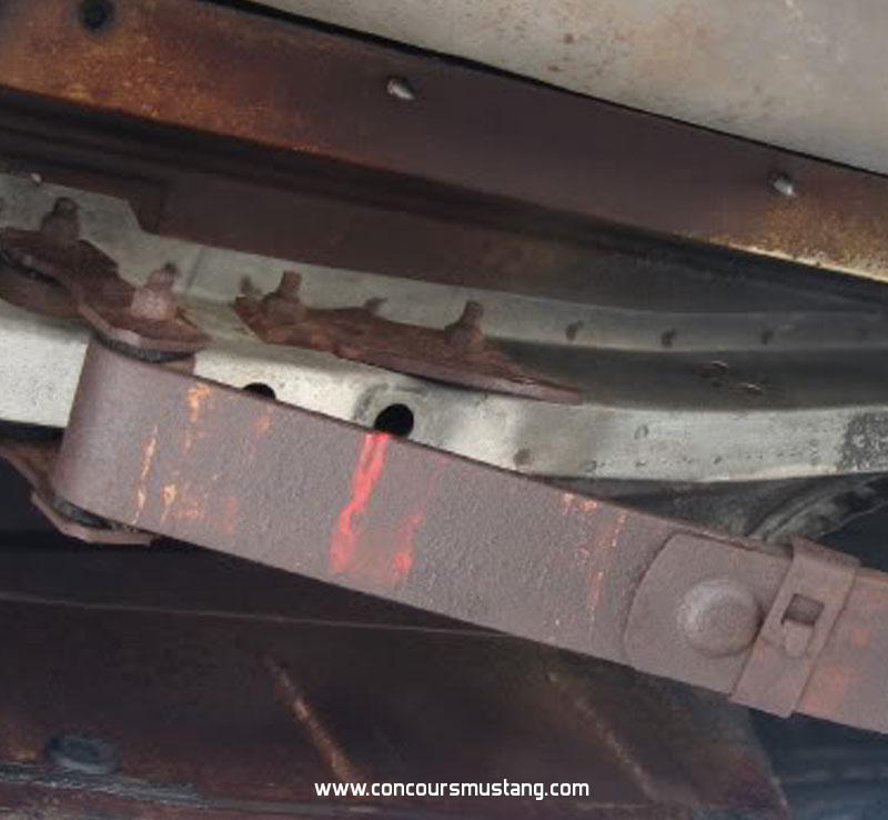

Follow up - Apparently due to the increased length of the car compared to those other Ford products there was not an issue with rubbing or touching of the brackets to the exhaust system. For many of the years not even a hole placed in a good location on the bottom of the frame rail it appears and of course because of this no preattached nut for the third bolt for the other version
67 Dearborn
69 Dearborn
69 San Jose
70 Dearborn
