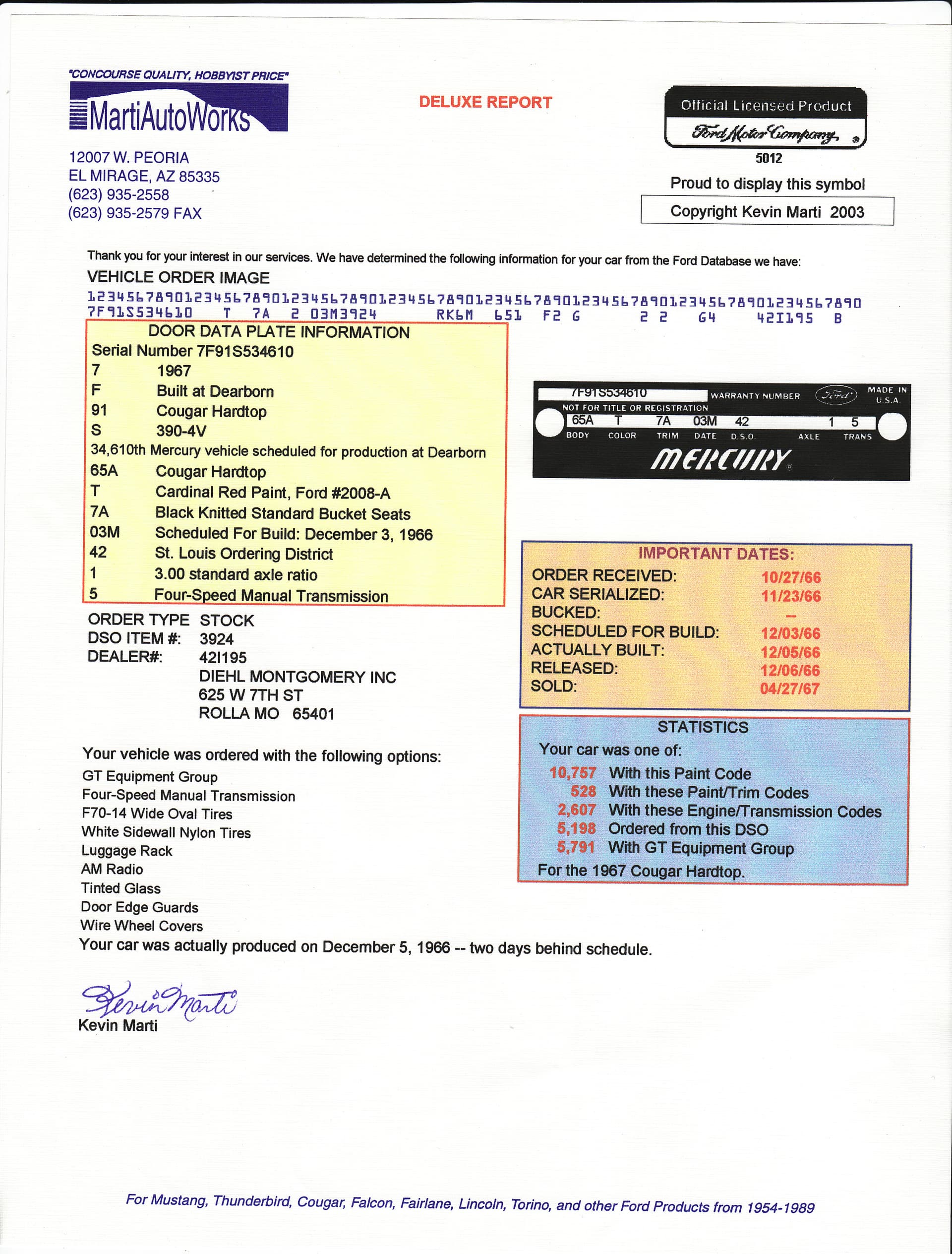

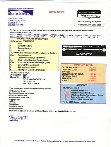

All, as noted previously, I am restoring a Std '67. It is/was factory equipped with the luggage rack, per the Marti report. I have the luggage rack.

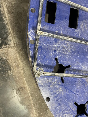

A question has arisen regarding the mounting points of the rack. My restoration guru is questioning the location of the mounting point(s) on the trunk, as it seems quite close the forward trunk lip, and he’s worried that it might hit the rear window. Said window (as is all glass) is currently out of the car.
Does any one have a similar equipped car that can supply dimensions of location holes from the side & front edges?
Also, was there any gasket/washers between the rack and the trunk.
A photo would be great!

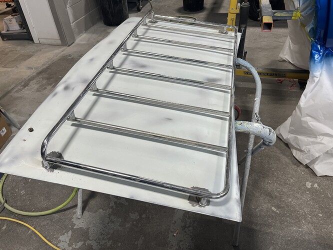

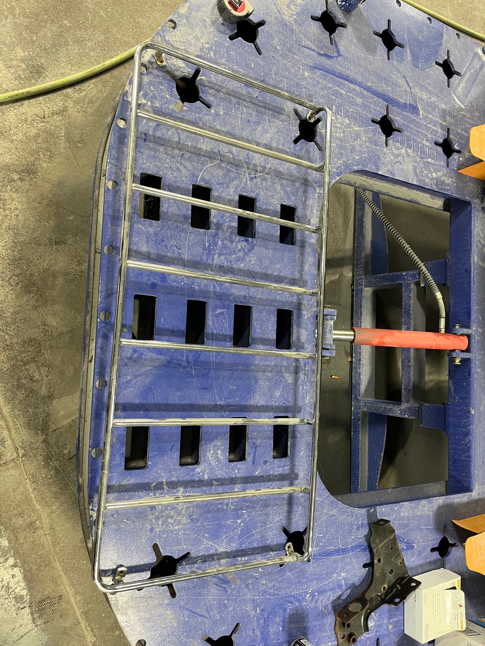

Attached are several photos:
#1 shows the rack in the approximate location as purchased.
![image|666x500]
#2 shows the the front lip
(upload://4uWqmqAqz0gBkmqQnjpFKlIs5H2.jpeg)

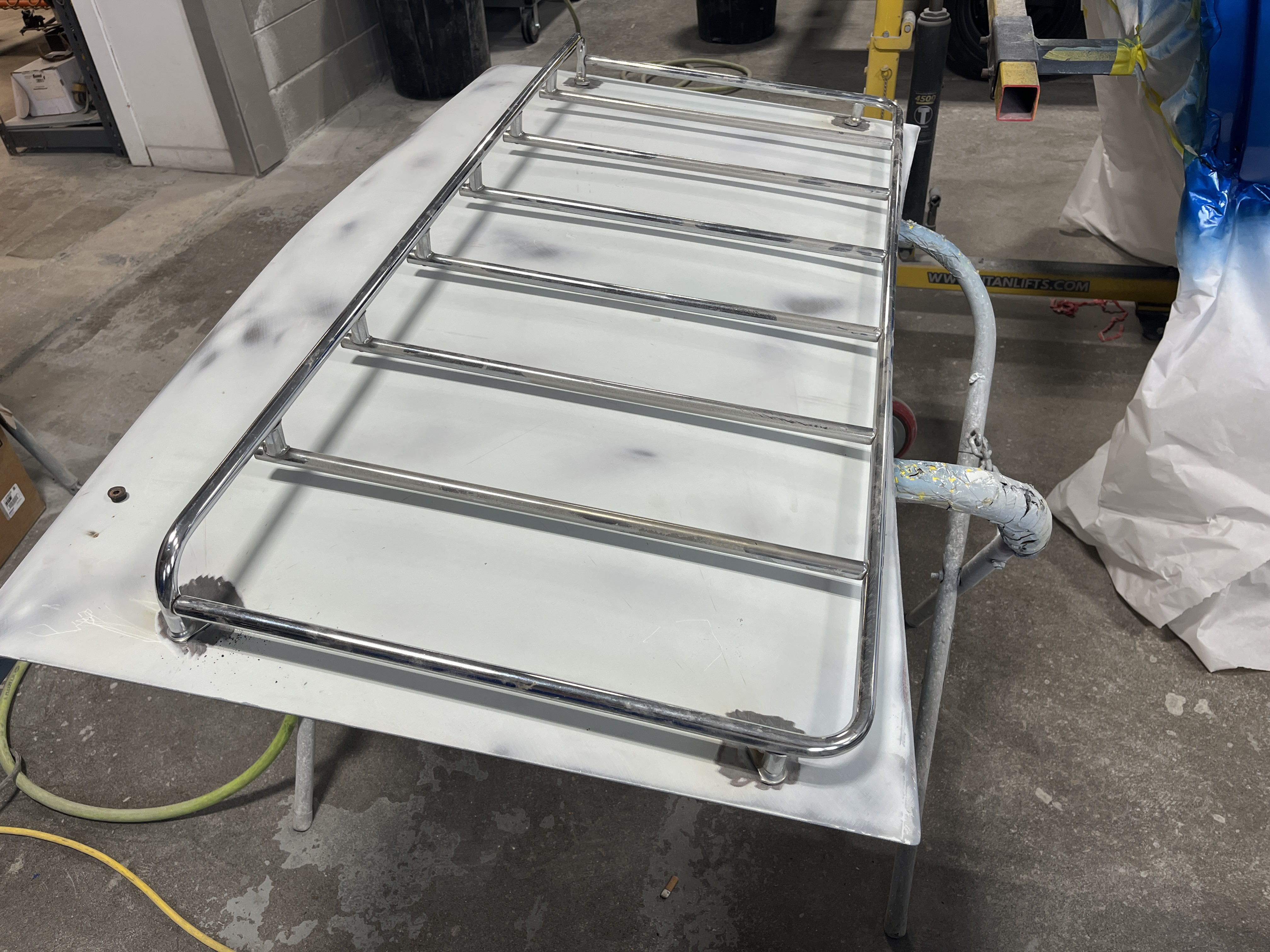

#3 shows what we think the optimal location might be

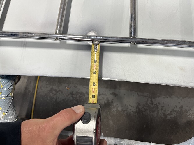

Does anyone know the setback of the luggage rack from front lip of the trunk?
Note that the “feet” the rack sits on are not fixed, but can be re-adjusted to other mounting angles. Also, the “feet” do not appear to match what shows on line parts for the factory rack.

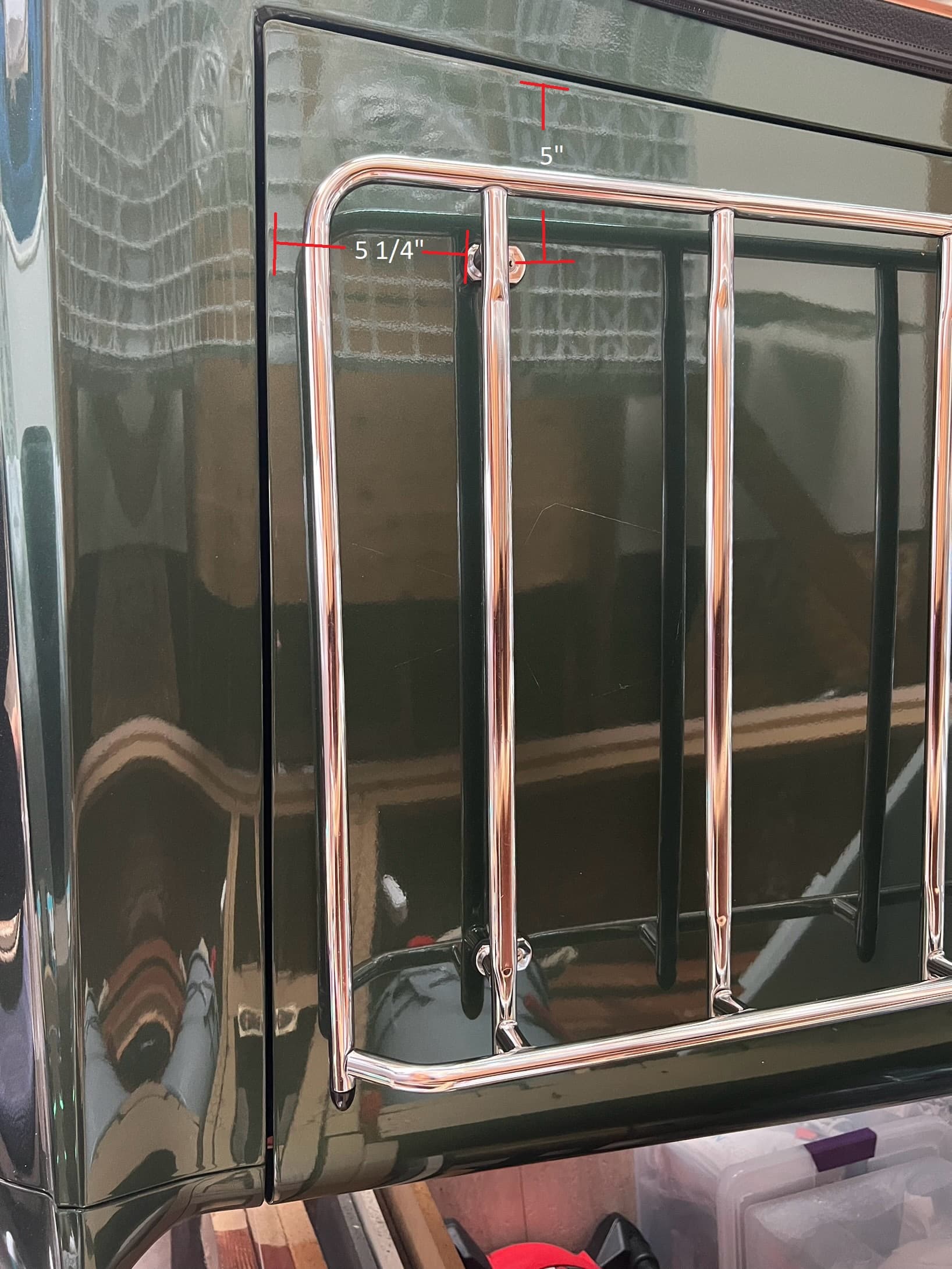

Sorry for the crude picture but this is my 1968. I measured the distance to the mounting hole.
Thanks!
