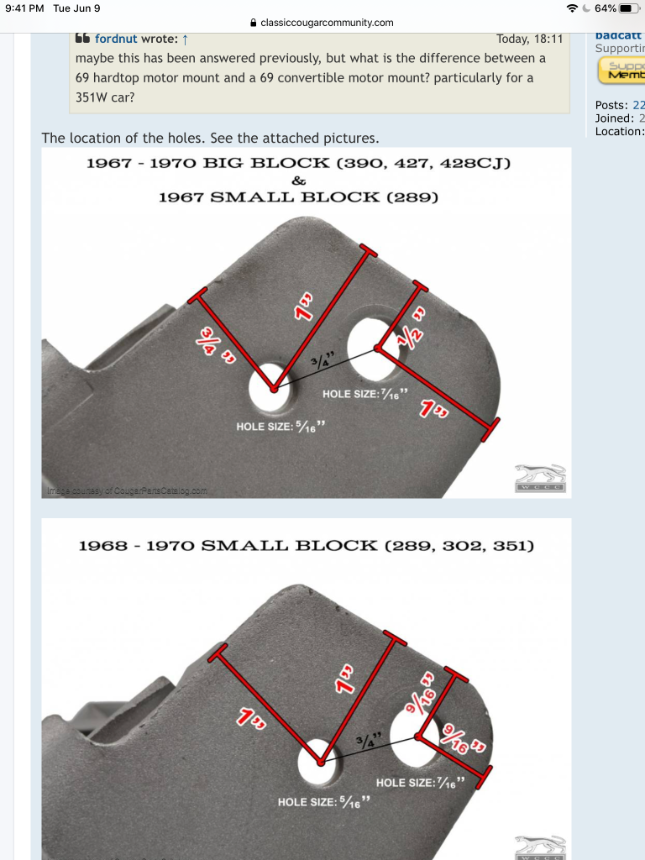

I have the Anchor 2257 and they are really close to the originals. I could only get one in unmodified. I correct that the modification is the relocation of the holes as shown in this diagram? Thanks!
Your photo shows how to make frame mounts that are like '67 small block or 69 - 70 convertible. The isolators is the part I am talking about. The 67 version puts the engine lower. Apparently it is the same as 69 - 70 convertible?

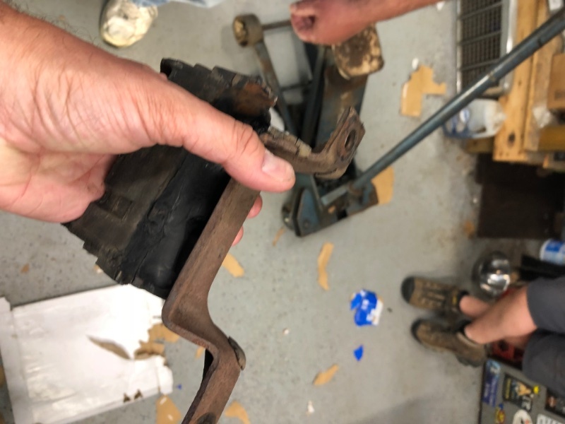

Here is what cracked in half, it is almost identical to the anchor 2257. It has been a while since I replaced just one, but I believe the issue was just hole placement. The driver side went in fine, but i just couldn’t get the second one in. My technique isn’t great, I was on the floor, engine slightly jacked up for access.
Is the isolator part of the mount?

The rubber part is the isolator.
