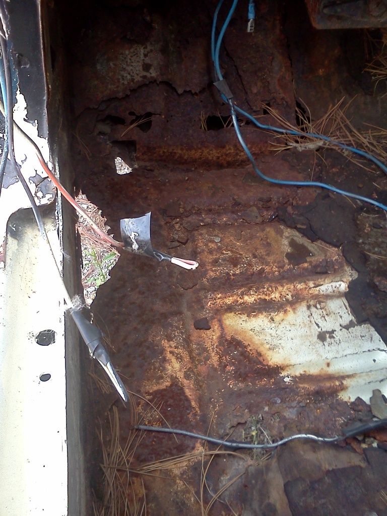

annnnnnnnd the rust…cover your eyes :stuck_out_tongue:
floor pans are kinda sucky. driver’s side is the worst, naturally. this goes up kinda onto the firewall, i may just buy a whole floor-to-firewall piece and cut what i need off of it.
frame’s good though, it’s just the floor pan rusting away from it. frame’s nice and solid.

Looks like a good project,…I smell restomod. Luckily all of the parts that are showing rust damaged are being reproduced,…including the trunk panels,…thanks to the guys at John’s Classic Cougars http://www.johnsclassiccougars.com/ProductDetails.asp?ProductCode=JC-203 That door dent looks repairable to me,…only one compound bend in a workable area. Are the taillights, extensions and bumpers somewhere in that parts mix??
well it’s good to know at least one person thinks it’s not a lost cause. that’s what i was thinking, all the panels that are trash are being repro’d. so that’s a general good sign.
problem is, i’m trying to locate a place that sells OEM or better gauge steel. i don’t want to put something any thinner than OE if i can help it, on this car. i know the floor pans i’m just going to make, and i may put a brace or two, in places.

These are good quality floor pans; http://www.mustangsunlimited.com/itemdy00.asp?T1=FLP1+01 and here’s the torque boxes to be considered; http://compare.ebay.com/like/130700649465?var=lv&ltyp=AllFixedPriceItemTypes&var=sbar&_lwgsi=y&cbt=y

Yes,…those exact ones, plus I’ve held in my hands the lesser quality pans. Now to the rear frame rail,…as long as the inner reinforcement has not broken loose,…the rail can be patched. Cut out the areas where the rust has expanded and ruptured the metal and weld in small patches. A lot easier than trying to splice-in a Mustang frame rail,…which is not the same as the Cougars rail. Same goes for the trunk floor panel directly above the rear frame rail,…cut back to good metal and patch. Unfortunately as shown in your photo of the drivers side floor pan,…http://i193.photobucket.com/albums/z235/Heindl345/IMG_20120523_161052.jpg
the top of the torque box is rusted through,. Dynacorn sells a torque box which is a two part unit,…top and bottom separated, if your bottom section is good, you may get away with just replacing the top portion.
thank you for the info on the frame rail, as that saves me some money, and good thing, because i was thinking of picking up mustang frame rails.
EDIT: i did a little research and checked out some pictures and i see what you’re saying the torque boxes are…my gut feeling tells me to just replace them anyway, unless they’re super solid under those floor pans. which i doubt. so i think i’ll probably still buy the torque boxes and just try to find someone with some good experience to help me weld them in (STRAIGHT)…
i’d rather not take the chance, that’s a pretty critical piece.
is the Dynacorn piece better than what you can get from MustangsUnlimited.com? theirs say it’s stamped out of 14ga steel…what’s Dynacorn’s made of?
