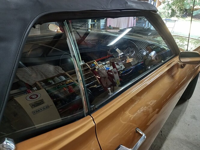

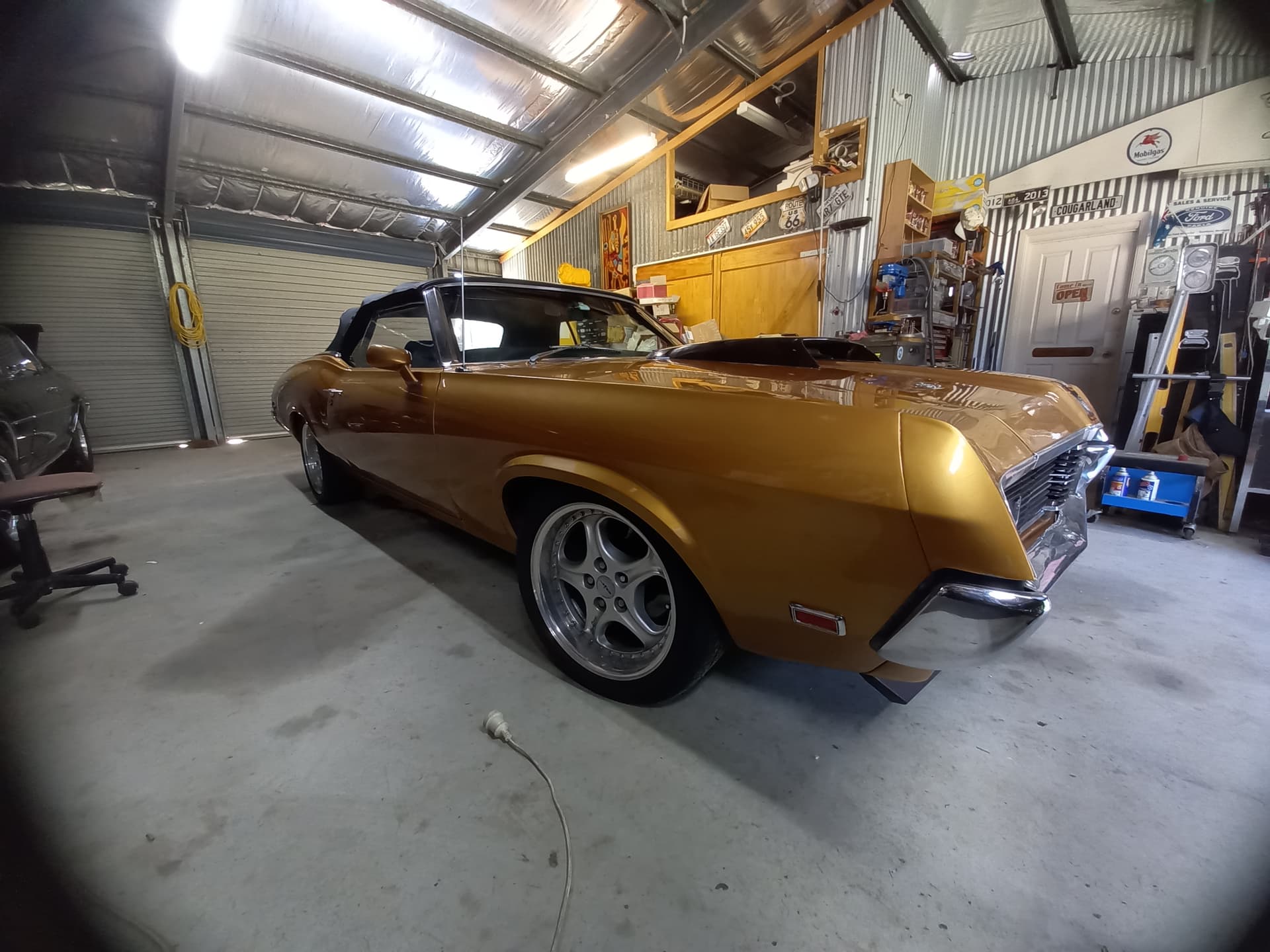

Job done. Biggest problem was getting the 70 brackets into 69 doors. Takes a bit of juggling and some extra force. Still have to finalise adjustments including one quarter vent that is way off.
Stuck with the manual winders and removed the central lock, alarm and some other failing electronics while I was at it. Installed new locks and door handles that, like the glass, have been sitting on the shelf for 20+ years
Hey Pat. All done after 20 years. Wasn’t difficult.
