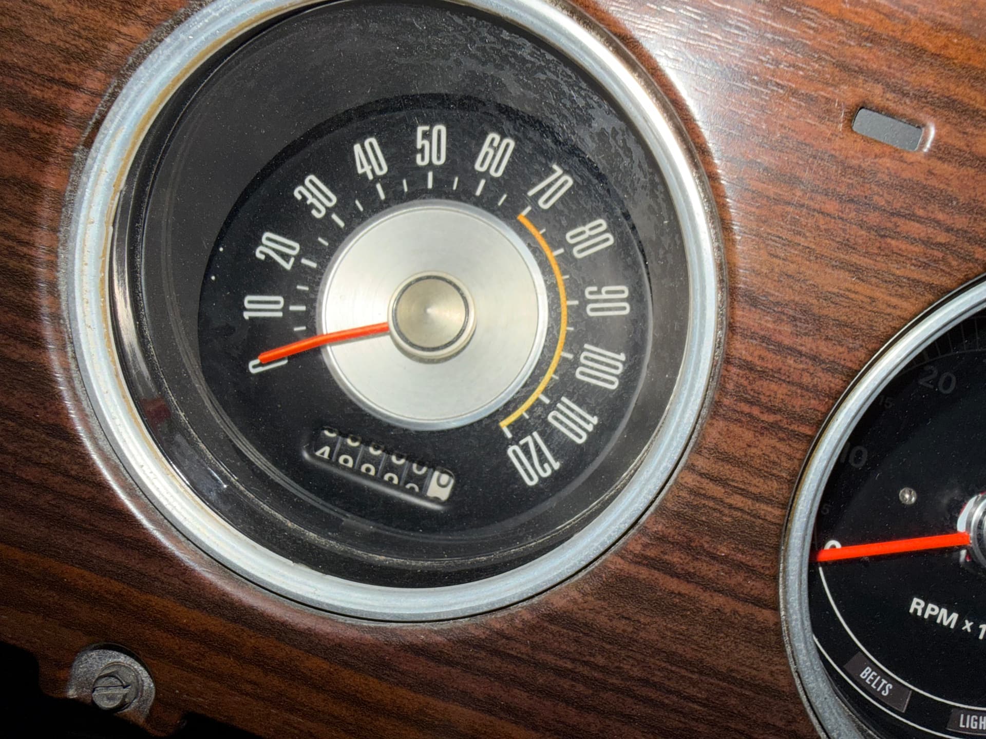

So I took the old girl for a spin a few weeks ago, suddenly the needle started flicking… if I was doing 45 it was flicking from zero to 60…

Only then did I notice the mileage 49999.9
It may be that there is a gear jumping internally, against trying to turn all the registers? Has anyone else had something similar? If so what did you do? I am wondering if it is the cable square jumping inside the driven receiver? And whether to pull the cluster and drive it through 50000.0 on the table?

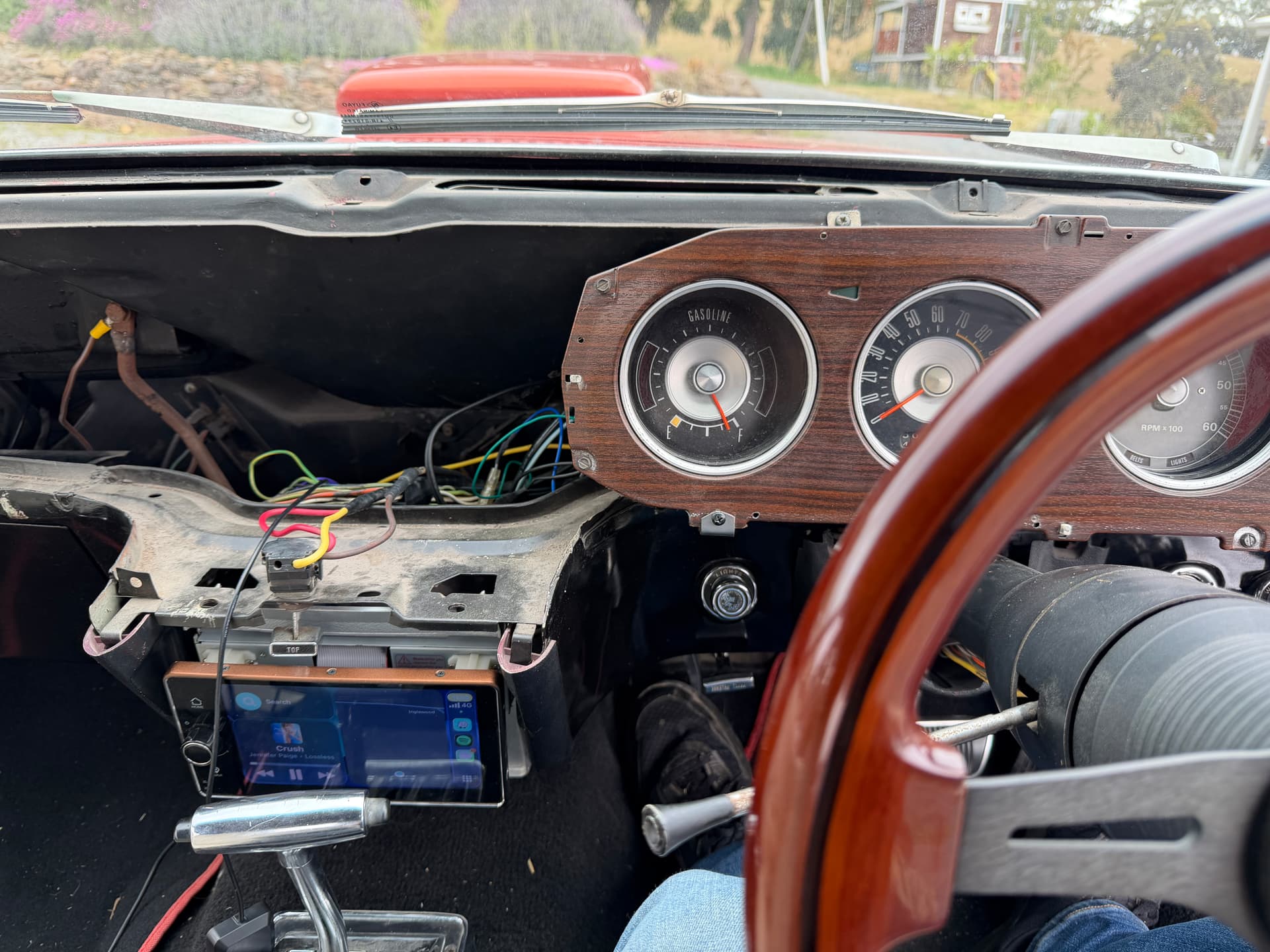

So I tried taking her for a spin, without putting the crash pad in. This way i could reach around the side of the cluster and ensure speedo cable was seated correctly. (Which it was)
At trundling pace it is a kick about every hundred yards, and the odometer did not move. I can hear a skipping gear.

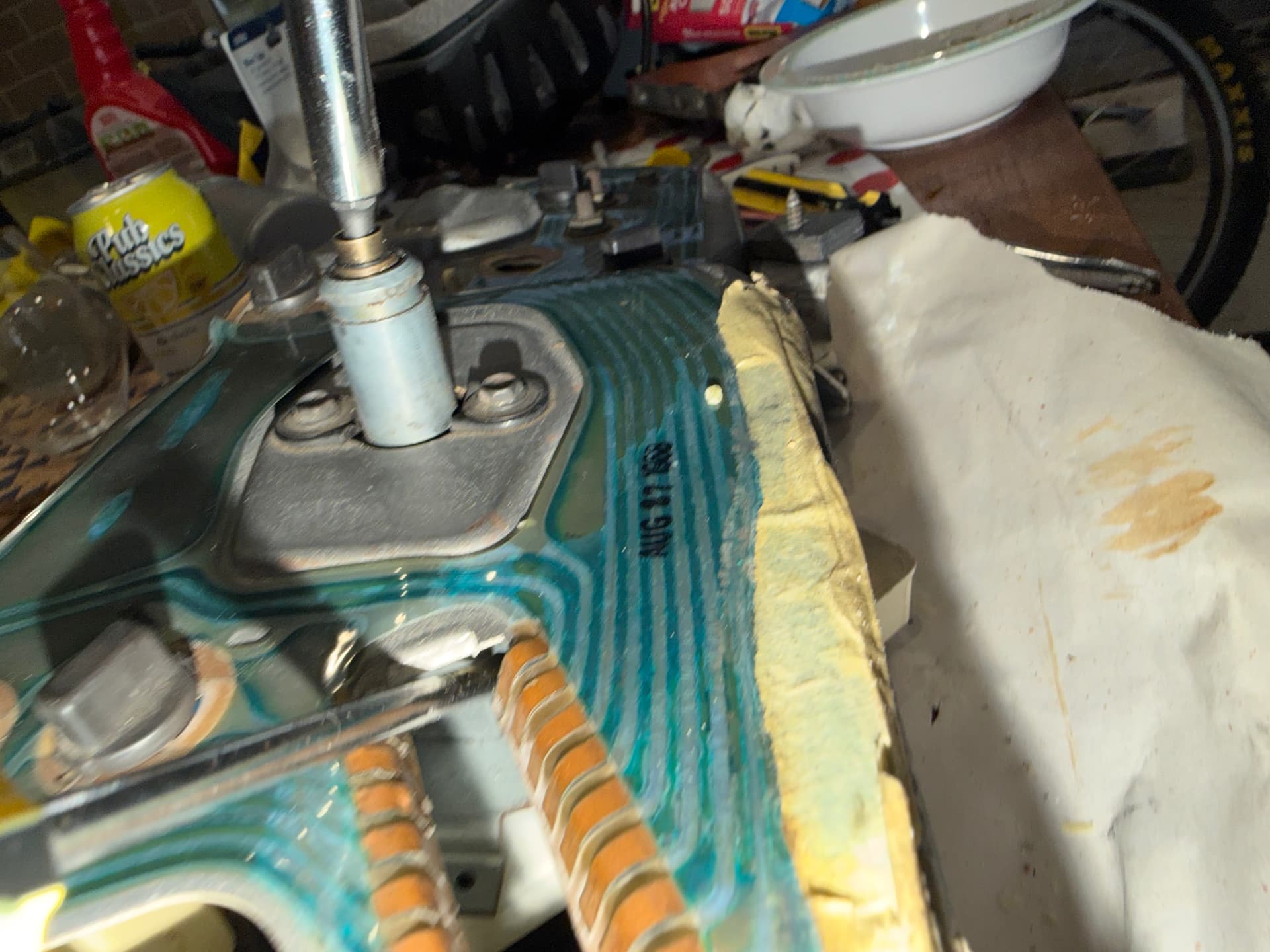

I pulled the cluster took it to the patio, and tried to move the gear through the main harness plug hole whilst driving the speedo using a square

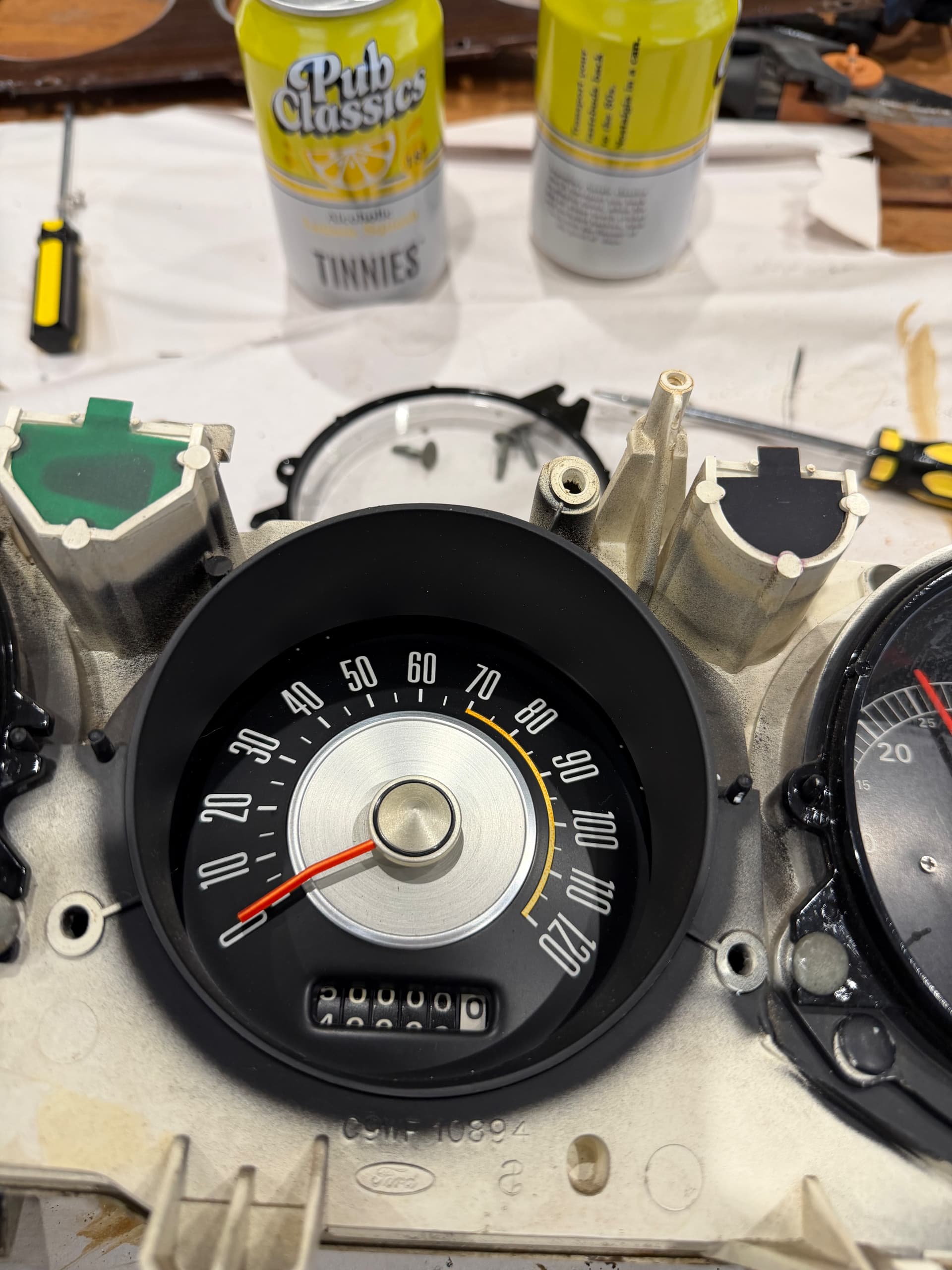

That did not work… so I took the faux wood grain off, then I thought I could maybe assist the registers whilst spinning the drive (if I removed the lense) . I was worried the lense mounting plugs were plastic-unobtanium-55-year-frangible-fallapartium, so I had an alcoholic lemon squash for bravery and gently prized them off. (They are metal).
That did not work either… so I flipped it over to take the “back off” …. I could see some chalkiness, so a second “bravery” lemon squash later I had a go… Which ended up being put back any screw that was not an edge screw and flip over (it is the front that comes off).

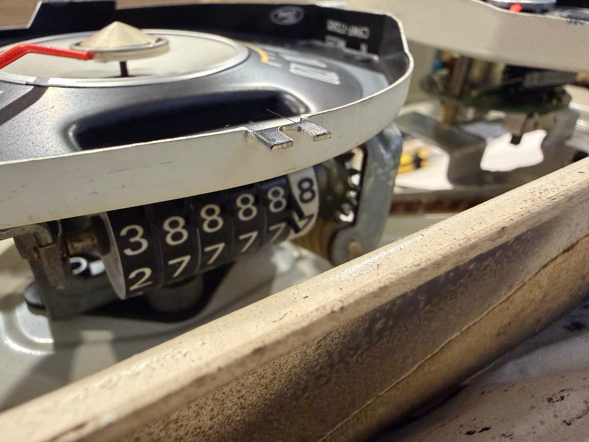

Now you can get to the odo from underneath. So I persuaded 1/2 mile as I ran the Speedo using my drill and the square.

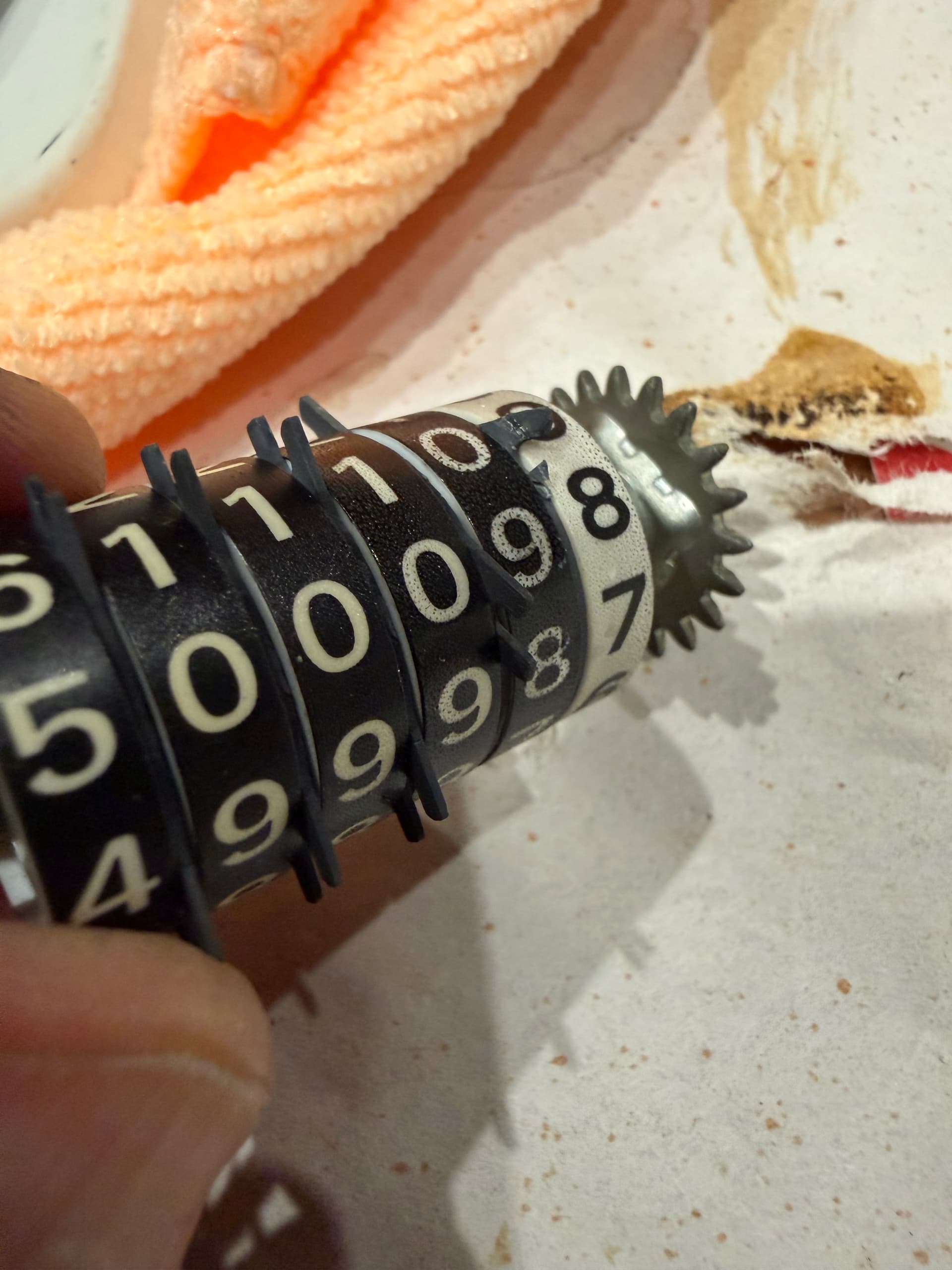

Notice the indexing thingy that I put back around.

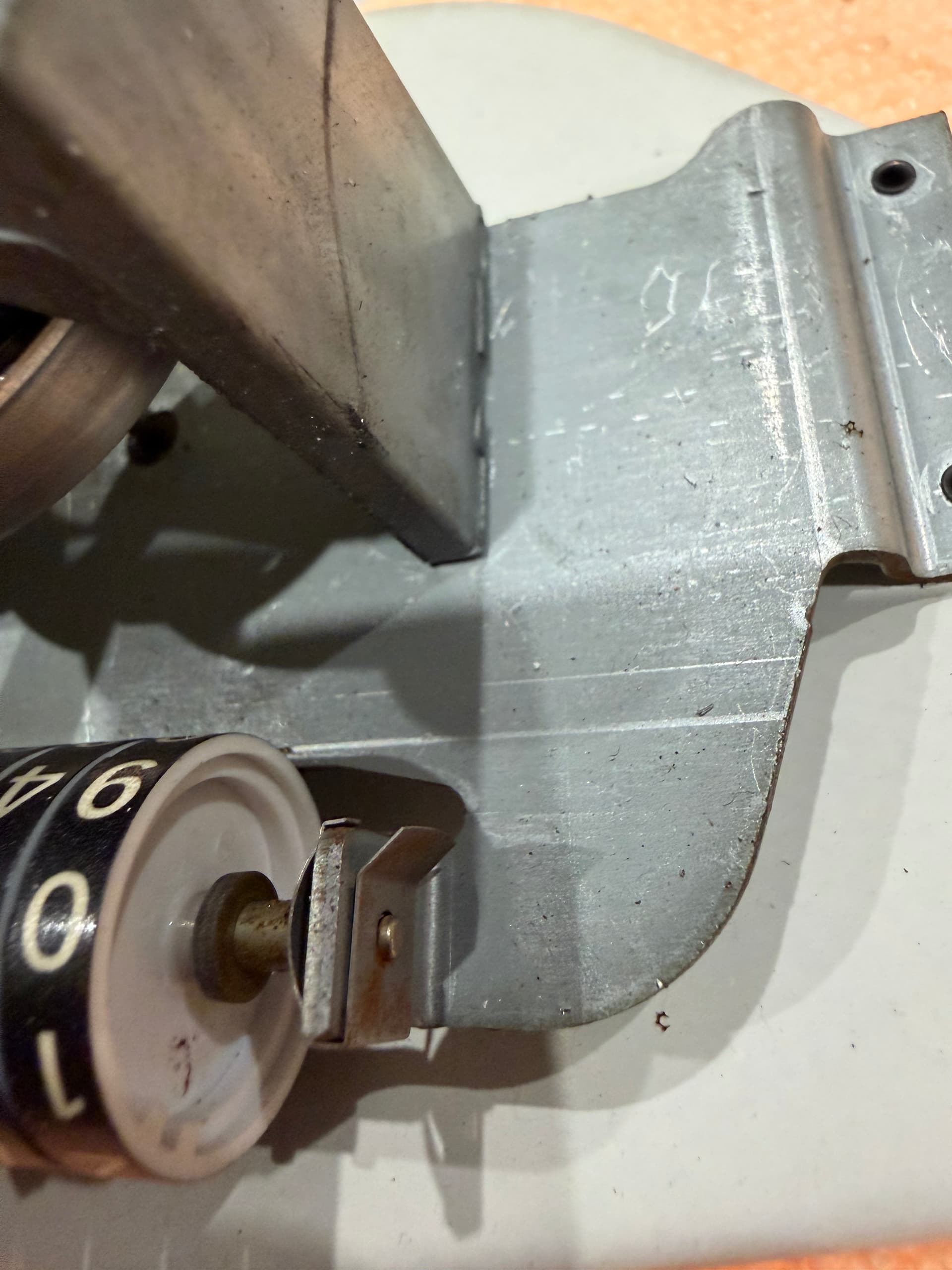

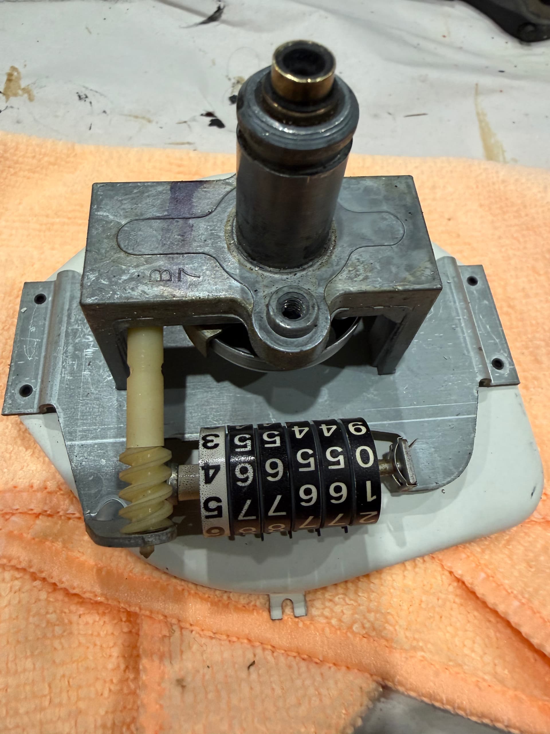

When removing the front of the cluster, flip the cluster over and just remove the edge hex screws (Don’t remove those same screws in the body of the cluster!). Then loosen the two bigger screws ether side of the speedo cable post, lower the speedo onto a soft cloth by the post.

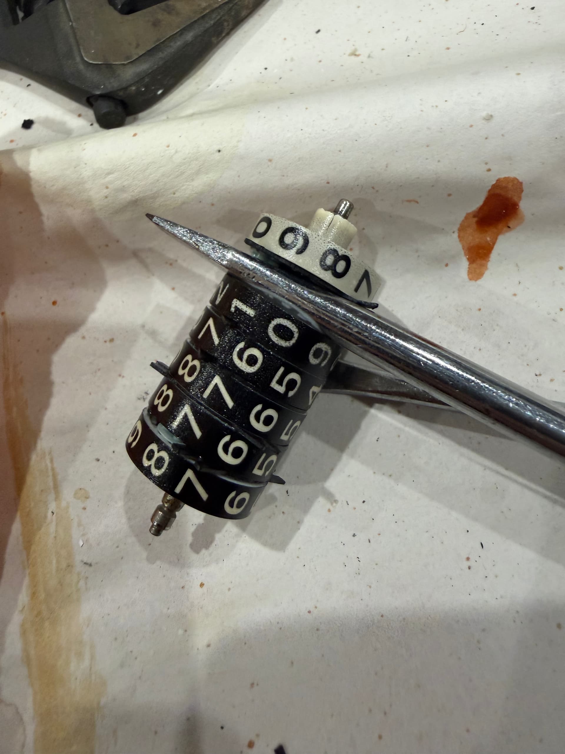

Carefully lever off the clip on the Odo registers shaft
Then you can extract the whole thing, you can see here (below) how there are a series of tabs that locate on the odo window in the speedo face. There is one for each register, and it locates so the register turns against this as torque is applied by little internal gears in the preceding register
You can see how my tenths locating tab is bent and mangled as the torque of the tenths drove against all registers . The thin metal inside holding the catch gear was bent.. nothing I could do to make it work, tried lubing etc.
Knowing I had nothing to loose I tried separating the tenths register but no game, so I removed the metal driven gear, put a random mileage just over 50k and put it back in… in due course I will attempt to source a new odo set, but at least the plastic worm gear won’t get chewed out and the speedo won’t jump.

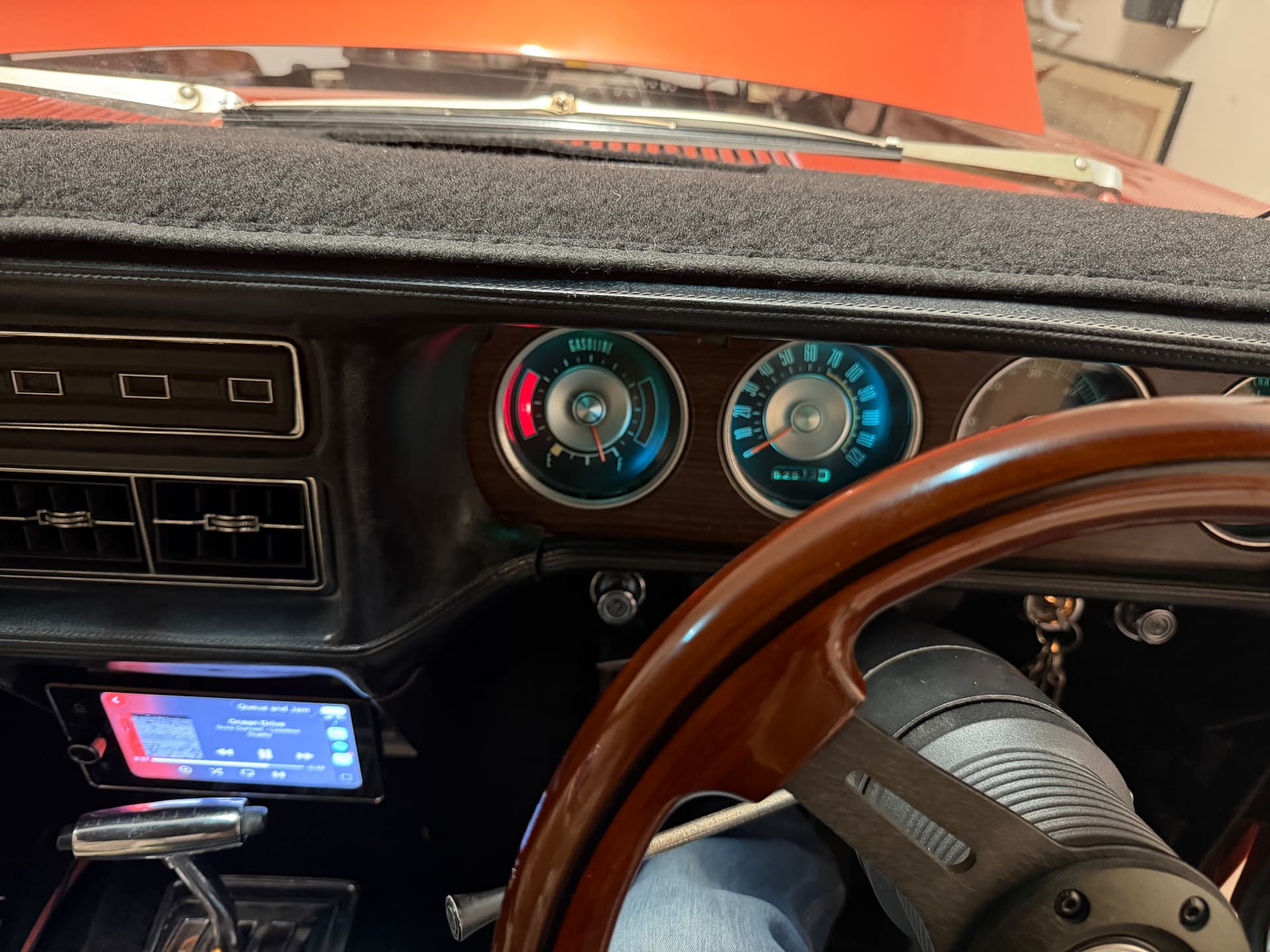

Tonight I just put the cluster and crash pad back in so I can drive it.
