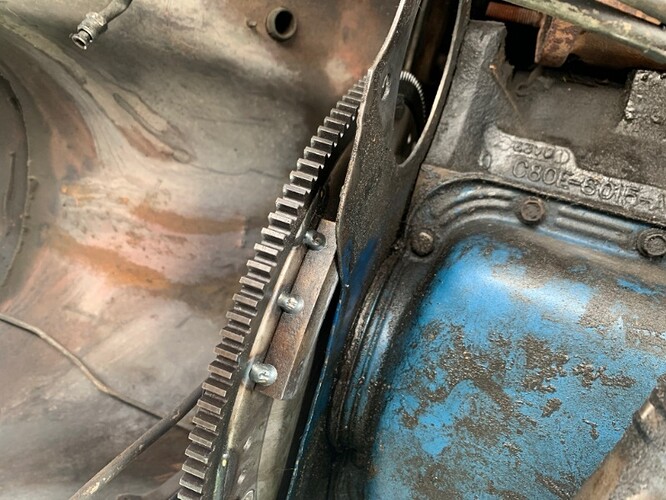

FLYWHEEL hitting the spacer plate
haven’t found the problem. yet … had to build wheel cribs to get car high enough to clear the transmission… got it removed today but haven’t began trying to find/fix the problem …planning on looking up some diagrams to see if anything is out of order

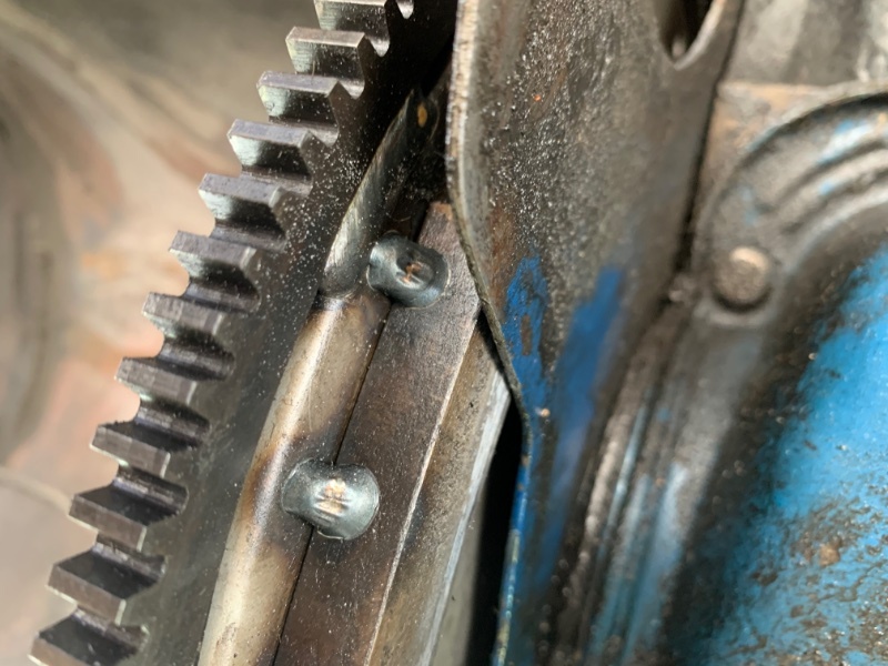

Found that the flywheel is still hitting the plate after removal here are pics of both
I doubt that is an original Ford flywheel. The issue just might be what we all have to deal with, out of spec chinese parts.

I agree that the balance weight is too think. I checked one I have and it measures about 0.375 thick. I hope this fixes your problem.
UPDATE!!!
Finally got the existing flywheel off and compared them before replacing it with the one CWatson gave me and the existing flywheel was definitely
aftermarket (Chinese) and the weight on it was much taller than the original
