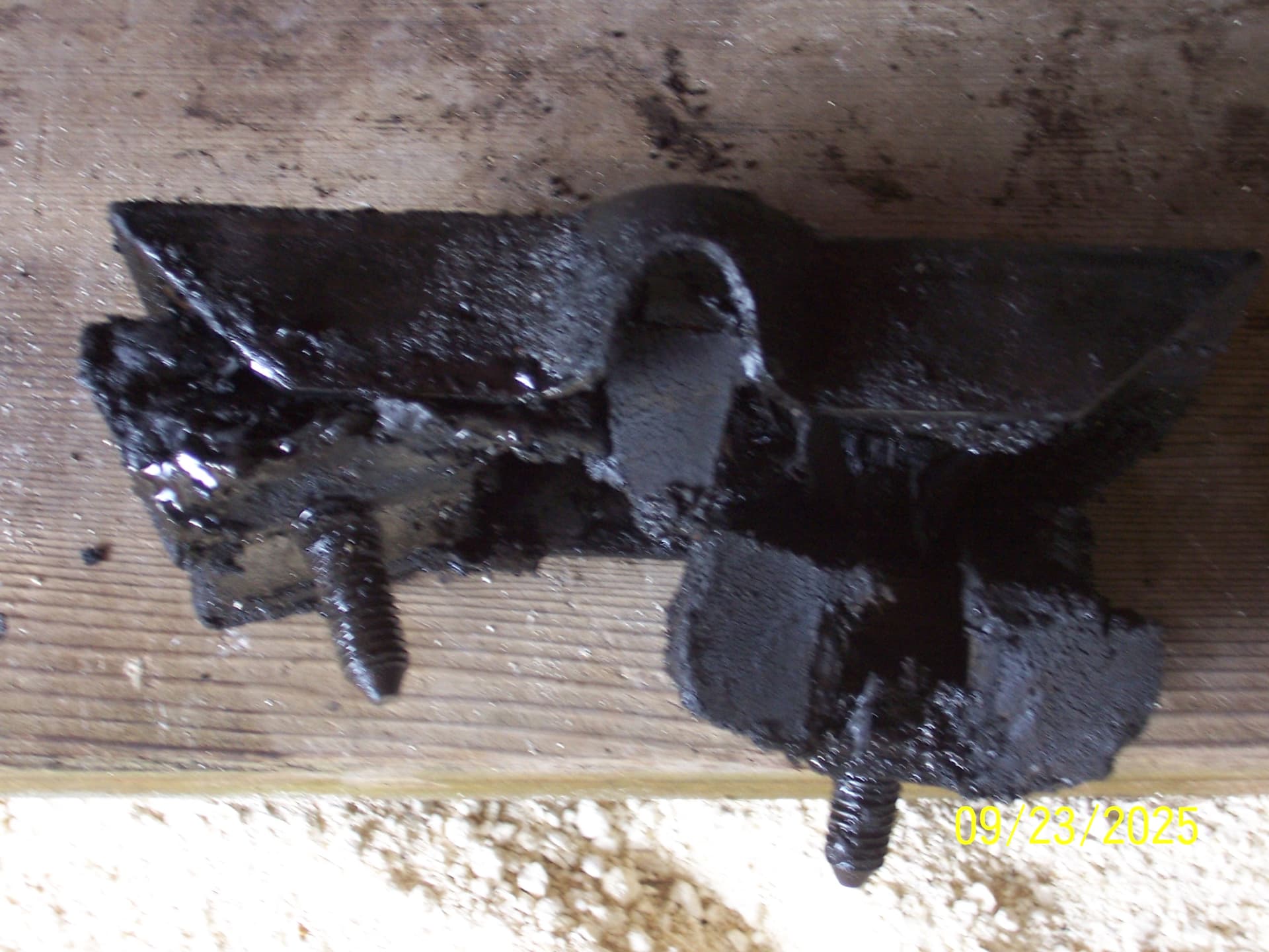

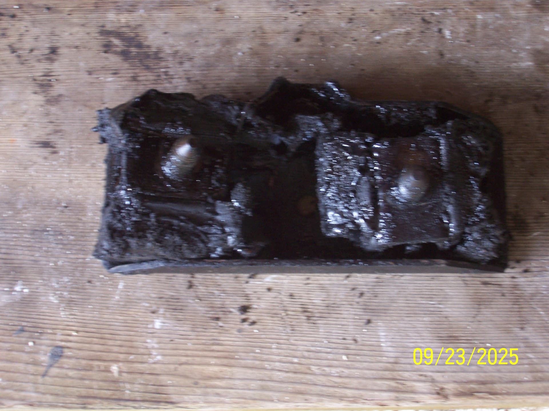

Basically yes; just saying when I grip the drive shaft at the slip yoke and do a left to right “push/pull” there is no slop in the yoke, but the tail end of the extension housing shows movement of about 1/16”. I am suspecting it may be a bad rear mount, because the front engine mounts are both shot. All three inbound and will report later in the week when I put them in. Thanks for the input Bill - and when this is all over I still have that power steering control valve to rebuild!
…and the answer is: transmission mount, replaced today - play is gone. Imagine that. I hear Don Rush buys OEM parts, I wonder how much he’ll give me for this?
He might give you a hard time…
