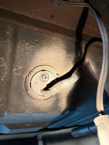

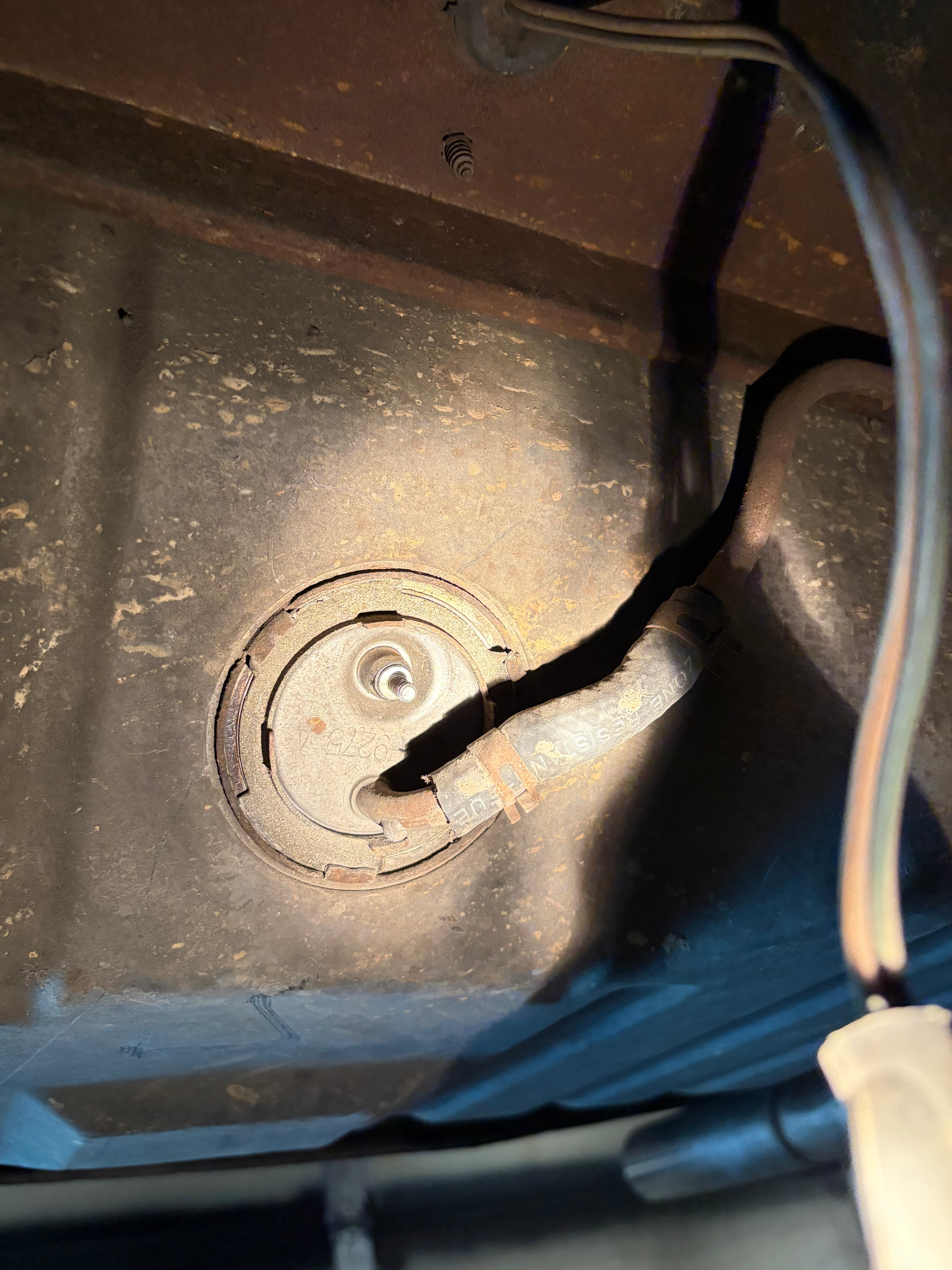

Found my low fuel light problem-69 XR-7
Welp…that ain’t right!
Yes, the low fuel senders included a thermistor, and have two wires that plug into the sender. One for the float variable resistor, and one for the thermistor.
Looking closer at your pic, it looks like your harness is two wire, but the sender got replaced by one without the low fuel option.
