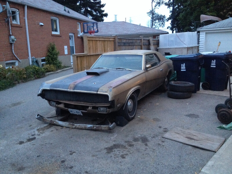

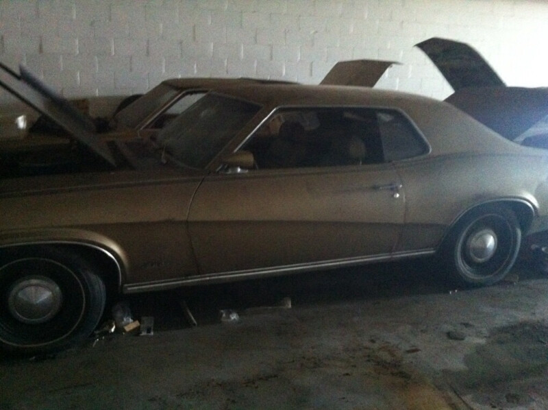

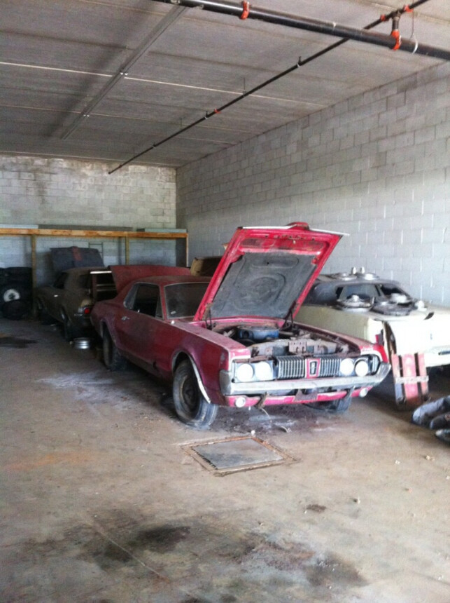

The red one is the parts the gold it the 390 with hood scoop with pin laches.
Gold 390 is very cool (3 or 4 speed?). Love the dog dish hubcaps.

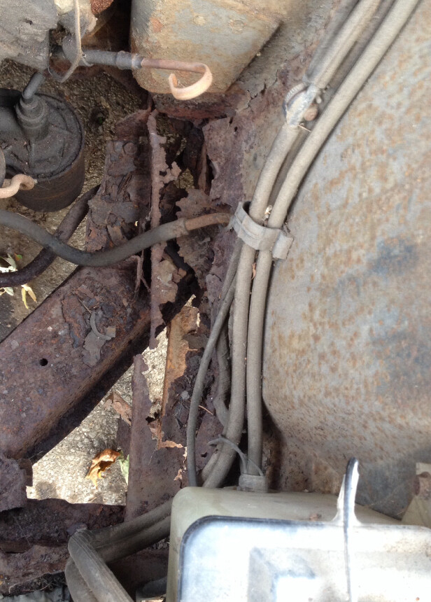

Here is a picture of the rotten front subframe. The rear doesn’t seem to be so bad. Is there any website that has fair prices?
Take a look at the Dynacorn one piece frame rail and shock tower assy, used them on my Mustang and they are hi quality pieces.
Ouch!
