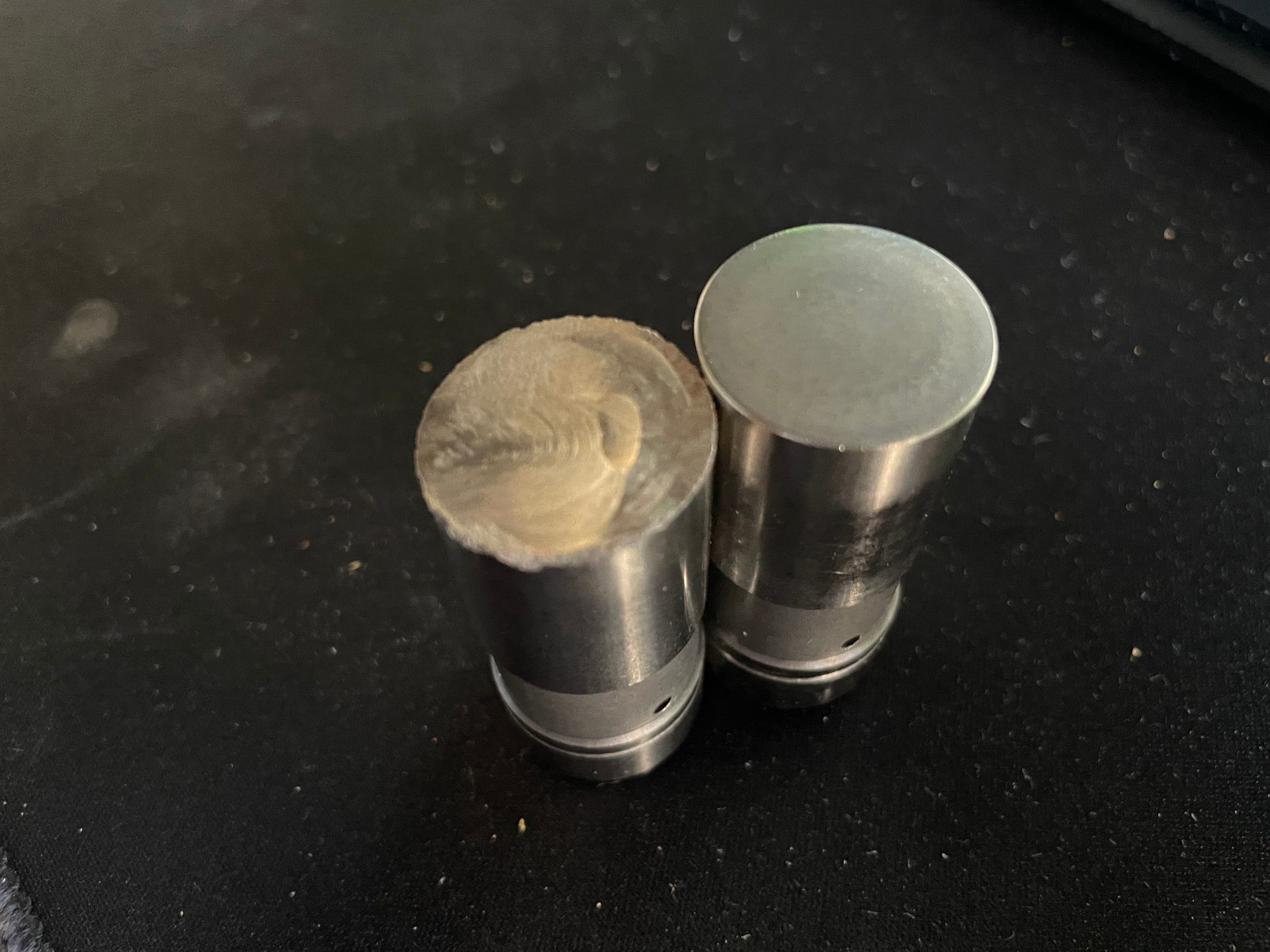

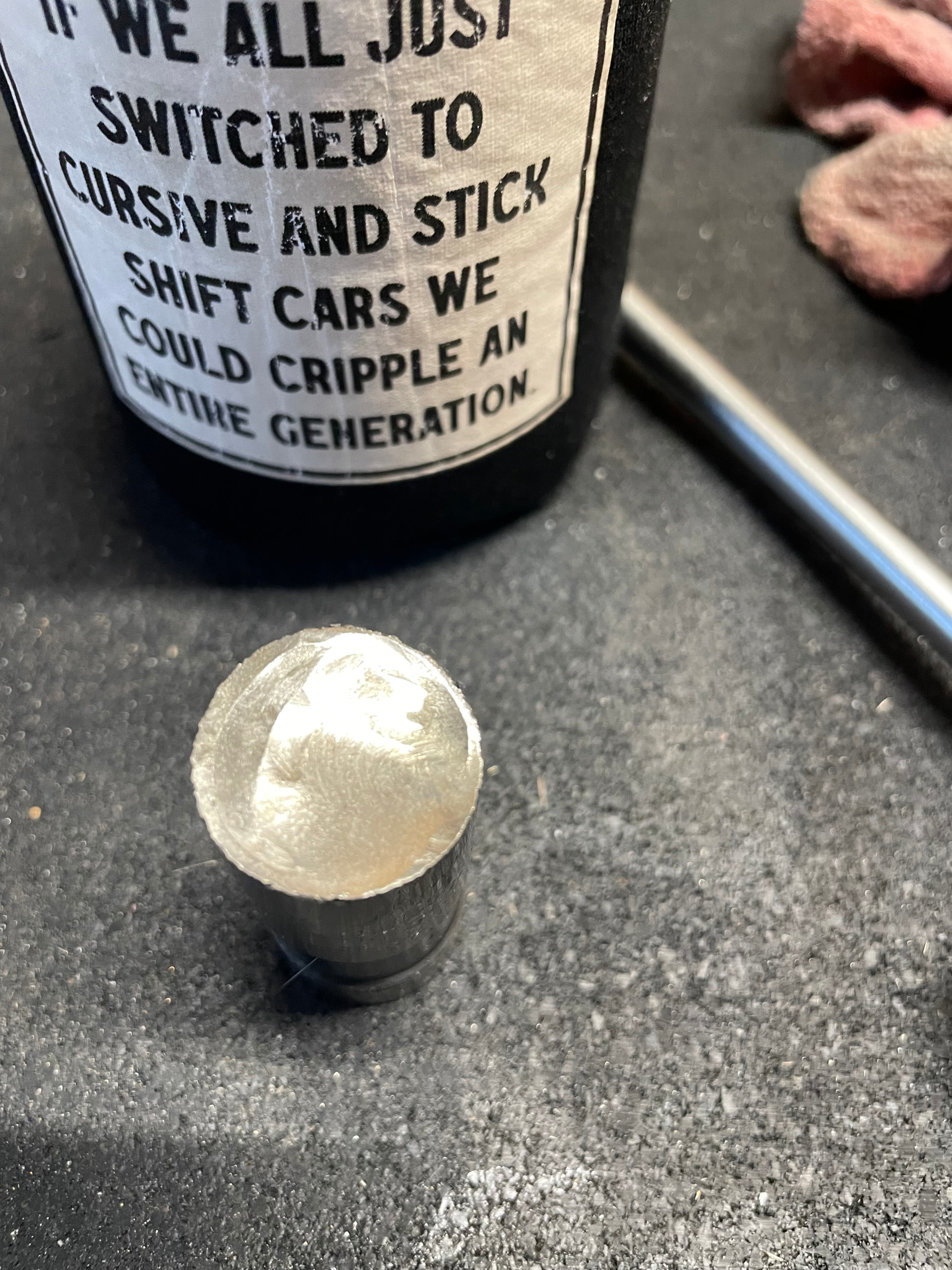

The #6 intake rocker stud was a fairly straight forward replacement, but the original stud probably pulled out in the first place because this is the #6 intake lifter that I finally got around to pulling…
I kept the factory cam and lifters and made sure the lifters were bagged and numbered, so I am going to flush the oil system and try putting it back in and see if I can get 30-60k miles out of it before it needs another overhaul.
I would replace that lifter with a new one first. That one has seen better days.

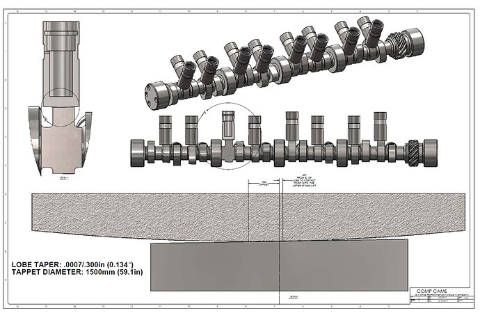

Unfortunately, the condition of that lifter suggests the cam lobe has probably also lost material where a new lifter may not resolve your problem. It doesn’t take much to lose the very slight lobe taper needed to rotate the lifter in its bore.

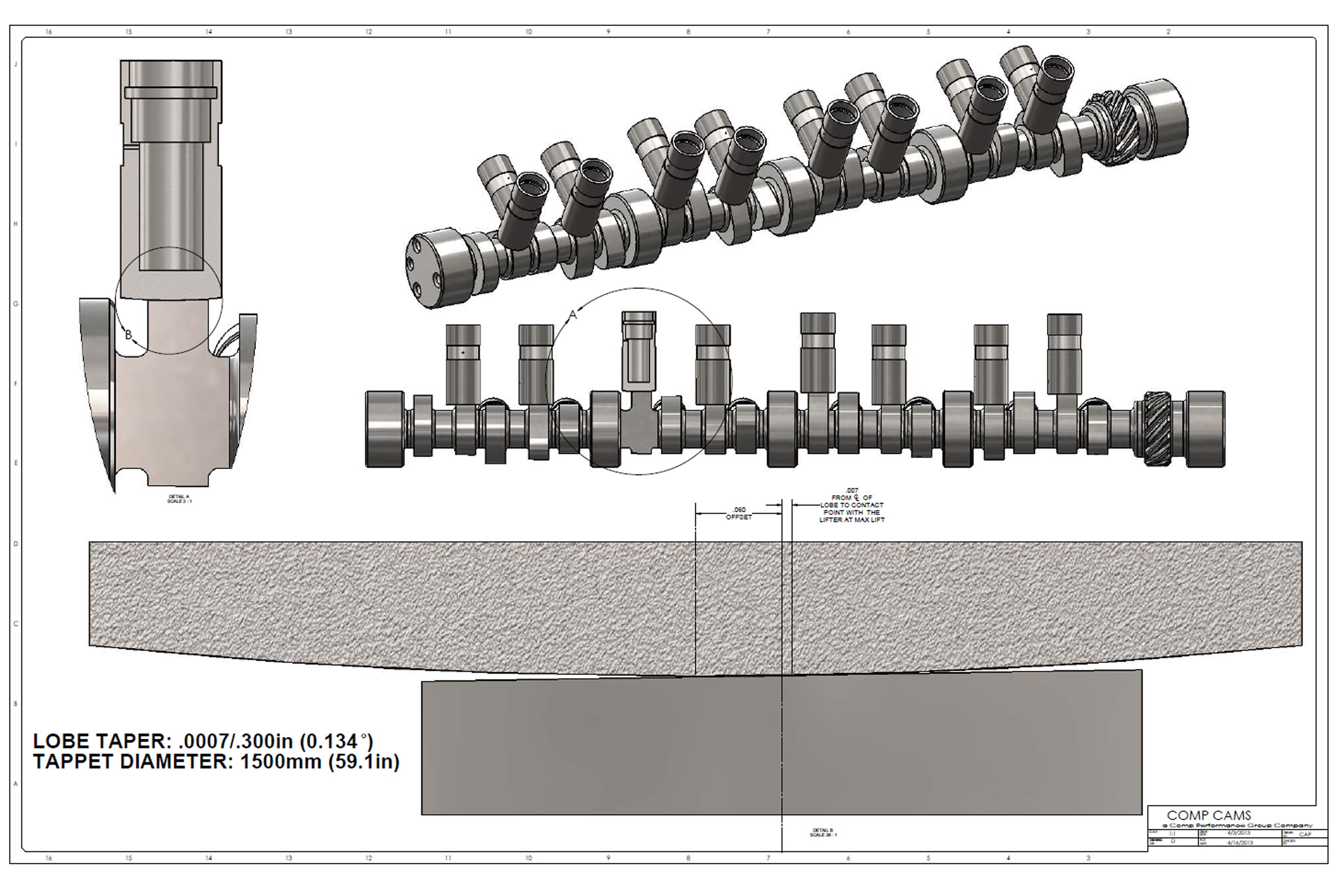

Anyway, the attached COMP Cams picture provides a very good illustration of how the cam lobe to lifter face interacts during operation.
The cam needs to be checked too. Maybe it is fine but maybe it needs to be replaced.
Absolutely, and I will be shocked and buy a stack of lottery tickets if the lobe isn’t as bad as the lifter. Here’s a picture next to a lifter with a good heel as a comparison.
Yep, that cam lobe is almost certainly ruined. The bad lifter is almost worn through into its internal cavity (doesn’t take long…).
Surprised you got that lifter out from the top with those rough edges and mushroom shape.
If you “encouraged” it with a tool, you’ll want to inspect that lifter bore.
The head is still on so I couldn’t use my puller. I expected a fight but a light coaxing with a screwdriver under the spring retaining lip got it started and a slid it out easily by hand with a dry rag. What could have mushroomed is just gone, so hopefully most of it ended up in the pan and not circulating through places where it can do a lot of damage.
