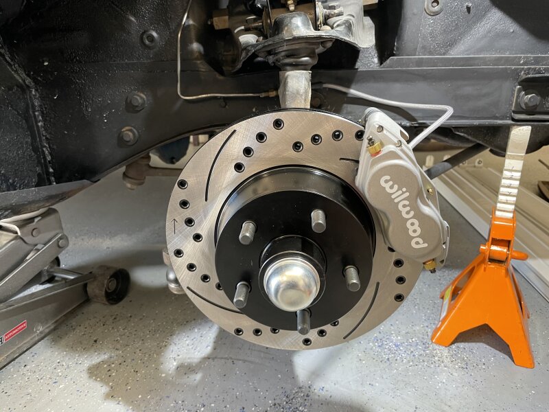

I found this kit to be a cost effective solution for me to ditch the Granada setup that came on my car. I very happy with it and its much nicer then what I had previously. This will work with your factory disc or drum spindles.
https://www.wilwood.com/BrakeKits/BrakeKitsProdFront?itemno=140-13476-DR&year=1968&make=Mercury&model=Cougar&option=Disc+Brake+Spindle

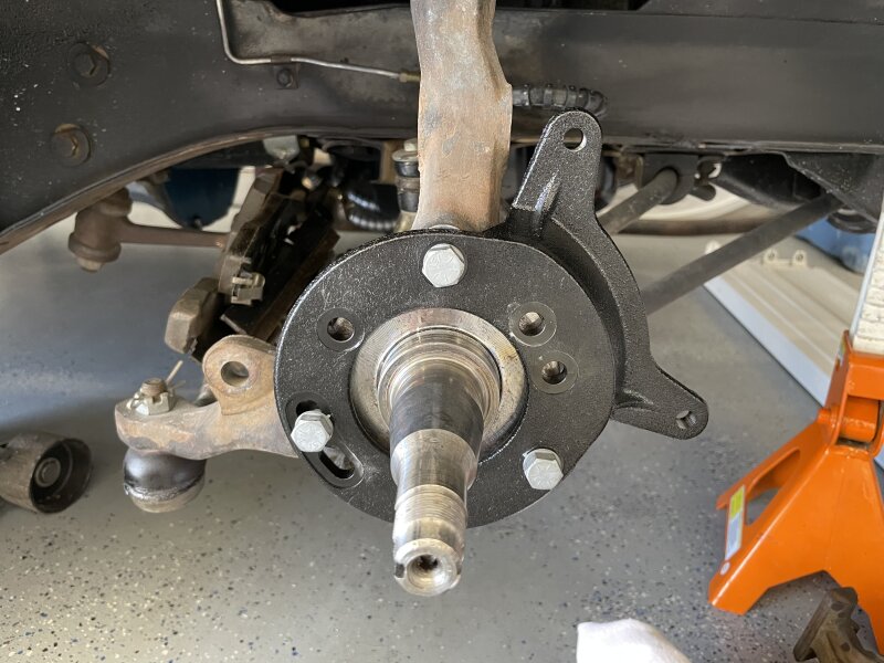

I installed a Wilwood kit on my 68 with drum brake spindles. The kit was a direct bolt on with the drum brake spindles. The same kit can also be installed on disc brake spindles-however the disc brake spindles need specific machine work to be modified to work. I suggest you read Wilwood’s assembly instructions before ordering as they detail the required work. Not sure I would modify a set of stock disc brake spindles in case I wanted to go back to a stock setup. Might be worth finding a drum brake set of spindles.

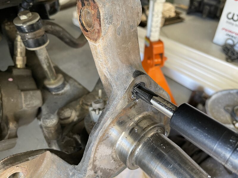

Its only a drill and tapping a couple holes for the caliper bracket. No need for a machine shop. OEM spindles have been harder to come by lately even drum spindles. Not a bad idea to save your original disc spindles unmodified just in case there ever was a need for them. There are a couple places that make aftermarket spindles that might be an option to. Either way if you have a drill and a set of taps its an easy install with no machine shop needed.
tapping the holes for the factory dust cover to fit the caliper bracket
bracket mounting, same bracket if using drum spindles just use different holes
I used a 70mustang kit since my wheel bearings are larger with the Granada spindles on my car. Everything else is identical to the 68 cougar/mustang kit however
What kit # is that??
Im running a 70mustang kit due to my specific spindles on my car so my kit wont be the same as you need. This is what you need for a 68 cougar with factory disc brakes. Note several numbers based on rotor type(drilled or non) and caliper color. Price varies based on options so be mindful, I found the best price from from summit racing. You get everything you need too, brake lines, new bearings, seals etc.

Looking at the disc spindle conversion… Do you REALLY want to put your entire front brake system on two 3/8" bolts??? Yes I see that there are three, but one is a slotted hole and isn’t gonna hold shite when you hit the binders in an emergency, if the other two bolts shear off. Yes, they appear to use grade 8 bolts, but they can break more easily in “shear” vs clamp…need to look up strength “in shear”… (MSC .com would have this info listed in their catalogs)
Factory disc brake calipers are held in place with single grade 8, 7/16" and 1/2" bolts physically held in place in a bracket preventing them from rotating by design and then again physically by the design of the smaller caliper bracket. Even if the two smaller caliper bolts (the slider “pins”) managed to break the caliper would only be able to push up and out (think what it takes to get your caliper off…) and it would hit the rim, at least with stock wheels, before it went into hyperspace.
I don’t want to think of what would happen if you managed to bust the three bolts in this design. Would not be pretty.
If doing the disc swap, I would strongly recommend using the drum spindles and the 4 bolt design, as was used in 1967. Hopefully the bolt holes will line up with NON slotted holes.
