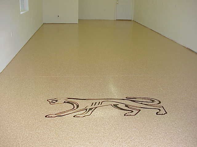

I had a Cougar Logo put down on the floor and then clear coated over it. Looks great.
That looks great!
I did the epoxy with the paint chips too. Yes it had discolored a bit in places but I would do it again as well.
