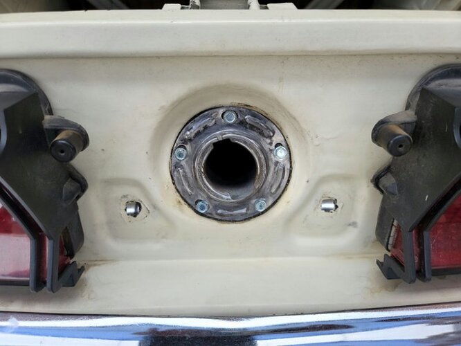

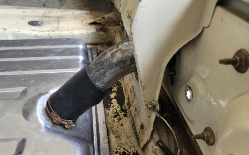

I got everything to line up OK between my 22 gallon tank and 69 filler neck. No cutting.
Thanks sfhess! That is good to hear! Hopefully I can drop in the new tank tomorrow and see if I can get close.
I just want to be functional.
I think you can make it work, please report back with your results!
I just made a deal to buy a '70 low fuel sender core that is correct for '79 Eliminator or XR7. The 22 gallon tank requires a unique sender.
Good afternoon … Thank you for the info xr7g428. I actually had a sender rebuilt by you through Scott, at Taylor Restorations. It works great!

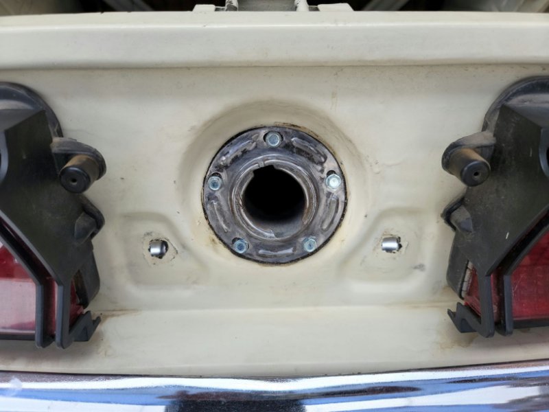

The filler neck worked out. It is not perfect, but functional, and almost looks the part. Thanks for the comments and assistance.
