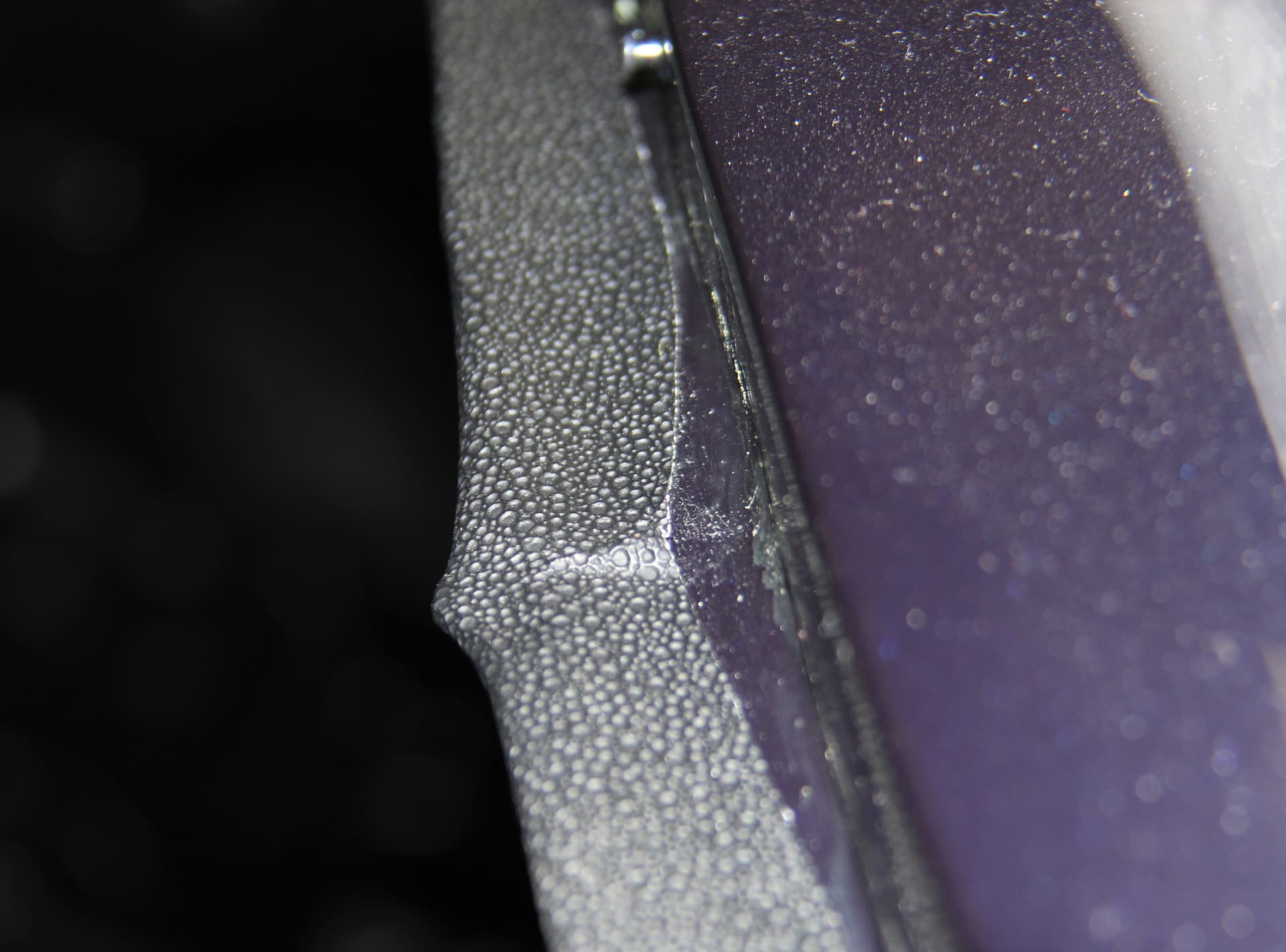

The windshield is in but the gap between the trim and the glass in the top corners sucks. I think the glass has too much curve in the top corners. The trim fit perfect to the car all around and is tight across the top except for about 3 inches in each corner. The side trim tapers from a 1/4 gap from the window on the top corner to flush at the bottom. I cannot imagine that is normal but if the corners were high enough to contact the trim the top center of the windshield would bulge out a 1/4 inch.
