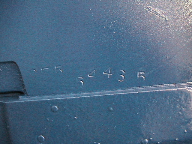

What would be the location of the VIN on the head?

The VIN on the head can be seen using a digital camera or smart phone camera held beol the brake booster, facing forward. Take a flash photo, then look at it on the phone or computer.
Not every car was stamped with a VIN, so it is likely a 50/50 chance it is (or was ever) there. You have to remove a valve cover to see the date code on the heads. For a March built 390 it would likely be 2 weeks - 60 days prior to the build date of the car.

Not every block , but every engine assembly, was mandated by Federal Law to have a VIN stamp on it starting January 1st 1968. Earlier cars might have the stamping but those are the ones that are iffy.
My experience, and others may vary, is that the back side of the head on the drivers side of the car is the most common location, but I have seen the block stamped just below the head in the in the same area. The stamping was done by hand and it will be faint and crocked and probably be partially filled with paint. IF the engine has been apart they heads can be swapped from side to side so sometimes you fined the stamping on the front of the passenger side head. Remember this is a partial VIN not the complete version. The key part is the sequence number starting with a 5XXXXX.

Here is the vin# off of my G on the back of the cyl head for reference.
