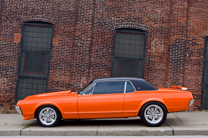

Love the stance on Mark’s. Lowered but still has rake, and no squatting rear. I went old school and added a leaf to the rears. No squatting, hooks up better, but also raises the center of gravity. Have tried to compensate a little w/ bigger sway bars, which helps, but lowered will help in the handling dept. Take some shots of stances you like, and ask questions. Bottom line: it’s your car so build it how you want. My opinion on how your ride ends up has very little weight if you build it how you want.

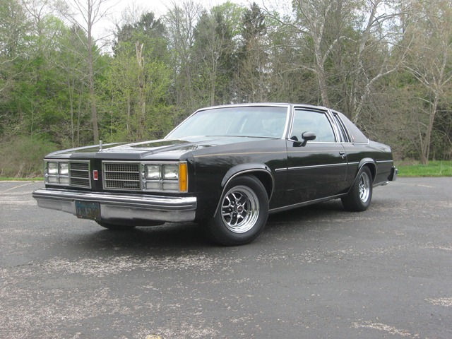

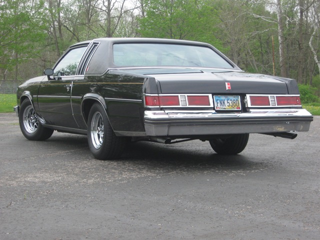

This is the current daily driver, a 78 Olds Delta 88. The car suffered the infamous full sized GM broken front coil spring when I got it. Knowing that brand new springs was going to put the nose in the clouds, I cut a coil here too but left the rear alone. It runs the same size tires all around showing that you don’t always need a rubber rake to get a decent stance.

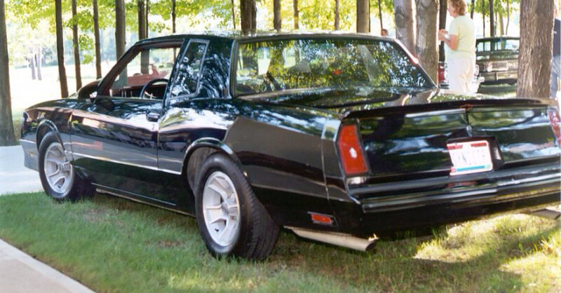

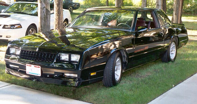

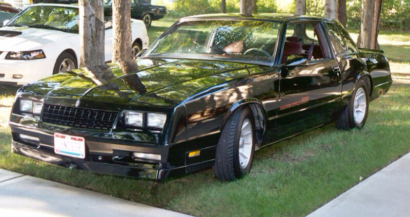

Lastly, this is my sister’s Monte Carlo. It’s had a coil cut all around and the same size tires all around. This is actually a Monte SS and she hit a fence post and caved in the rear quarter panel. Upon fixing it we decided to remove the rainbow stripes for a more subtle look.
