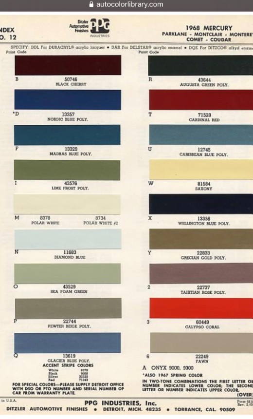

Grecian gold colored paint
I can’t find this exact color anywhere in the auto parts store or on Amazon.
What other types of paint or color codes are identical to this?
Is there a general motors color that matches this exactly?
(You can get anything for GM vehicles)
Either a spray can or just liquid paint in a jar is fine.
I’m willing to purchase an airbrush if necessary.
I have 3 areas that need to be touched up on the side of the vehicle.

Here you go for paint code Y.
Ford
M3073
PPG
22833
Dupont
4874L, 4874, 8474D
ACME
5454
BASF
A1951, E1951D
Martin
1756
Shermin Williams
3064
It’s different from any generic motors color. Even different brands or batches of the same brand are different from each other.
If you are trying to match something on a car, have it color scanned at any good automotive paint store. Otherwise anything that you do won’t match.
