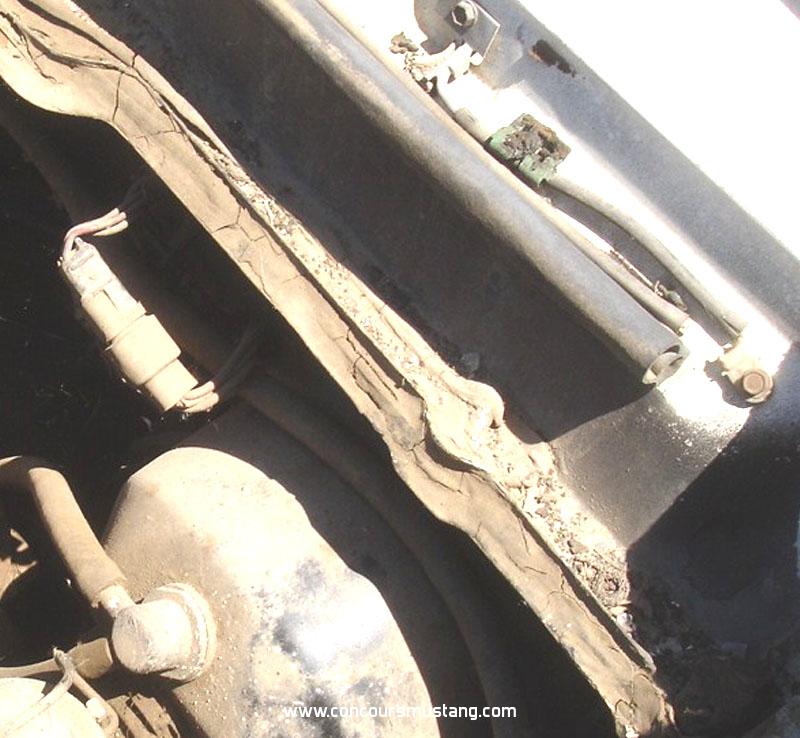

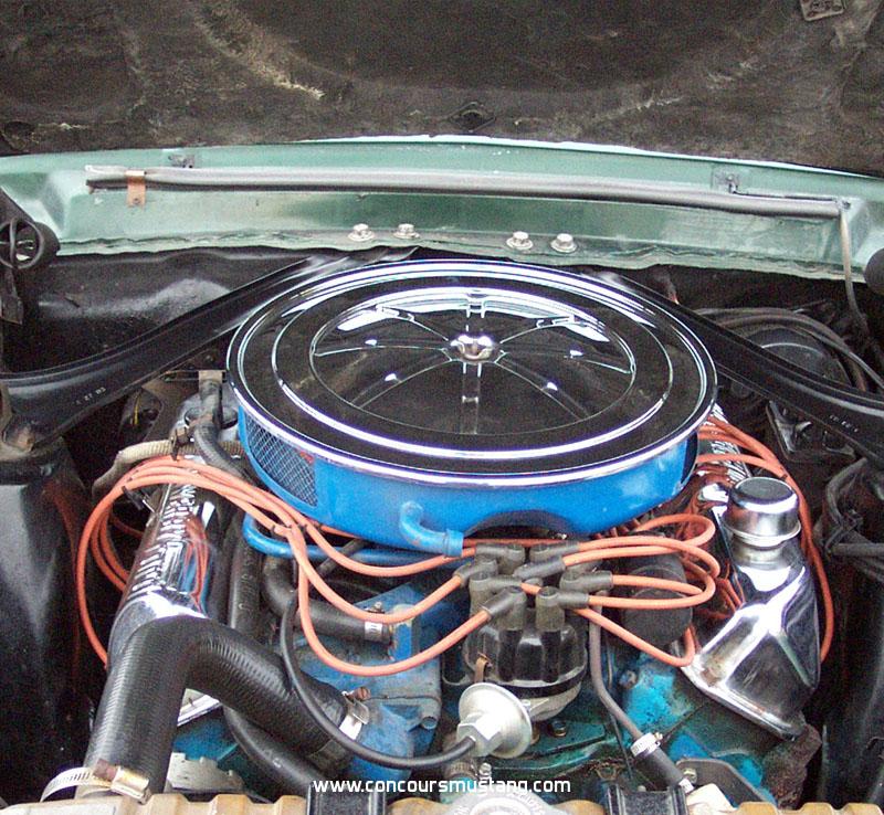

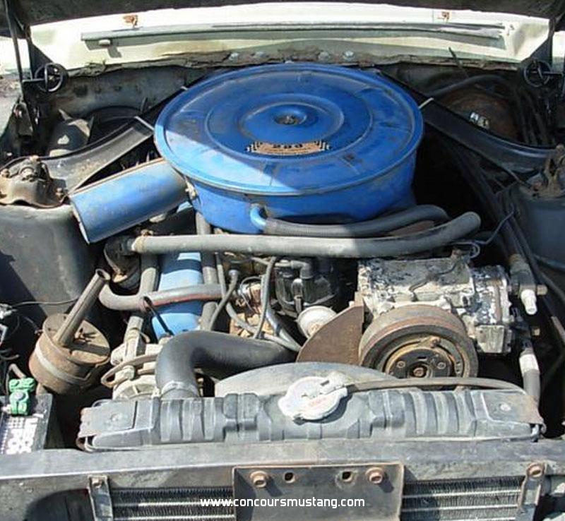

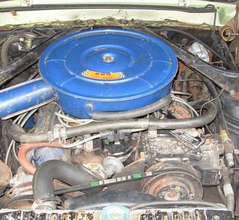

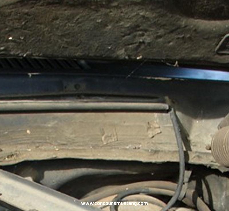

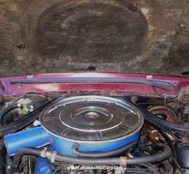

Have pictures of three dozen all with a single ground strap. Top of the cowl is shared with Mustangs and Shelbys and those also have the divot as if some engineer wanted or they planned on maybe doign two but it appears to me that it didn’t make it to regular production for the full year. If you provide when your car was built we can focus just on that specific period of time since things can change during the production year. We see it all the time
No particular order
example -1
example -2
example -3
example -4
example -5
example 6
example 7 Close up - Hole unused just dimple in metal
Hope this helps 0

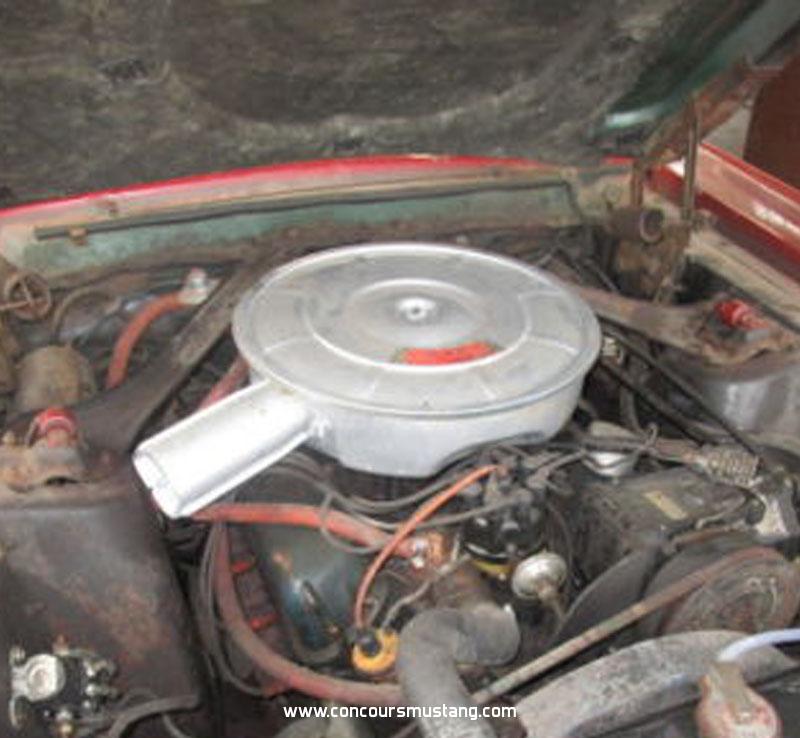

Here is an example likely built a couple of weeks before your car. Just dimple like the others so not drivers side hood ground on this one either
And this one likely built after yours at Dearborn.

Is it just me or does that distributor look like it is way off on that 390 car in example #4 post 5?
Does look like it’s missing the shield the protects the distributor and has a closed emissions air cleaner base but no PVC hose connected to the oil cap and the plug wires are not correct but beyond that cap itself doesn’t look that off but never have really noticed them much. Others might be able to point to what is wrong with the one used as does seem a tad off.
As far as the pictures I posted go please understand that none of them were posted as examples of how the cars were originally delivered or should be used for any purpose other than the subject being discussed here in this thread. PLENTY of prior owner changes and choices in most of them.
