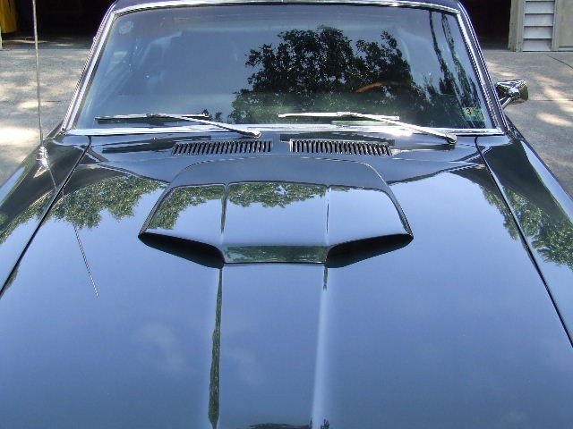

If this is the wrong section for posting please let me know but what is the difference between the two scoops?
And
What is the measurement between the scoop openings (inlets) on the front of the scoop?
Thanks

GTE does not have the vertical bars in the openings

Anyone on the measurement as identified on the photo above?

I can get the measurements for both scoops later this evening.

The measurement in question is 8 3/4” for both.

Thanks Steven. Just so I am clear the middle section is 8.75" on both of the styled scoops?
Yes that’s correct.
