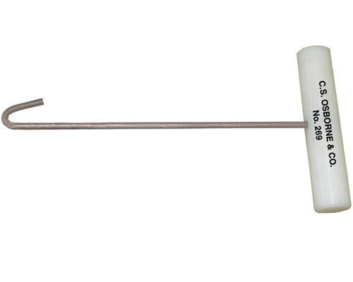

T-handle tool used for pulling dents works well to pull headlight springs.
Did you assemble the light and ring and than put it I the housing
There is a special tool made to attach the retaining spring. First put the bulb in place. Put the retaining ring in place and install the 2 screws. Then use the special tool to attach the spring to the retaining ring. Very easy.
I put the spring in place in the housing and in the hole in the ring, pull on the spring and put the screws in.
The tool looks like this:

One of these is easier to use:
A hook like from this set can be handy for pulling those headlight springs:
https://www.harborfreight.com/mini-pick-and-hook-set-63697.htmlOne of these is easier to use:
Thank you, I got two on using wire and pliers (that is what I had) but I know that tool would be a lot easier
