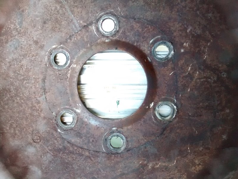

I removed the spacer plate from the motor from eBay (351cleveland 4v cobra jet) because it was all bent up. When I took the fly wheel off to exchange them from my original 2v motor I noticed the flywheel from the eBay 4v CJ has a slight bend to it. I would like to use the new one I bought for the 2v Cleveland. Can I do that and if so do I have to use the new harmonic balancer I also have on the 2v cleveland also (which I’d like to because it so easy to read)
And does it matter that I have a FMX tranny? All the ones I see is for a C6 tranny. If so why what’s the difference between an FMX flexplate and a C6 flexplate?

You need the FMX flexplate.

Thanks for the info. I went to the web site you gave me and purchased a flexplate for 72-73 351 CJ but it never said what tranny it’s for. Hope it works on the FMX transmission. How will I know if it’s going to work or not?
All M and Q (CJ) code 351C-4V engines came from the factory with a C6 transmissions unless it was a 4 speed manual.
