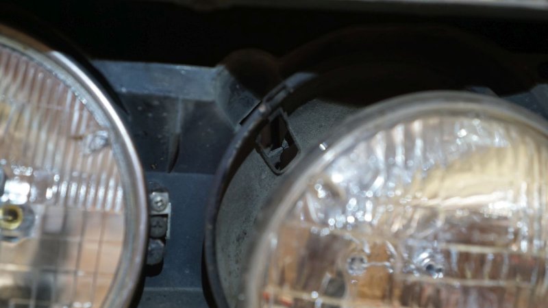

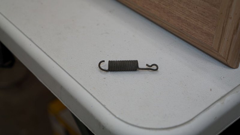

Started the process of making my '68 grill straight. The passenger high-beam was missing its retaining spring. Very thankful to find it wedged at the bottom of the bucket. The mounting point on the bucket is split. I am going to pin or shim it but am looking for advice from others that may have fixed this before.

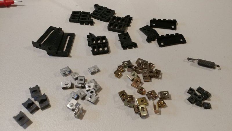

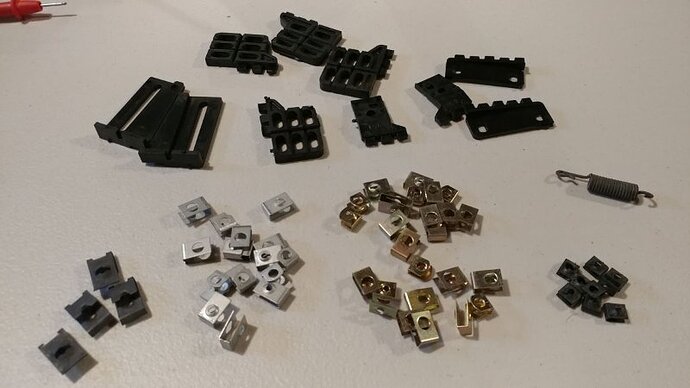

I have drawers full of hardware as I did a lot of car audio installations in my youth. Might get lucky.

Here’s my assortment of U-Shaped speed clips. Installed lots of speakers back in the day. lol Just looped one through the spring hook and secured the headlight. Installed the bump stop kit that aligns the headlight eyelids. Came across some plastic stock and used it as a wedge to help straighten out the front grill end pieces.
I just bent a washer in half and slid it over the broken part. Then I hooked the spring over the washer.
