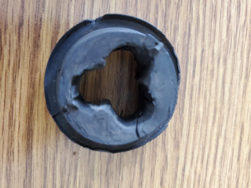

First, i’m not the first guy in here…look at this
it was not attached to the hoses like the replacement set, also was in the car backwards, i.e. wide part in the engine compartment.
