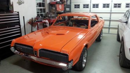

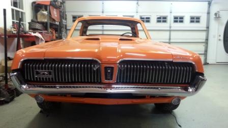

Sorry, no pics of the back of the headlight doors after reassembly :wall: and the grille is already installed. Use the epoxy sparingly, it wont take much on each post (one drop). Since the posts are about half the size of the hole, the epoxy will sag into the void and fill the space. Too much and it may run out the front.
I see a future ROTM in these pictures! Who knew that an orange car could look so baddass!
Thanks Grant. I am very happy with it so far. The color is Dupont “Orange Crush”. I had already settled on the color when I spotted another beautiful orange cougar (Local Hero) prowling Classiccougarcommunity.com! That sealed the deal and the car was sprayed.
