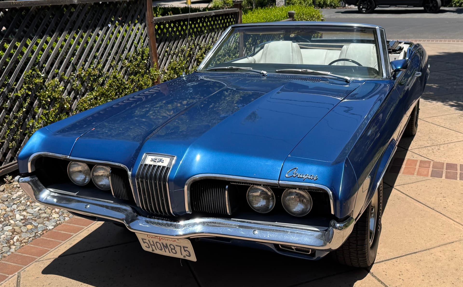

Headlight doors come up. Replace vacuum headlight door actuator, or do electric conversion?
My 1970 Cougar XR-7 convertible is afflicted with slow leaking headlight doors drifting up.

The photo tells me what I would do, and that is go electric so that gorgeous grill looks right. Other opinions and your preferences may vary. Pretty car by the way!
