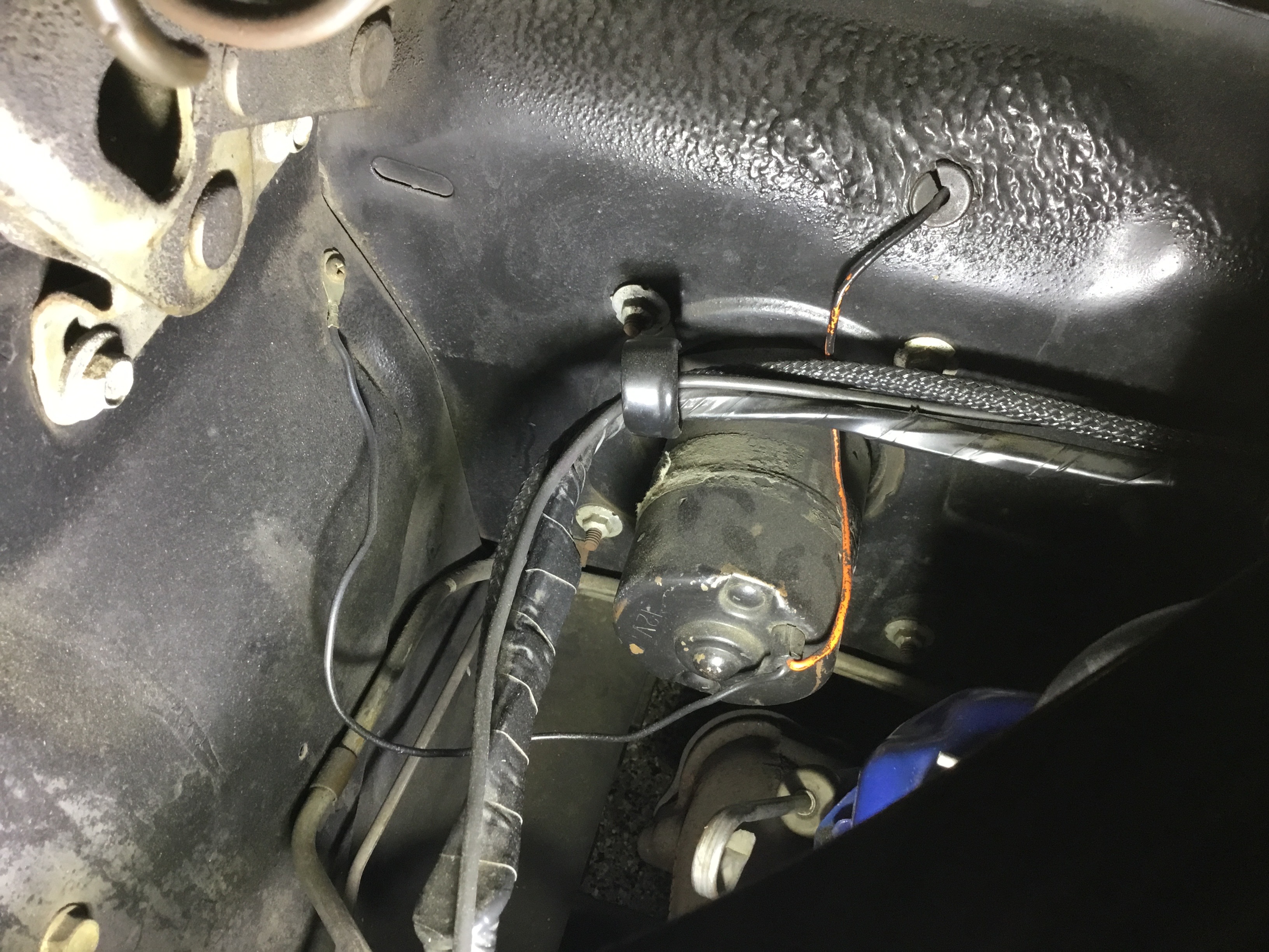

Does anyone know where the Orange wire one the back of the blower motor goes to? My wire is missing the connector on the end.

Most likely the wire color is revevsed. Black is not ground. Test before using. The fan will spin backwards. Orange will be ground to the firewall.
Both wires go through the firewall to the heater blower resistor.

I went out to look under the hood, the black wire must be the ground, I see it is already screwed to the fender apron by the firewall, I will run the Orange wire to the blower resistor and see if that works.
The blower motor resistor is under the glove box door mounted to the heater. Neither of the wires should go to ground.
That’s correct for the 70 as well. Orange goes through firewall to blower resistor and black goes to ground on the fender apron.

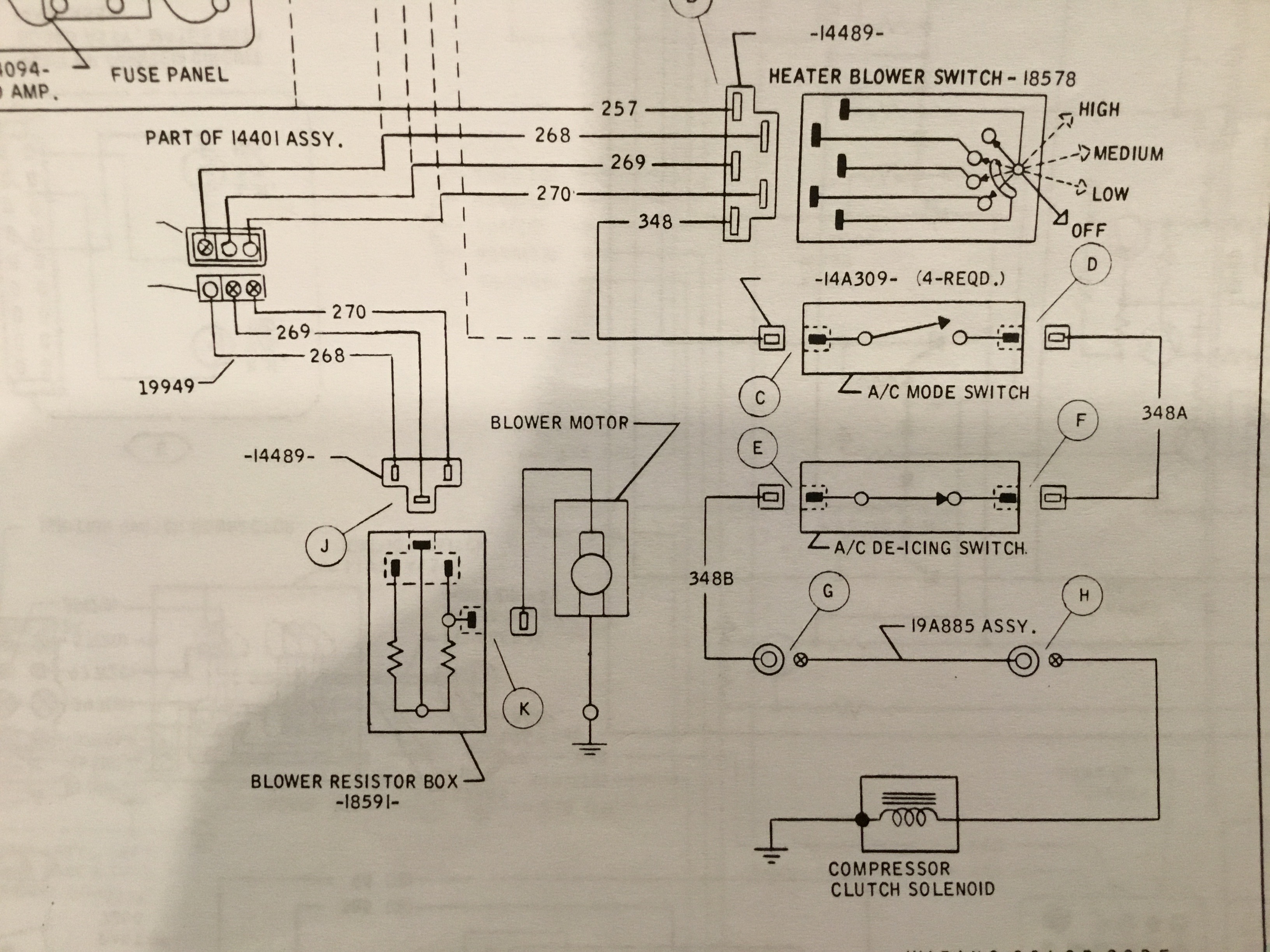

Great pic showing the ground lug. Cut it off the old motor, use both wires.
Do check new motors rotation! They will move air going backwards and can fool ya.
Cool, my car looks just like the picture, Thanks so much!!!

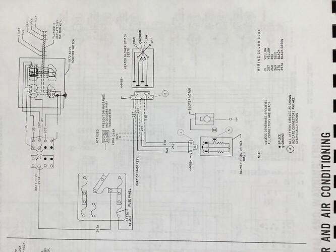

I guess I am confused - the schematic posted shows the icing switch and the AC compressor.
Royce, Its easy for us ol farts to get confused !!
That was my bad - here is the correct schematic for non-AC cars in 1970:
