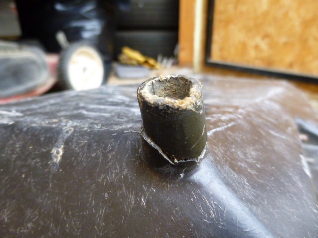

I am repairing the heater plenum in my 69 (with AC) and I cannot find the Outside Diameter of the drain tube and exact lenght. I believe someone mentioned a tube lenght of 5/8 to 3/4 but I need the actual lenght. I have rebuilt the drain with a brass nipple and fiberglass and want to find out how far to build it up and where to cut for correct lenght. Any input would be great.

Ok, here you go. The diameter of the drain tube is 5/8"
The length of the tube from the heater/ac box is .75 to .85

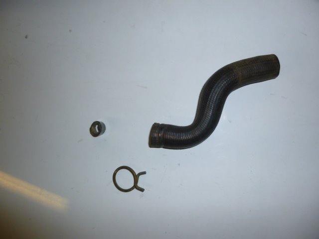

The overall length of the hose is 5" If going original, the hose has a small restrictor in the end of it
Since the tube is located at the corner of the box it is hard to have an exact measurement.
The measurements I gave here are the high and lowest points.
Trixie and Tom, thank you for the info. Looks like I can wrap one more layer of mesh and be pretty close to the 5/8" diameter. I will be orderin a hose from WCCC.
