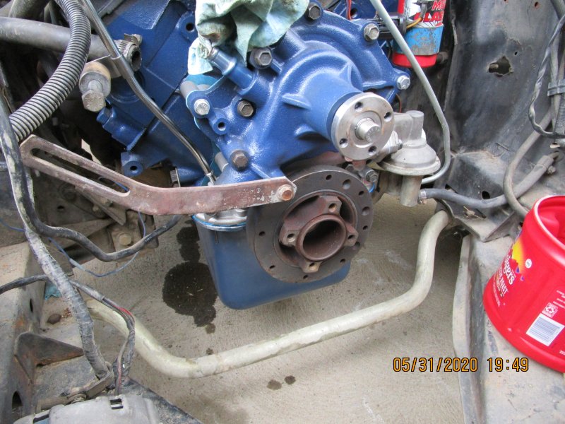

A friend of mine came over from work last night, and basically pulled the motor out of my 68 for me. Young guy, and motivated. I miss having that much energy! Anyway, I thought I had my new, used donor motor ready to go, but I am hung up for a crank pulley, for a V belt, with 4 bolts for the crank dampener. The one that came out of the car is only a 3 bolt. Is it better to buy a 3/4 bolt balancer, or try and find a V belt pulley and a 4 bolt center? I thought we were going to hear it run again today, but it isn’t looking good.

I would stick to the oe 3 bolt balancer myself as then eve4y thing will just bolt up knowing what you take off is what you put back on.
Other wise you just chase your tail with things like the pulleys etc etc …just my opinion .

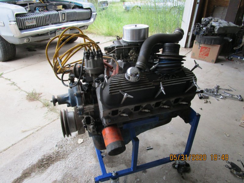

So, quick update- we got the old motor out, and new motor in, and did hear it run. Knowing a younger guy with some actual drive to get anything accomplished and having the stupid electric tools is a tremendous help!
The 93 5.0 went it pretty painlessly. I bought a new clutch and flywheel from rock auto last year for the build. The only problem is now the spacing for the pulley set up. So today I ordered a .350 spacer from Jeg’s, and it is on the way. I also found a reasonably priced water inlet for the intake manifold! So, if everything comes in soon, I will have the engine buttoned up by the weekend!

With the spacer, the 2 sheave pulley is out past the alternator pulley. the other 4 sheave that I have that is a 4 bolt, lines up on the closest sheave, but is a LOT shorter than the combo on the three bolt assy.
That is a 6 3/4 diameter, and 3 inch deep 2 sheave. I will check the usual spots for something in a 4 bolt that matches that description.
