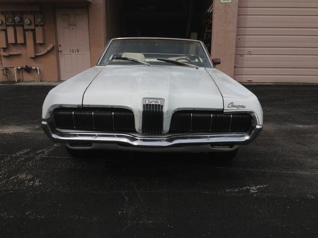

I am the proud owner of a 1970 Cougar Convertible . Upon first inspection its in pretty good shape considering. No rust! It looks like most of the car is original has not been tampered with in recent history.

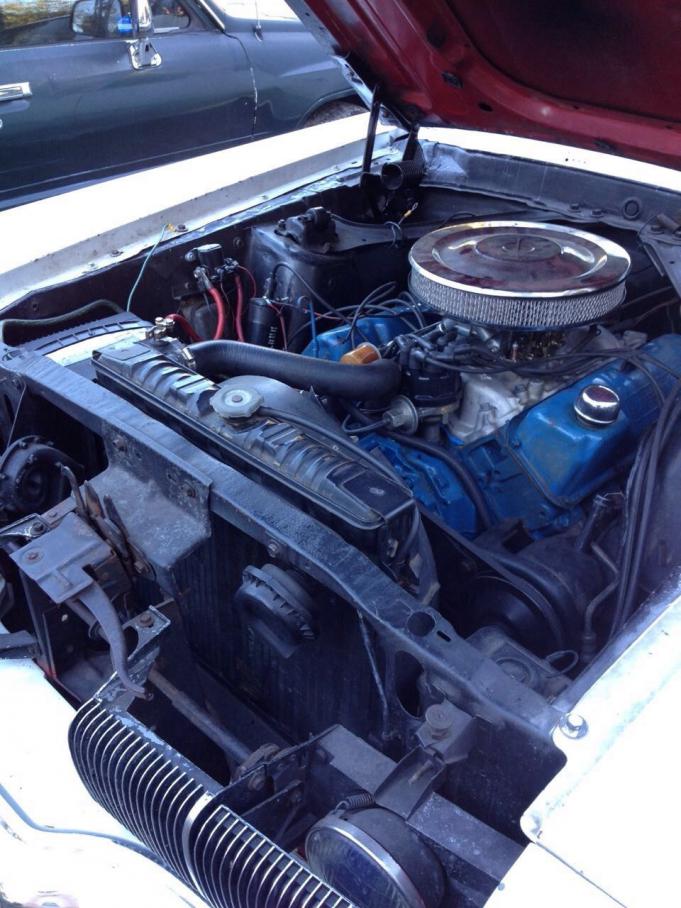

The car has a new exhaust, intake manifold and Holly carb. The interior is pretty rough though. I plan to replace the front and rear seats, new carpet and underlay, convertible top and most of the center console, instrument cluster and dash.
I picked this car up for 4000 USD and am willing to invest about that or maybe a little more. I would like to keep the total investment around 10K-15K.
Aside from some bodywork, paint and the previously mentioned repairs, what can i do to the vehicle in terms of restoration that would help the resale value down the line? Someone said i should put a 428 CJ under the hood or try to clone a Eliminator. That would be nice but that much power would need some performance handling upgrades and my budget will be blown to outer space… Anyone with parts please feel free to contact me.
I love this car and cant wait to get going on this project. I would appreciate any comments or suggestions on how i can bring this cat back to life and still maintain the integrity of the vehicle. Thanks in advance!
A 351 C 4v makes great power, mabye an updated cam and a few other tweeks to the engine. Is the cat a H code 351 C 2V or a M code 4V car (5th digit in the vin) even a 351 2v makes nice power with a few mods. To buy and install a 428CJ would use about all the money you want to spend on the car. Interiors are not cheap on the Cougars .
No need to replace the 351C. They are great engines. The Eliminator clone thing is overdone and will add zero value. I’d concentrate on the basics like making sure everything works as it should, replacing the trim and the top if necessary. That $6K you have budgeted is going to go quick unless you are doing everything yourself and are very resourseful. Good quality materials for paint and body will run over $2K as will the interior and complete top replacement will be close to $1K. Replacing exterior trim will run more than $1K and there goes your budget without even addressing mechanical issues or things like tires and wheels.
Thanks for the reply. I found out that it was a 351 2v H Code. I was mistaken. Seeing that its a standard model and apparently has been painted white over the original factory red, a strip and paint job may be cost prohibitive. I will focus my attention on the interior and basic interior functions. I’m beginning to see that this will be a labor of love and we should enjoy the ride.

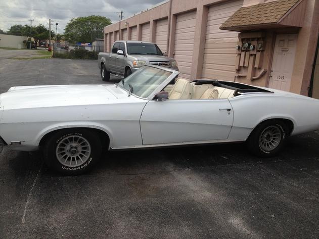

Tires - don’t drive on old cracked rubber. So that will cost you another $400-$500 for new BFG’s like you have now. Wheels aren’t necessarily a NEED - the vintage turbine wheels look cool (to me) :slight_smile:

I would definitely take a stab at buffing out the paint. There are some good polish products out there like the System One x3 compound that will do wonders to a worn and weathered paint job. White is a good color to start with also.
Thats a great looking car that you own!
Thanks for all the great comments… These are great ideas for buffing out the paint and restoring the chrome. The previous owner was quite organized and there’s a great deal of old goodies, emblems and spare parts in the trunk. I just ordered new carpet, underlay, white convertible top, and a full interior upholstery white repro kit. During this we will need to restore the instrument cluster and some interior electronics, service the convertible top motors and lots of cleaning!
I think that down the line the white interior and top will go great with the fire red or competition orange paint job. i guess the red and white would be more true to original. I’m getting excited now, seems like i will have some late nights in the shop!
