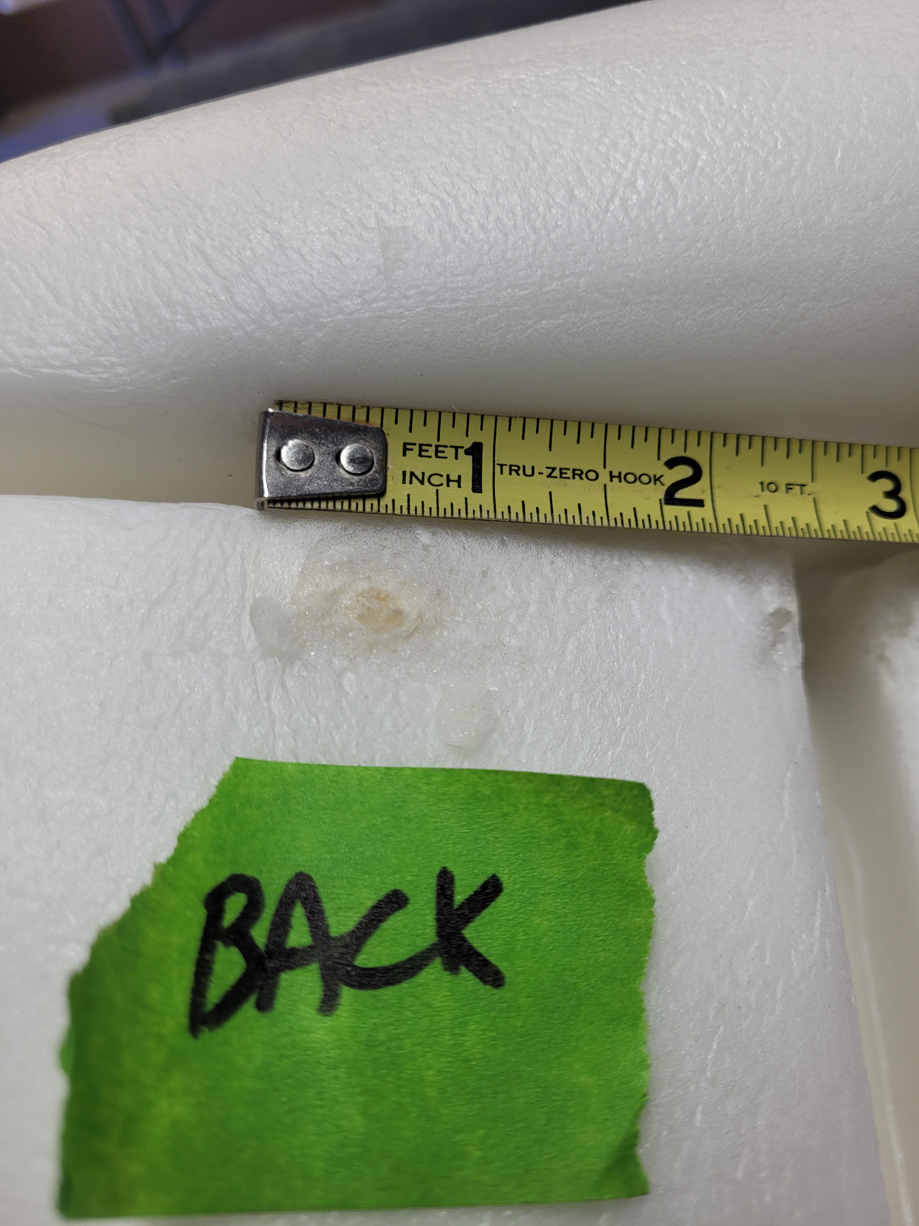

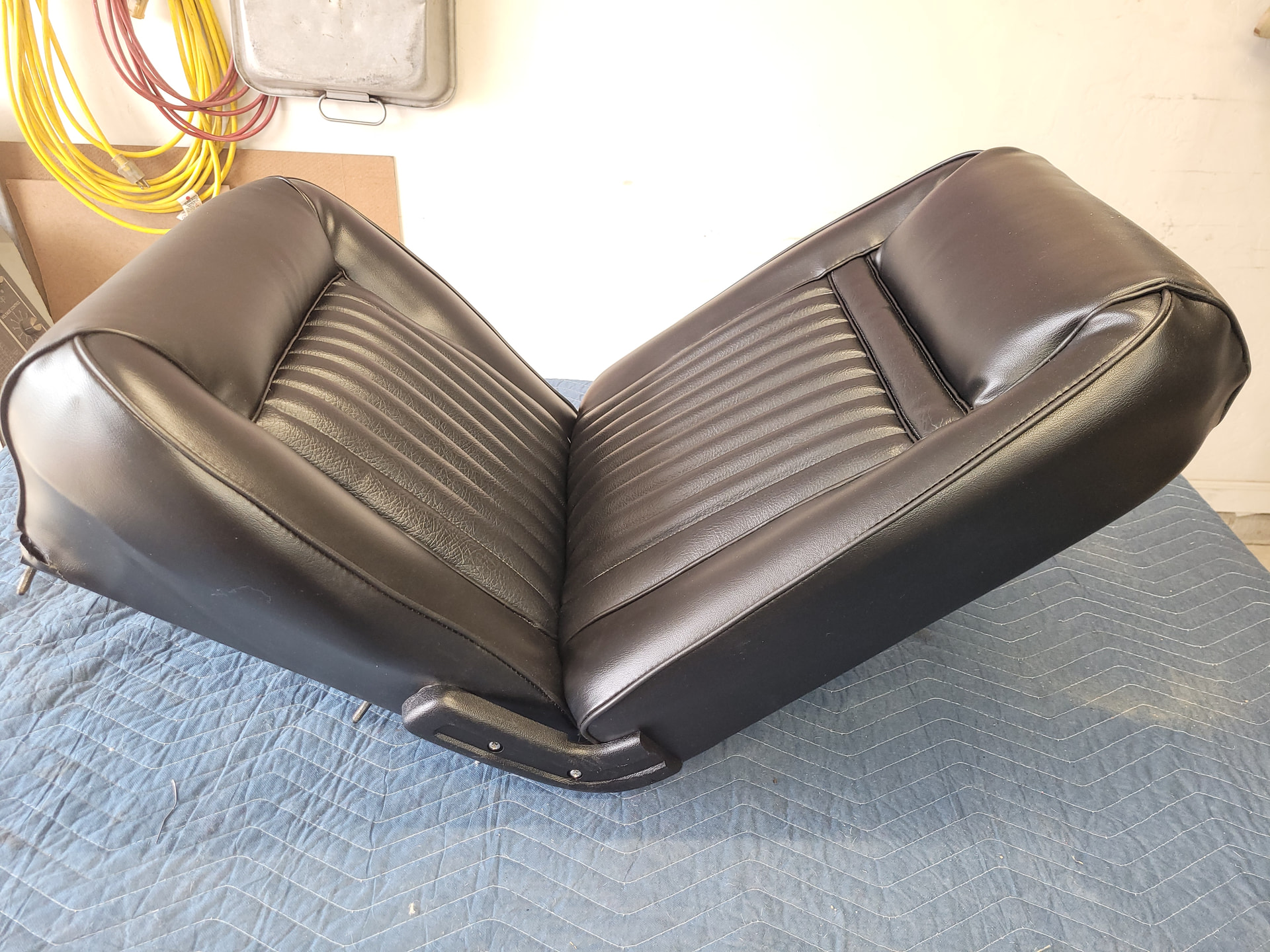

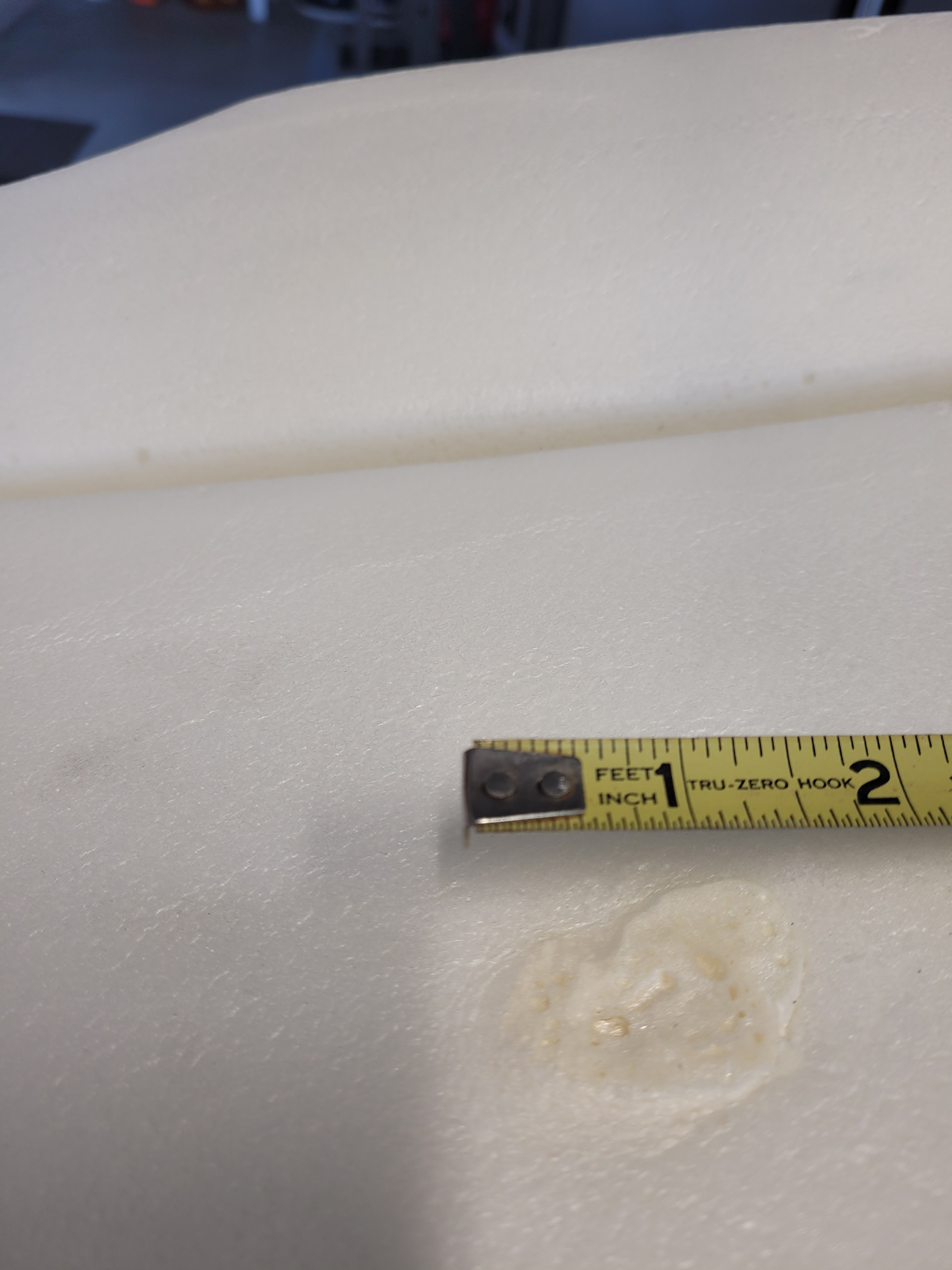

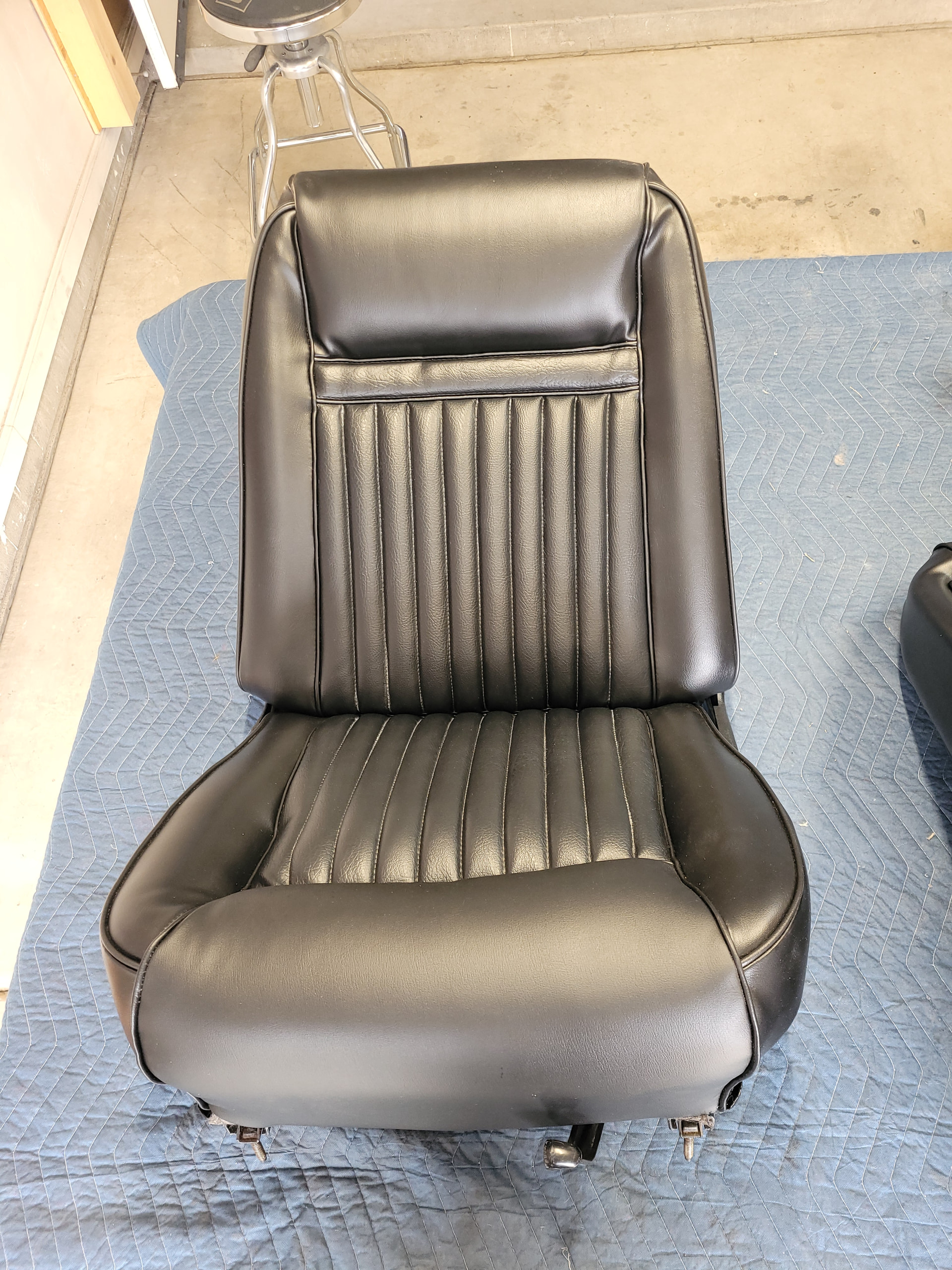

A bit of an old thread but I’ll share my recent experience with Mustang Market in case you’re still in decision phase.
Purchased two bucket foam sets for my 67 decore (I actually used 68 vinyl - pattern matches my 68 rear seat I acquired locally).
Overall am happy with the product but others may not be:
