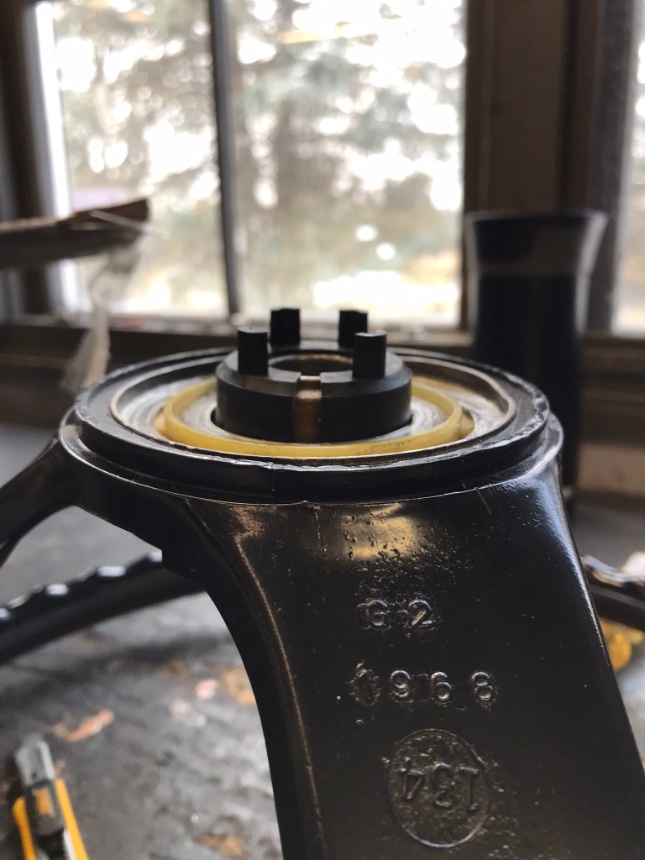

Guys, this is a problem driving me nuts! it’s with the “new” rim-blow steering wheel. The car is a ‘69 XL, but let’s pretend it’s a ‘69 Cougar for the moment.
The issue I have is that the shank on the rim-blow is too tall and the contact pins on the column stand too far away to contact the rings on the back of the steering wheel. I did buy the turn signal cam from WCCC and it fits perfectly on my rim-blow so that is not the problem. Btw, this car is a cruise control tilt column.
Could I be missing an adapter or something??
Thanks for all responses! I try to attach 2 pictures.

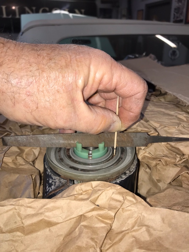

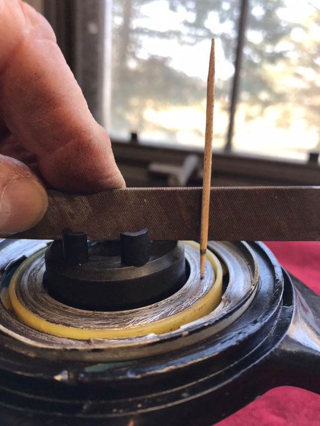

I put the car back in storage, but yes the shank of the rim-blow is approximately 1/4” taller, maybe less, than the cruise control wheel.

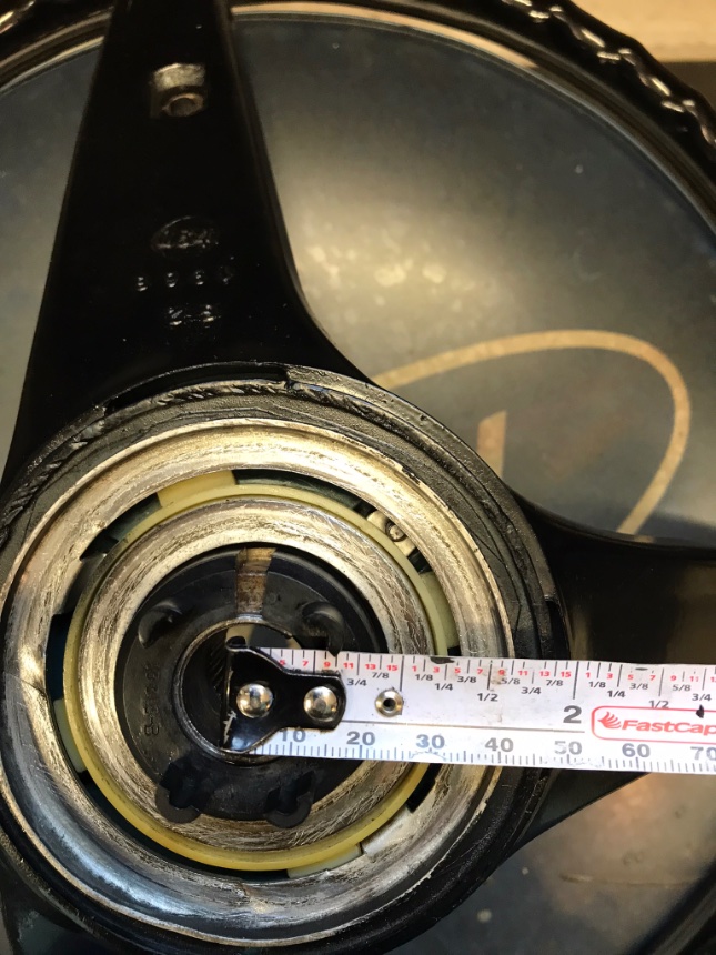

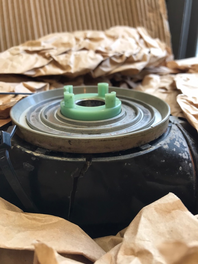

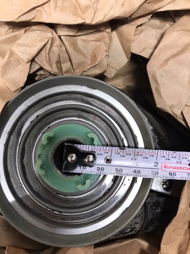

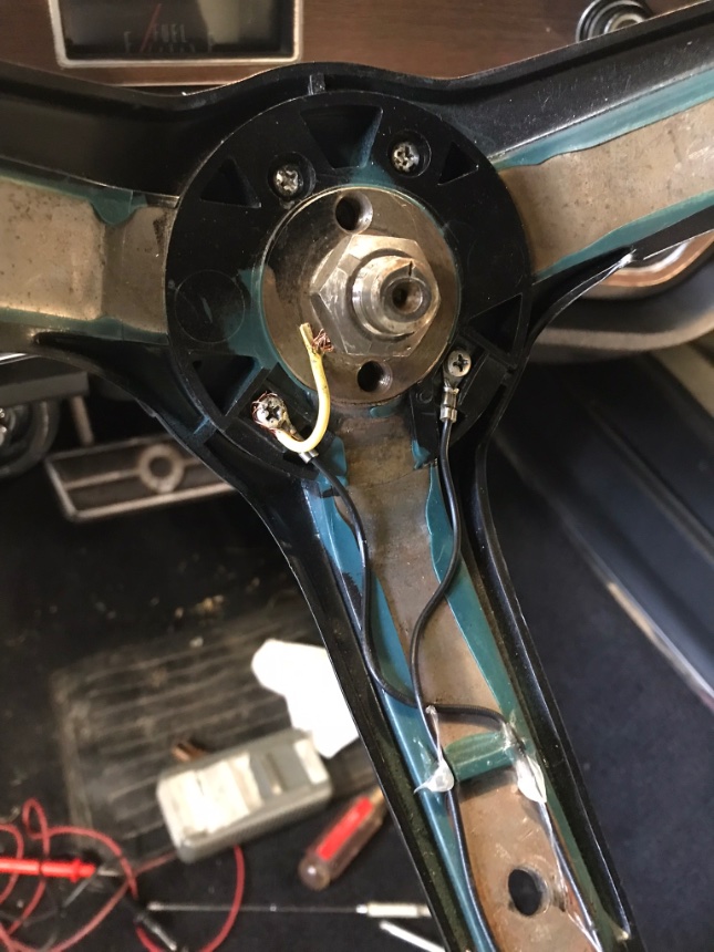

Hi Bill, here are some closeup shots of the back of my two steering wheels indicating the different dimensions. I, for the life of me, cannot figure out why my rim-blow does not work! Any help would be appreciated. The green cam is from the cruise control who and the black cam is the rim-blow.
Guys, I’ve done all the testing I could think of and reached the conclusion that there is some ground wiring issue inside the turn signal switch. Rather than replace it, I just ran a wire from the ground post to the steering wheel to the steering rod. Yes, it’s ugly and I’ll replace these with proper eyelets, but my rim-blow works perfectly. Any danger in doing this? Other thoughts?
