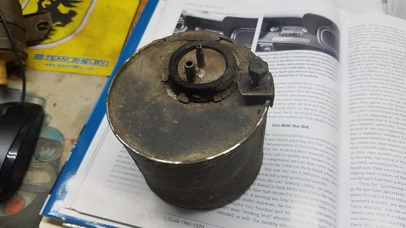

Did research here and trying to confirm. This is for a 1969 Shelby GT350. Here is a picture of the worn vacuum can under my battery tray. Everything I have read says 1969 is single nipple can but this one is two. There also is only one vacuum line going to it that I can trace.
Your expertise is appreciated. I want to get this working again. I have had the car for 28 years and it has never worked.

But I am confused. I am sure there was not a difference between the mustangs and the cougars. All the mustang suppliers talk about double nipple cans for 69’s and single nipple for 67 and 68. I believe your shop to be the global experts. I just want to get the right thing for my 69 GT350
Hi, Don’t know if this will help you or not. On my 1969 Cougar XR7, I have max vacuum options. Tilt Wheel, Speed Control, AC, Power Brakes.
My car came with the standard 2 port canister, located under the passenger side fender behind the hood hinge and the single port canister
located under the battery tray on the passenger side. As far as I know, the single port canister is the one called out for the '67/'68 model year.
I know, it is confusing to figure out. Good Luck.
