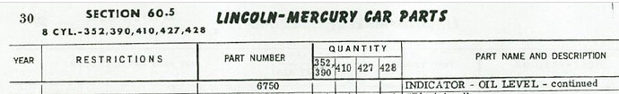

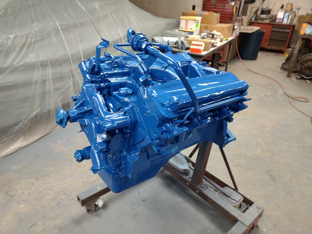

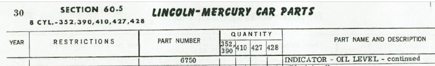

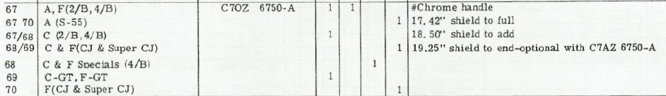

My Hertz G project currently has a very rusted dip stick which used to be chrome. Has C7OE-6750-A stamped on it. There are no guarantees that it was original. Since I need to shop for a new one it would be nice if get the correct one for a Hertz G. So Chrome or Ford Blue on the Hertz G’s ?
All Gs had the engine dressup kit. It was slightly different than regular Cougars, but a chrome engine oil dipstick was included.

I would say so also. The 1968 S code 390 GT Performance Group Option (which Hertz Gs started out with) included the chrome dress up kit with, among other things, a chrome engine oil dipstick handle.

More to clarify the issue - 390GT engines NOT installed in an XR7-G would get a chrome air cleaner lid. This is not to be confused with the engine compartment dress up kit. I think the engine compartment dress up kit was mostly an option for the 289 or 302 in 1968 model year because it included chromed valve covers, chrome air cleaner lid, chrome master cylinder cap, a chromed dipstick handle and a chromed radiator cap.
If you ordered such an option for either the 428CJ or the 390GT it would not make sense because those engines already came with a chromed set of valve covers and a chromed dipstick handle. So far as I know that was not the case on any XR7-G that I have seen a Marti Report on.

Thanks for the clarification. Chrome it was, chrome it shall be again. Going to be a while as I cannot find any in stock anywhere.
