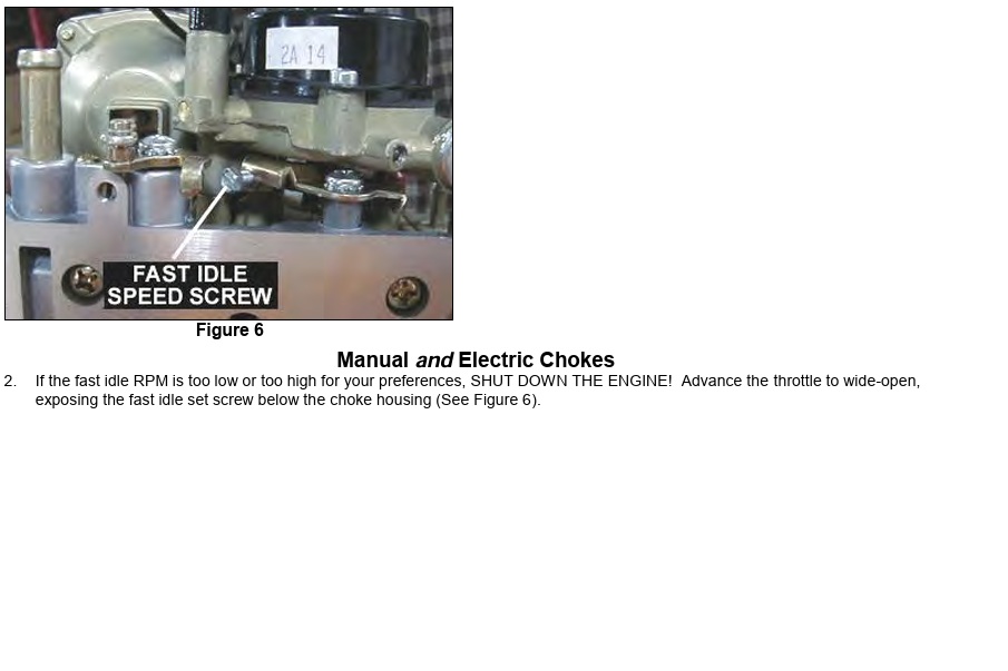

This is not a mixture screw and idle speed screw problem. It is an adjustment to the choke mechanism. Refer to the instructions on your carb.
The adjustment that Bill refers to is the fast idle adjustment screw. Normally on Holley carburetors it is accessed by removing the carburetor and turning it upside down.
I hope this is what Bill & Royce are referring to - it’s been awhile since I overhauled my last Holley 4150.
Yes, that is the one I suggested needed set for 1500-1800 RPM.
That’s it, the best way to get at it is to remove the carburetor from the engine and turn it over. .

Those are way easier to access, should be no need to pull the carb.
