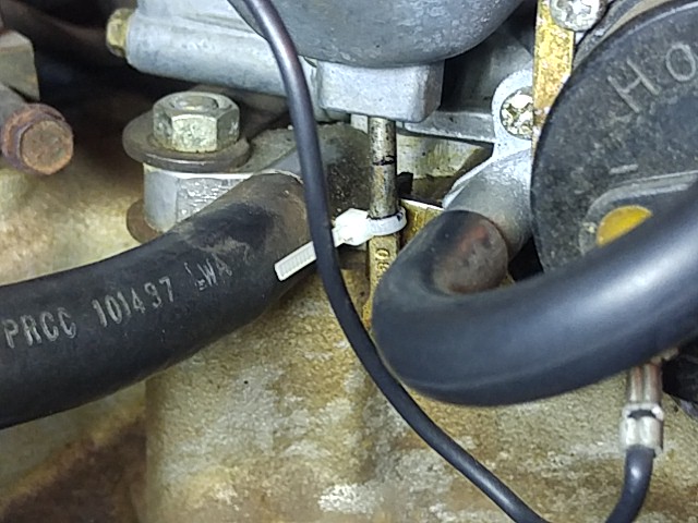

When I was looking at the carb last night I found a number of 11761 on it. I did a quick google search and it looks like this is a 600cfm carb with vacuum secondaries, my engine is a 351W by the way. I have been thinking the secondaries aren’t opening on the carb because I don’t hear that big rush of air like I do in my Jeep that has an Edelbrock 600cfm with vacuum secondaries when I go WOT. Last night when the car was running I manually opened the throttle to WOT and didn’t see the secondaries opening. Should i be able to see them opening or does the car have to be under a load? I can start a separate thread for this if that is preferred.
You might try lowering the float a little to help with the first problem, and the car should be under a load, if you hold the carb at WOT long enough for the secondaries to start opening you might damage something.
To verify proper operation of the secondaries, wrap a bread tie on the actuator rod just below the diaphragm, then go drive up an on-ramp or some other spot where you can safely run at wide open throttle for ten seconds or so. This video explains what you’re looking for: https://www.youtube.com/watch?v=kXUFwaWo_rQ
Thanks for the link, when I get a chance I will have to try this out and I can report what I come up with.
I had the car out last night and wrapped a zip tie around the actuator rod and did a few tests. The secondaries are opening, but I don’t think they are opening all the way. I did one test where I held it to the floor from a dead stop and it pushed the zip tie down pretty far, but I don’t think all the way. For the next test I was doing about 35mph and held it to the floor for about 5-6 seconds. After I got home from the second test I looked at the zip tie, it moved down some, but not much. I marked the top of the zip tie with a fine tip sharpie than manually opened the secondaries all the way and you can see the difference in the picture. I guess I need to find a softer spring for it to make the secondaries open more/quicker?
Holley used to sell a kit with several color coded springs. I swapped them out and ran the same 1/8th mile flat out to see what the difference was. When you go too soft it actually slows down. Once I had my full throttle response nailed I tried regular driving. Look for a bog when you tip into the throttle. The worst side effect I had was driving on the highway at say 3000 RPM. When the secondaries are open the gas mileage dropped like a rock. As in 6 miles to the gallon tops.
