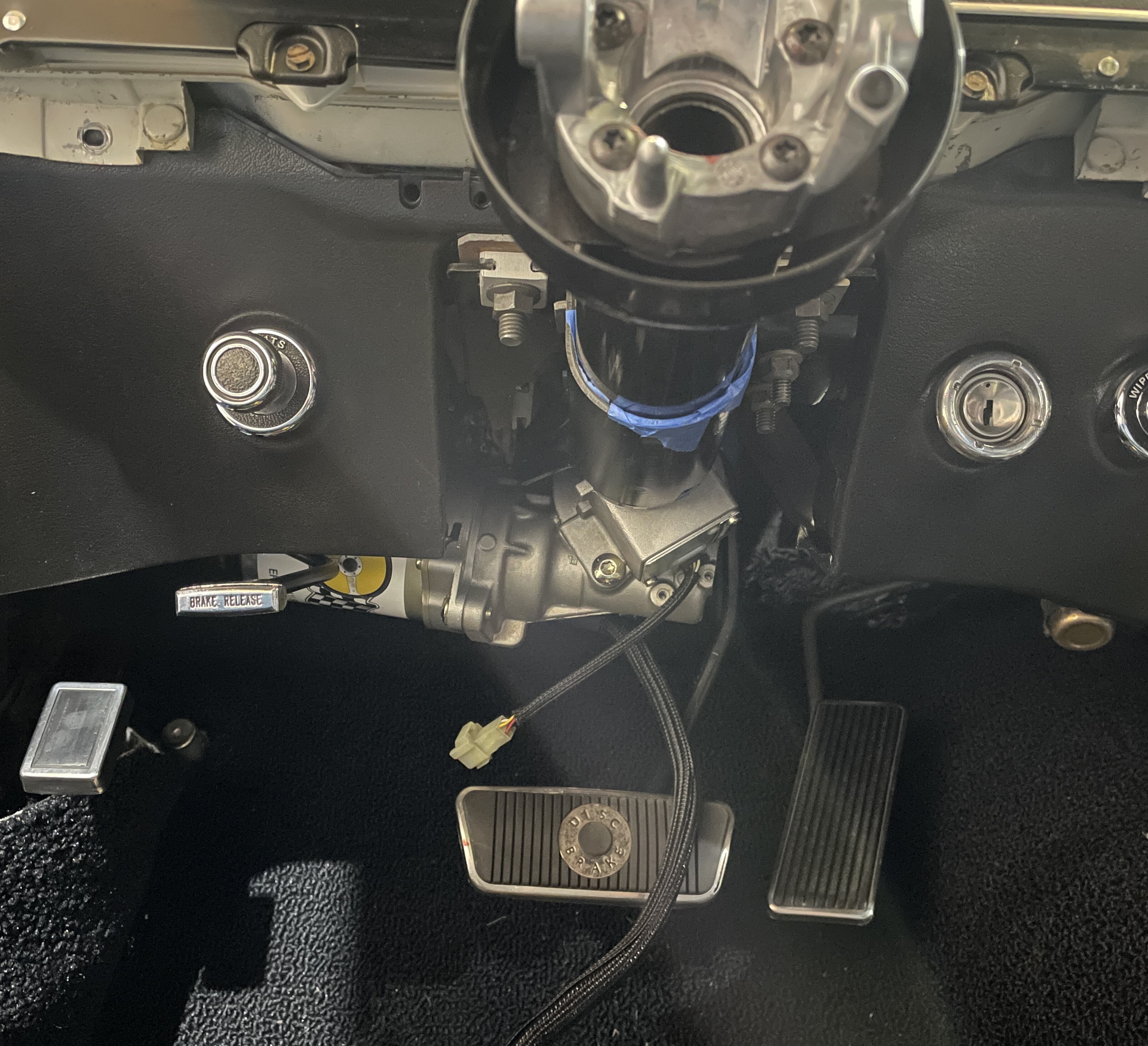

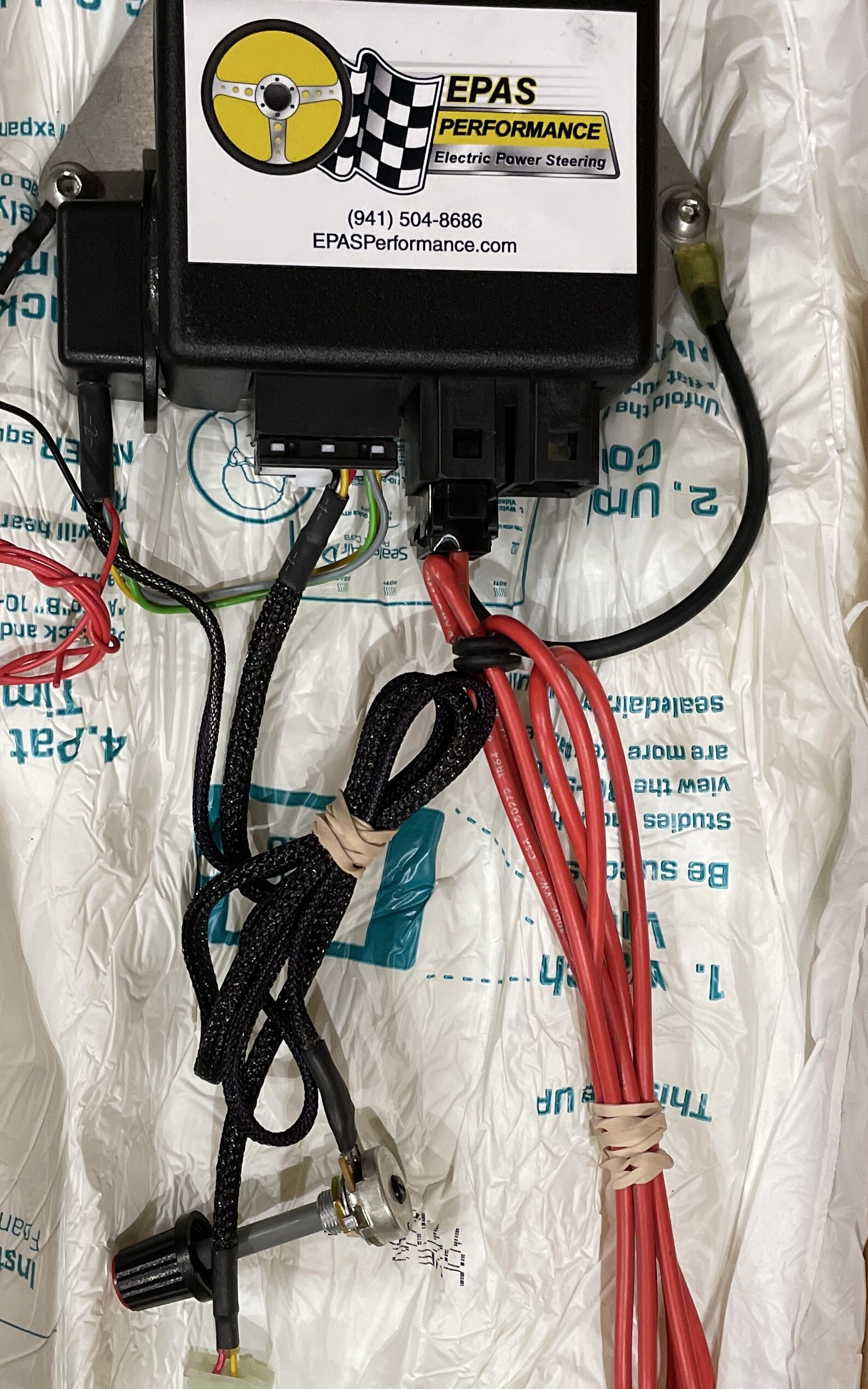

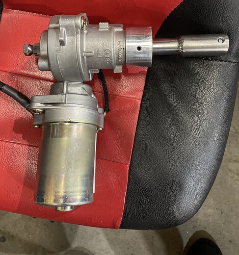

I went with an electric steering option and have liked it so far. Its nice being able to adjust the level of assist as desired.
Would love to see some photos of your setup.
