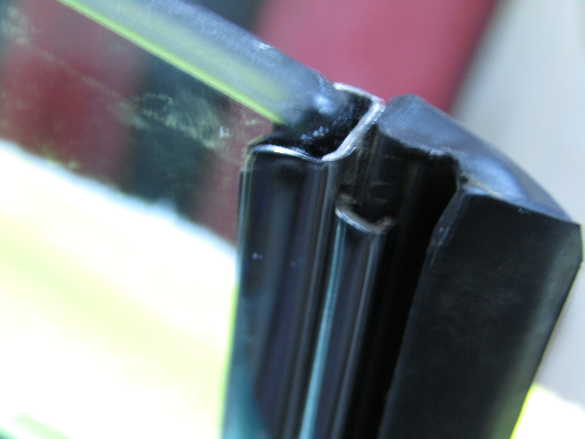

I am not sure if the factory used any kind of adhesive to hold the weatherstrip retainer onto the glass or not. I do know that I have found more than one of them laying in the bottom of the door as they just fell off on their own. I will offer a word of caution though if you try to tap it off or on to a piece of glass. This retainer is actually two separate pieces of metal that are spot welded together.and I have seen more than one of them come apart. Tapping on this trim piece my cause it to break apart. So be very careful if you try it.
The factory did use a adhesive. Ive used 3M channel bond.

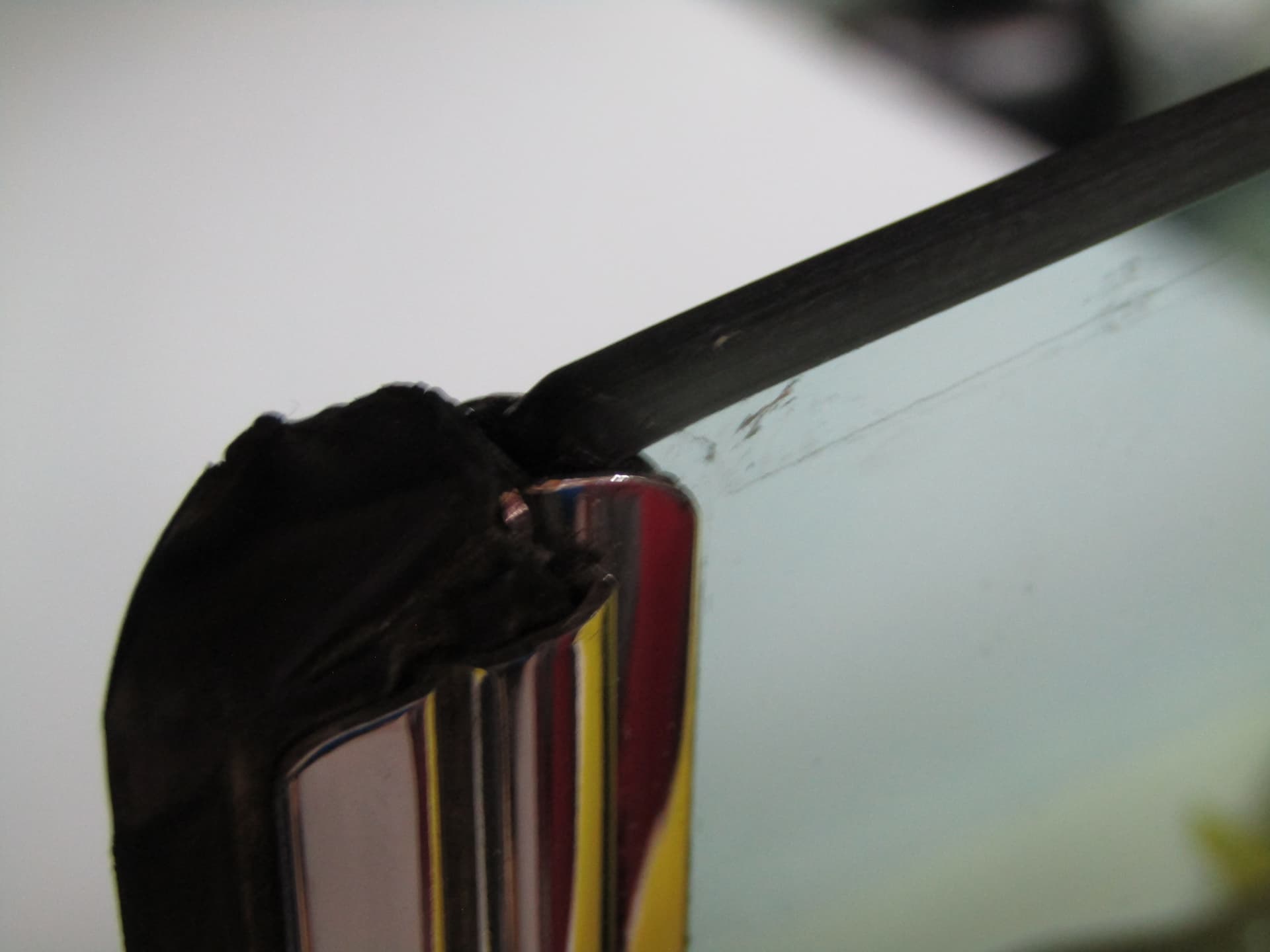

Tip. The top of the piece(s) have a piece of metal bent over. It becomes a snag of your clothes or skin. I remove the tab (if not already gone) then file or grind a radius so it no can no longer catch anything. Carefully put the trim onto the glass. It will fit tight. Use a rubber mallet to tap it onto the glass. Tape overnite to let adhesive set
