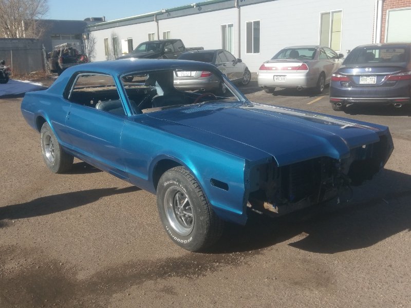

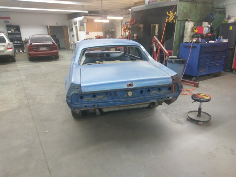

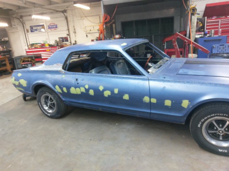

Pics from body shop:

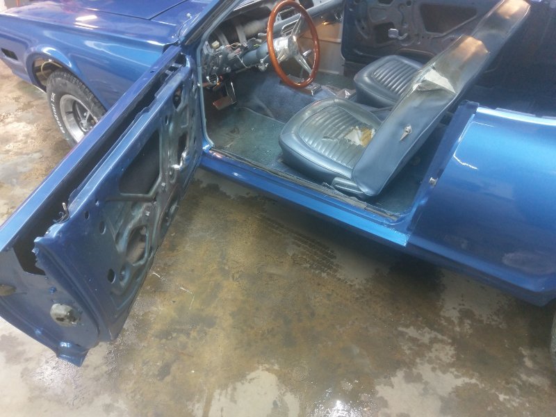

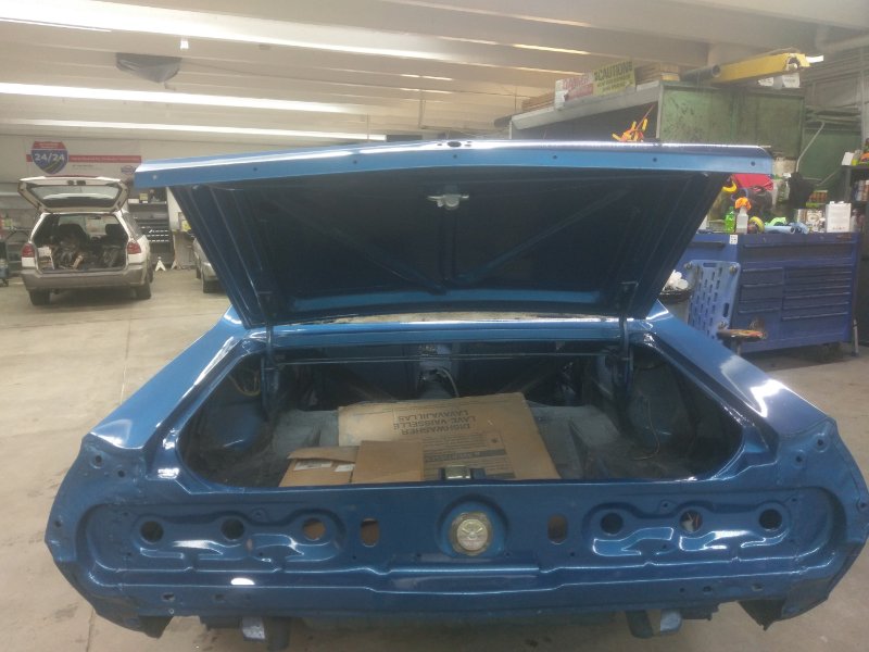

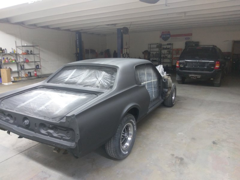

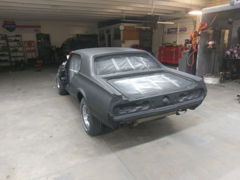

More pics:

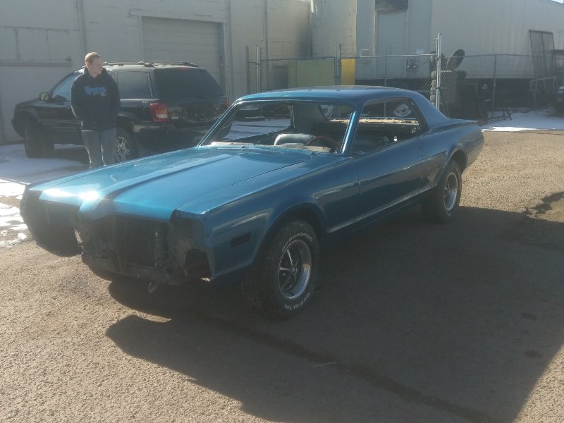

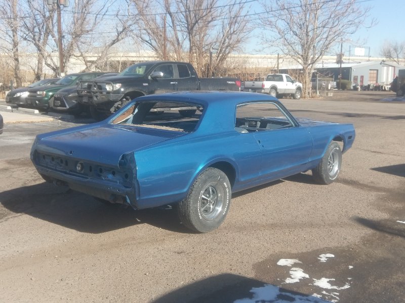

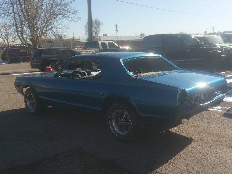

a few more:

Nice!!
