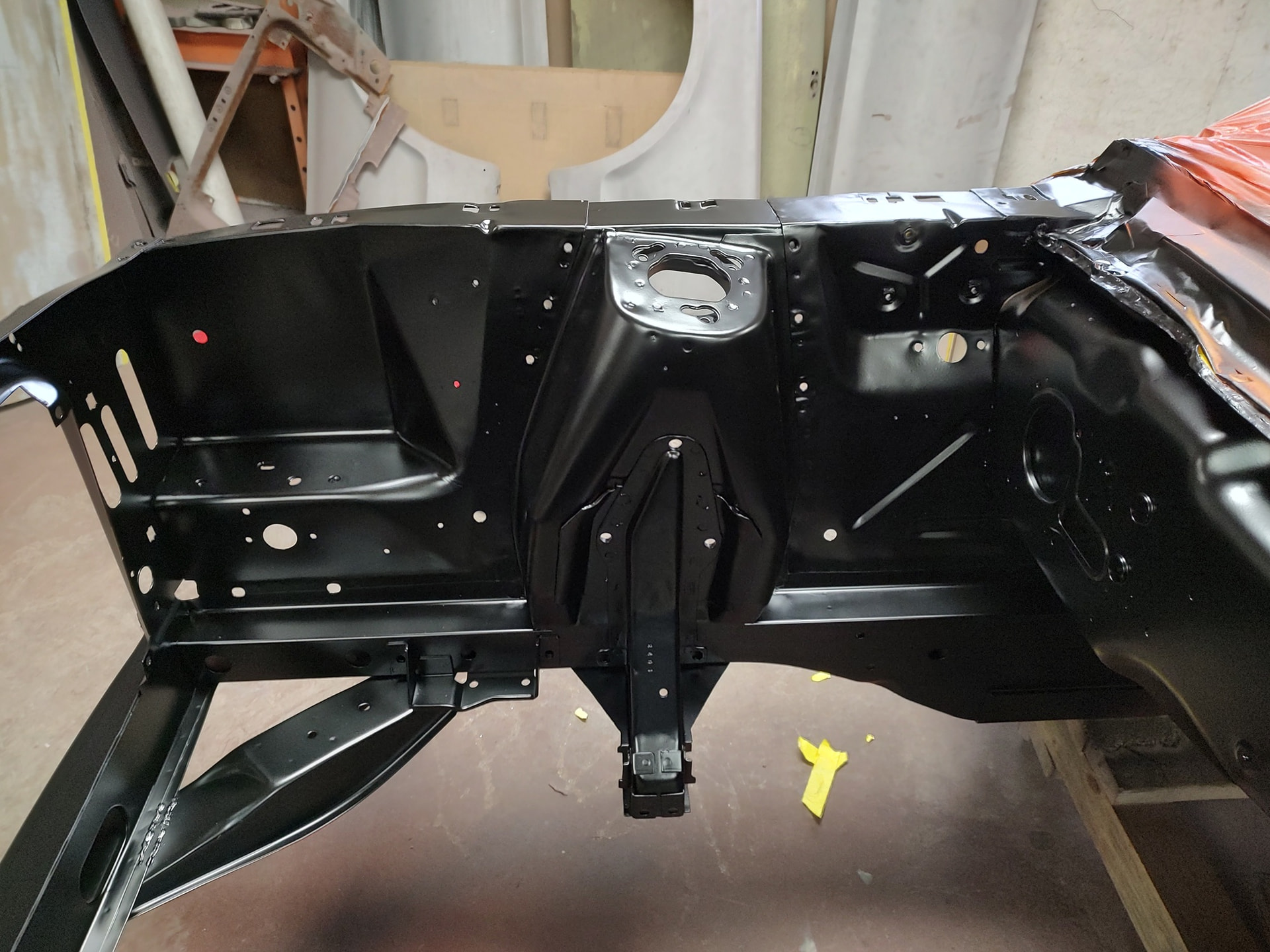

I’m a big fan of SEMS Hotrod Black these days. The sheen in this picture is fairly accurate. Definitely less than a quart to the front of my 68.
Is that one or two coats? Nevermind that question. Pulled up the TDS sheet on the SEM website, and it states two medium wet coats.
Actually it is 3 coats over SPI Red Oxide primer for the authentic factory look.

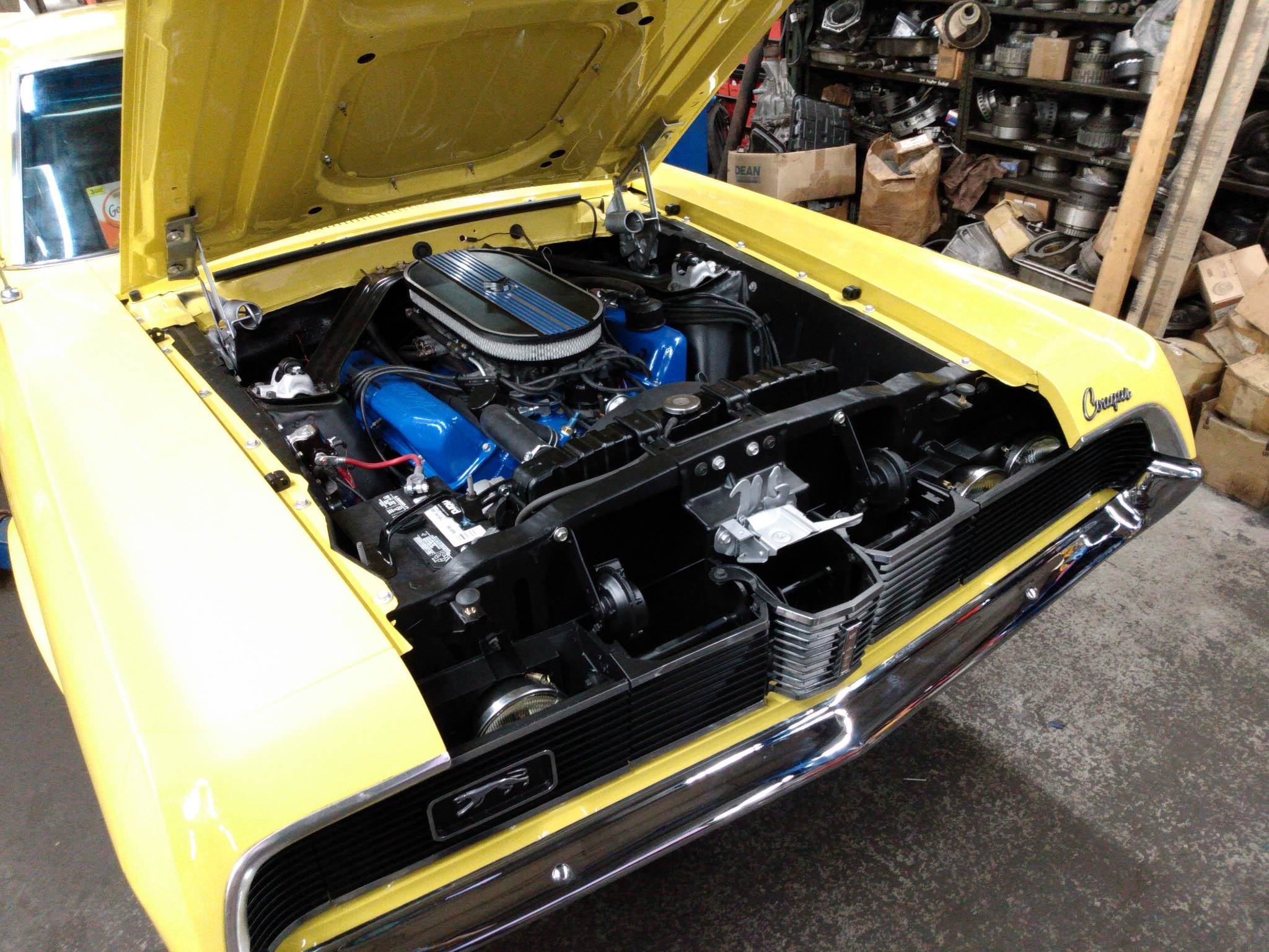

Man I love those oval air cleaners!!!
Thanks! It works good to cover both 4 barrels. This Elim was at Carlisle…..I think it was in one of your videos.
