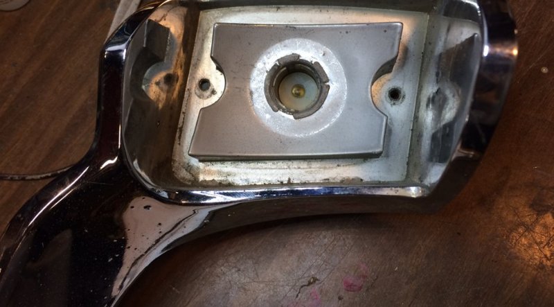

Does anyone know how to remove the bulb socket from this backup light? I need to send it out for chroming…
https://classiccougarcommunity.com/forum/download/file.php?mode=view&id=7849
Very carefully pry up the flange (which as you can see is irregular) all around with a sharp flat blade screwdriver or your tool of choice. Surprisingly, the flange did not break off when I did this and I was able to re-flatten them down in the rechromed housings when I put them back together.

Thanks for the answer…!
Gonna have the bumpers done and want to see if they’ll throw these lights in too.
